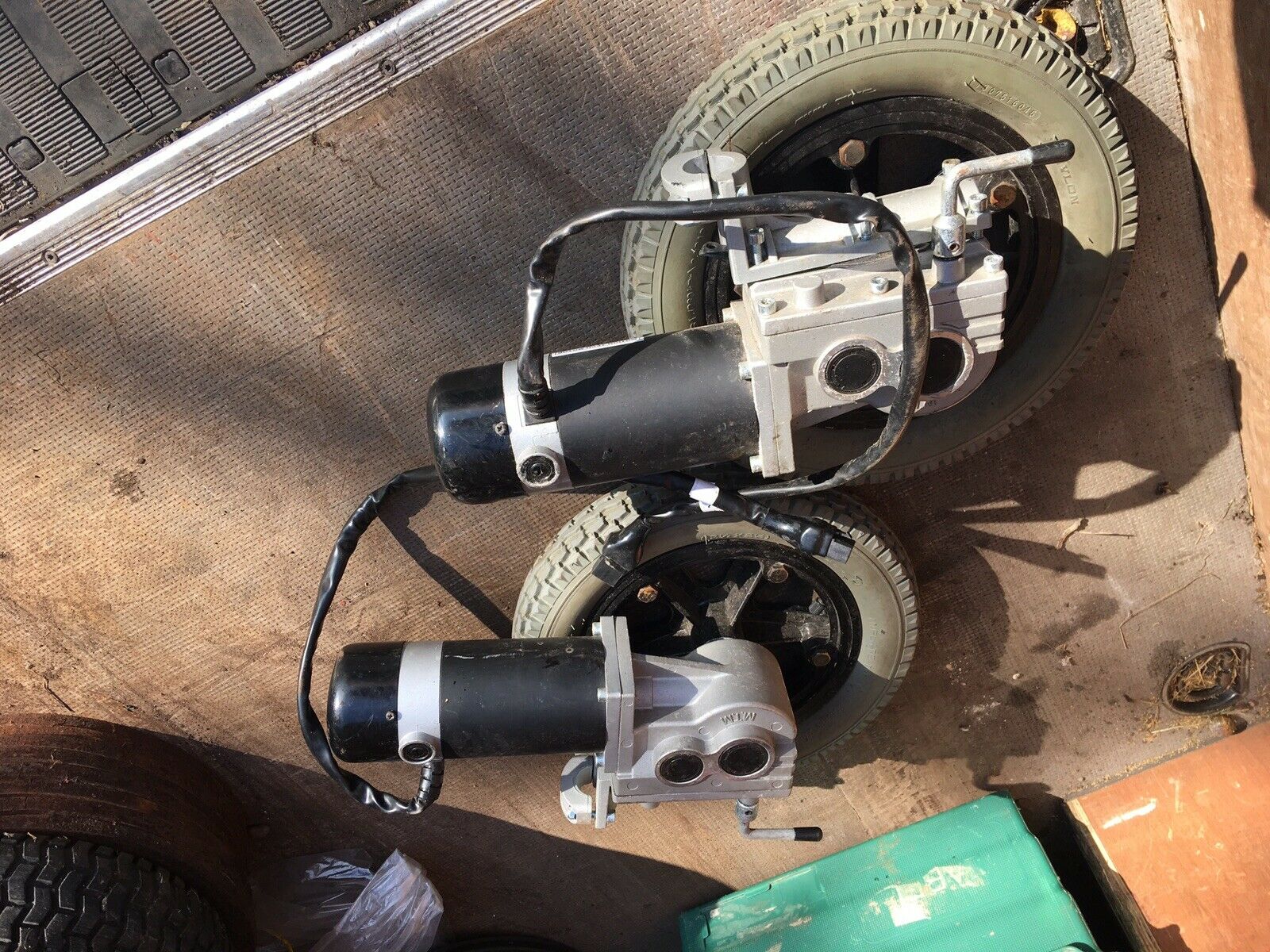

    Hello guys. What are you thinking about those motors? You can find very cheap motors.
    Thanks!

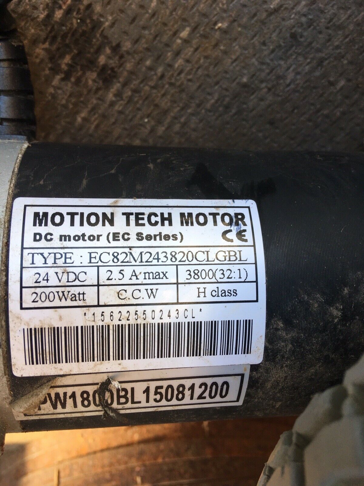

    So guys can u help me with the choice. I am planning to build 2dof sim.
    I have 2 offers for wheel chair motors and wiper motors from Nissan Vanette.
    Thank you in advance!

    I am using exactly the wheelchair motors shown in the first photo for my 2DOF simulator, and they work just great. I can fully recommend them.

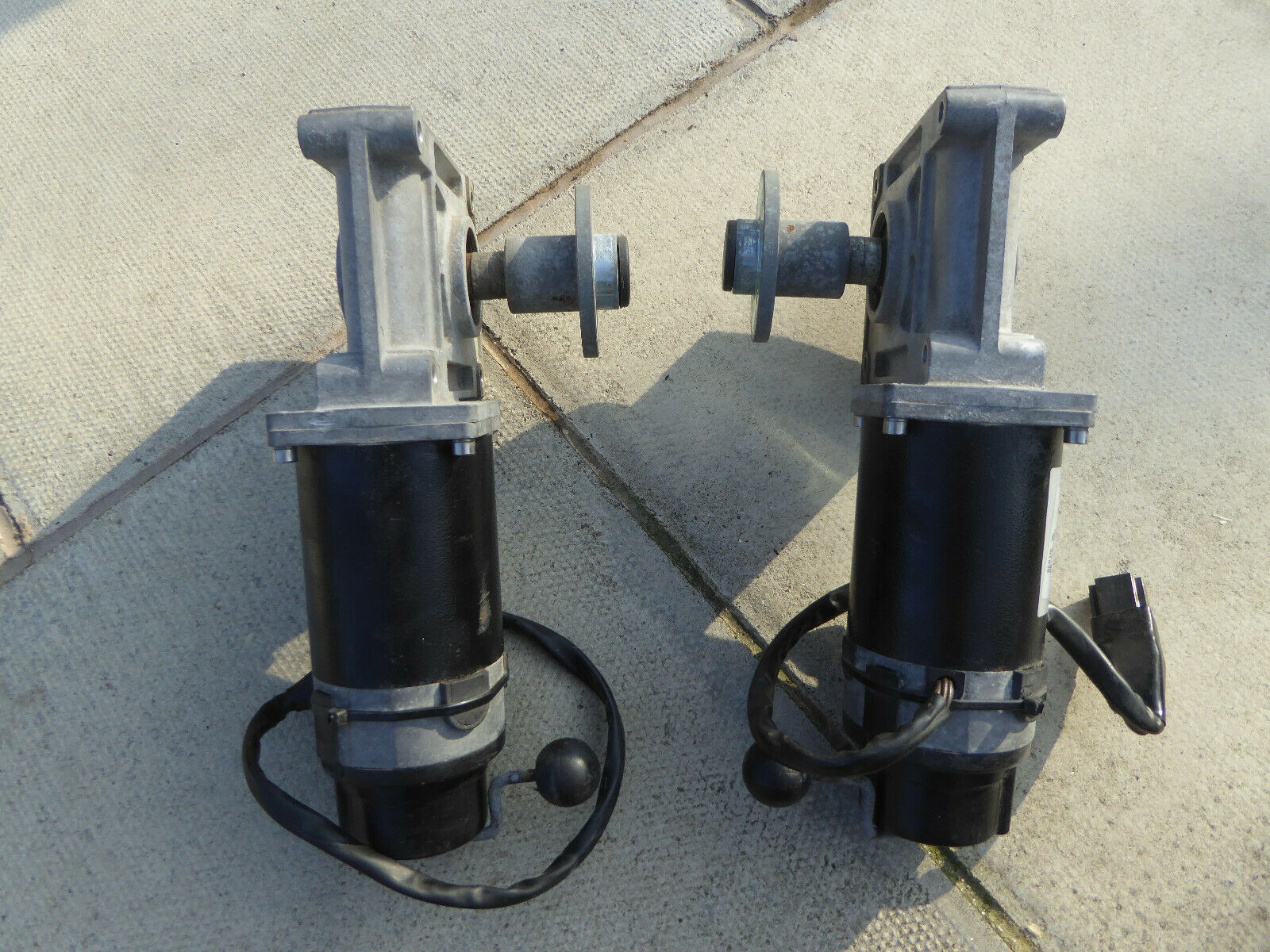

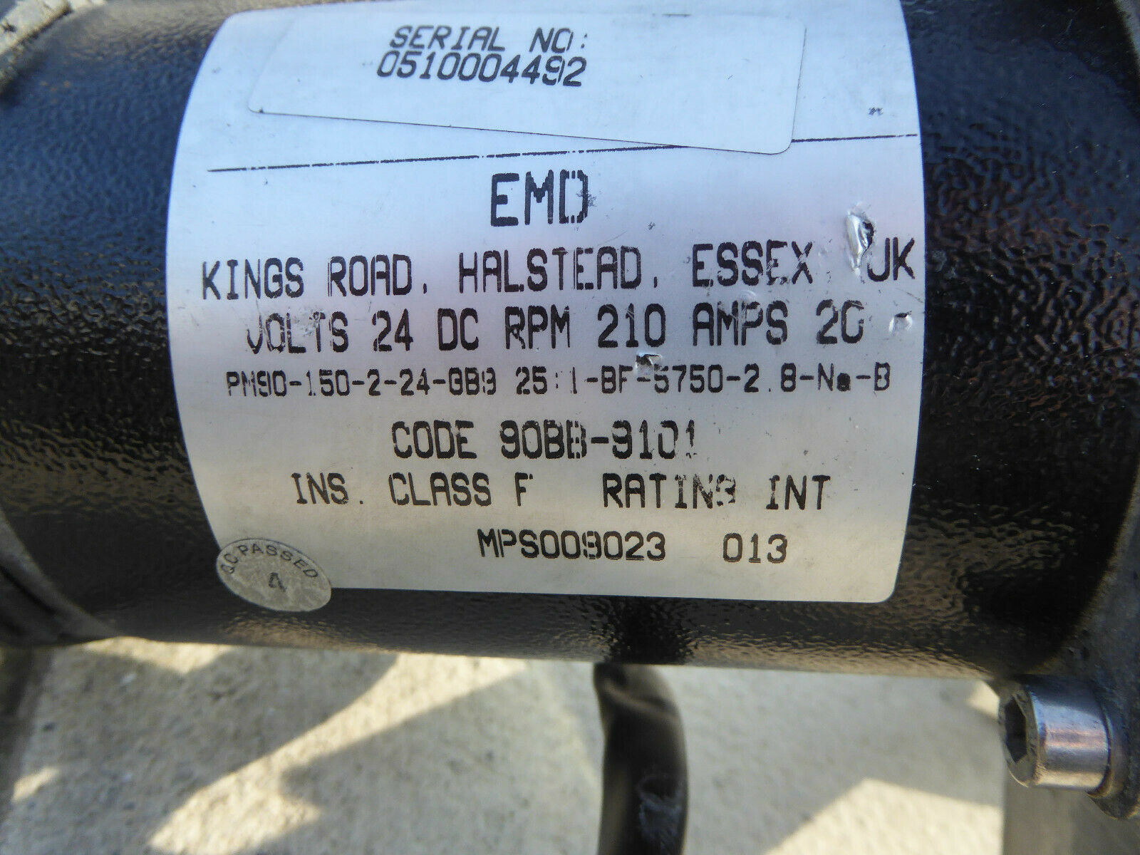

    So guys I have ordered already the motors for 50.00 pounds p&p!
    I hope they will does the job! How do u think?
    24 VDC
    RPM 210
    Gear ratio 25:1
    20 A
  14. MarkusB
    Jun 30, 2015
    552
    4,213Coins
    +597 / 2 / -0
    The motors look good and are for sure strong enough. The rear part with the little lever is the brake. I removed these brakes from my motors. Did not need them, and in this way they become a bit shorter.
