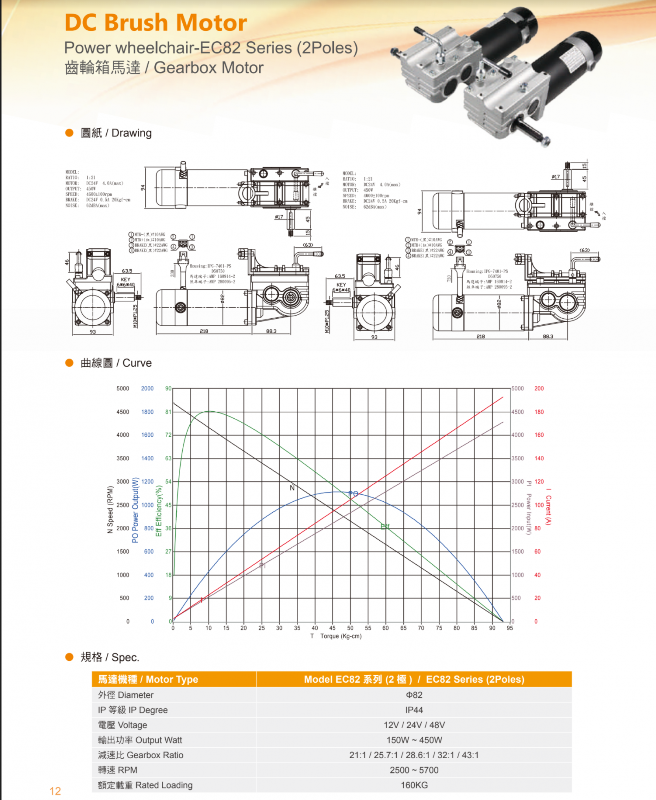

    Hello ,
    I'm starting a 2dof project like https://www.xsimulator.net/community/threads/my-project-2dof.13425/
    I can get these wheelchairmotors for 30 euro (and can buy 12 of them)
    but are they strong enough ? it's only 200Watt
    The seller doesn't know the ratio so rpm and has no insghts on the torque.
    any help is welcome.

    No I don't know the gear ratio,
    This is the only info i found fron the manufactrurer's website 2021-10-12.png

    Thanks for the quick reply noorbeast.
    It looks like they could work . but need to buy all 12 motors to get the price.
    I think I'll go for it .
