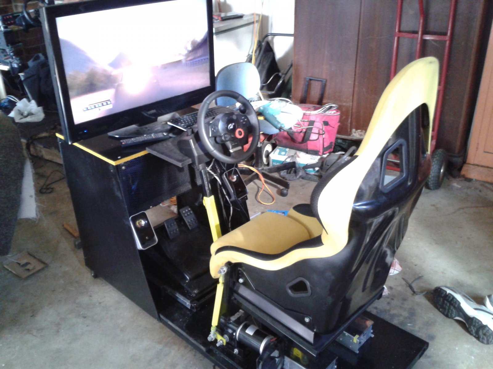

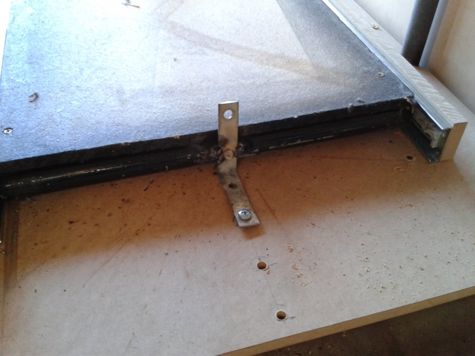

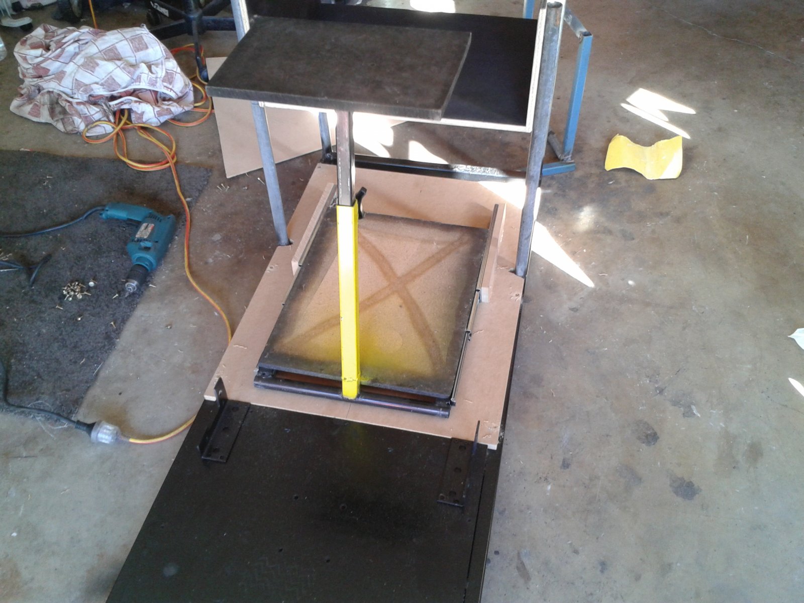

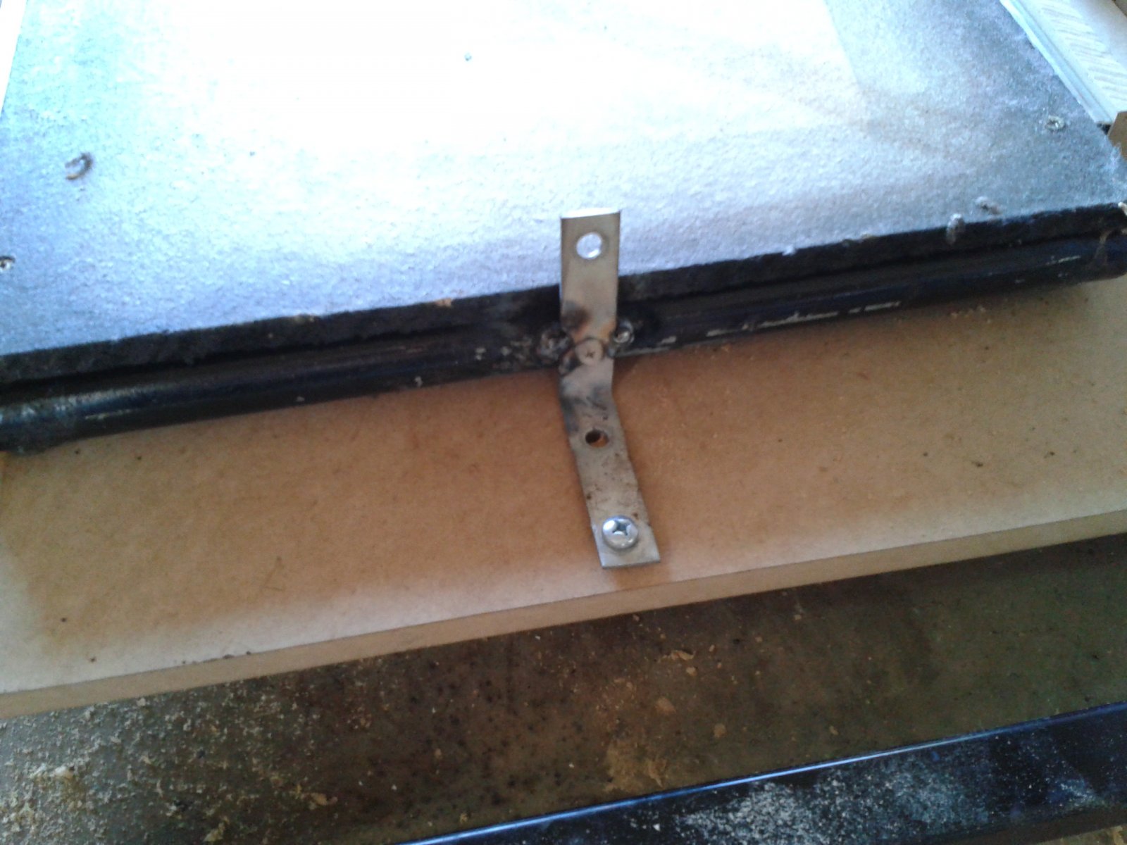

    Heres what I did for the desk racer conversion, obviously seat moves and the rest stays still
    thanks to @eaorobbie and his suggestion of draw rails
    I made up a frame on a MDF base and screwed the wheel stand to it so it slides back and forth and has a single bolt to hold it into place. I drilled several holes for adjustment
    Wheel stand wheel part is height adjustable
    2014-07-11 13.41.48.jpg 2014-07-11 13.49.40.jpg 2014-07-11 14.38.46.jpg 2014-07-11 14.38.59.jpg 2014-07-17 14.48.03.jpg
