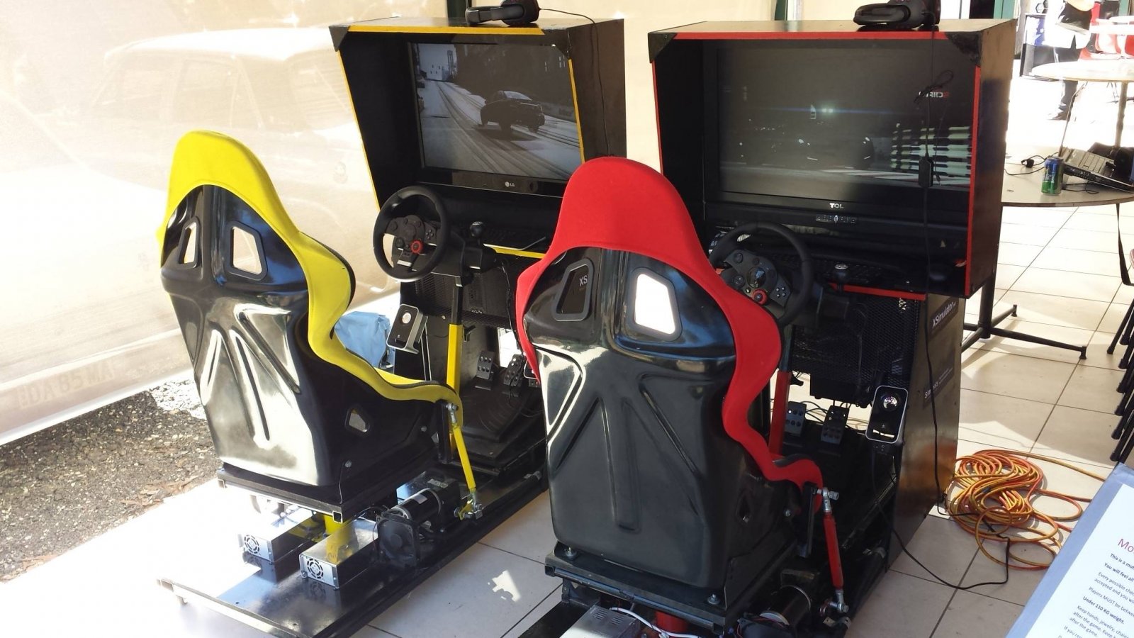

    @f1iceman , heres some info
    Heres what I came up with, didnt record lap times. No frame made made me faster or slower, so times were about the same.
    Comparisons between simulators. Other people will of course differ with this comparison, so please add your thoughts.
    First things to consider, angle of actual swing of the frames and the profile written. Also, its a brain trick.
    If you want a big swinging frame, go hard, the biggest swing I have had is 14 deg total, but others have frames up to 25 deg. And thats for race, not just flight.
    Both frames use same motors and JRK control boards
    Seat mover with shoulder mounted motors.
    Generally, a seat mover can give more precise motion detail as it has less over all weight to move than a full frame. However, too much movement can make it hard to hang onto the wheel or mash the juice pedal. And yes, the wheel and pedals are stationary, so proper placement to allow you being pulled away and pushed around has to be taken into consideration. But as said, it does give you the feeling of being moved around in a seat in a vehicle, even with a race seat to hold you in more. You tend to shift your body around to compensate for movement and also what your brain thinks you are moving like. You can still feel pitch and roll of track, but maybe a bit less as legs are still.
    Some SCN seat movers on videos have HEAPS of throw. It might look like fun, but can be too much and eventually make it tiring to drive the game.
    As mine is DIY and has 70mm travel of motor lever and at 600mm from the pivot , total angle is 6.5 degrees. Not much, but then again, too much may make it too hard. Other people will of course differ with this comparison.
    I had a seat mover of 12.5 degrees at one stage, so with a good profile, it was nice, but a harsh profile and WHOA! Fun but hard to hang on.
    Full frame with motors mounted near feet
    Full frames allow you , wheel and pedals to move with you. You dont really get sensation of being pulled, pushed around from pedals and wheels. Obviously not as much as a seat mover, but still there. You tend to feel a bit more of the motion of roll and pitch , when your whole body is getting moved around, I find.
    Seat mover can lose this a bit, but not really much.
    Motors mounted at feet on the frame in question, may take away some of the finer vibration and motion that shoulder mount gives, but then again, shoulder mounting motors would return that finer detail due to higher leveage point. It may lessen a bit due to the fact that a full frame requires a bit more power to move. But hey, just change the profile and increase the motor power a bit more.
    Although, I must say, once again, a good profile can give the same sensation in motion, be it from a different spot. Feet or knees instead of shoulders.
    Full frame is about 8 deg total swing. May not sound like much considering 4 deg from centre, but again, throw a decent profile in it and you feel like you are moving a lot more.
    Summary
    After a while I get the same sort of feeling from both my frames, even though they are different in design.
    In your choice of motion sim build, It will come down to watching videos of other frames, opportunity to play on sims when they are around to do so. Taking a look at pics, seeing what takes your fancy. Heck, even a seat mover can be converted to full frame later, add the extra bit, move pivot, and off you go. 2 seat movers I have sold, the owners have since converted them to full frames, their choice of course. They enjoy both frames they tell me.
    I have played on dbox, and scn simulators and the motion is set tame. Although others whom have such rigs wind it up and get great results. Mind you, I dont have that sort of money to get one.
    I have been through 14 different 2DOF designs, starting with joyrider design with about 9-10 deg total swing with screen on it. Good fun, but I found it a bit difficult to focus on a screen moving with you. But thats just me.
    I had 2 hire sims based on the Desk Racer for a while and over 100 players though they were immersive.
    8 professional drivers have played on those simulators as well, and they admit, its not real, but the immersion of being in game is.
    Then I moved onto development of more compact designs, with motors under rear, at knees, out the side, shoulder mount, at feet. Still 2DOF. Screen static.
    So thats how I go here. Each frame design is a new learn to drive experience I find. Nothing makes me go faster I think. I am slow regardless.
    I may have missed something and please add your thoughts as well. Its always good to compare notes.

  10. bsft
    @f1iceman , please take note of the driver in the bottom right hand corner of the video.
    a seat mover is for attempting to replicate that
    Also remember, a simulator is a toy for improving gameplay, its an immersion trick. Granted you may not get the same motion, but if you are going to build a motion sim, and use it, you may find it difficult to go back to static wheel and pedals. It adds to enjoyment of gameplay. 100's of people can verify that when I had my 2 hire sims
    Ive outlined my experience in the post above with the comparison.
