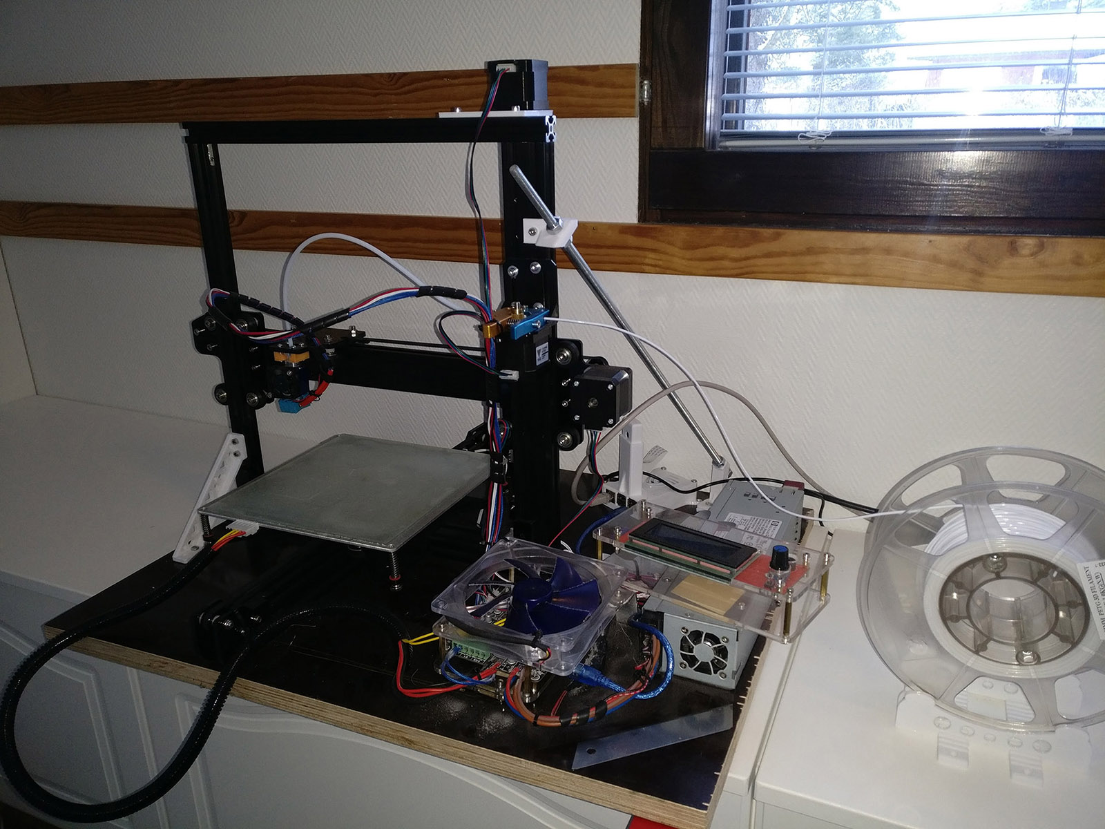

    Tevo Tarantula with some modifications:
    Genuine E3D V6 hotend, old server psu from my sim, glass on top of heatbed, Octoprint with camera (Raspberry Pi can be seen behind psu) and some printed supports here and there.
    Pretty good value for the money, but I'm mostly printing quite large parts and have issues with warping using PETG filament. I've tried different bed adhesions and haven't found the optimal solution yet. If I secure the print with 100% PVA glue it will stick but is a pita to remove. Especially because I can't remove the glass easily... Should have made it removable if I knew. I thought warping was ABS issue only.
    Maybe I should try ABS with some kind of casing for the printer or still different brands of PETG. Sucks when you see the prints starting to warp only after 5 hours or so. For adhesion I have tried hair spray and glue stick, and currently use diluted PVA glue. Small designs and some kind of large designs don't warp at all. :rolleyes:
    I also bought 0.6mm nozzle for the hotend to speed up big prints, but the stock extruder can't really keep up so better use 0.4mm nozzle for everything.

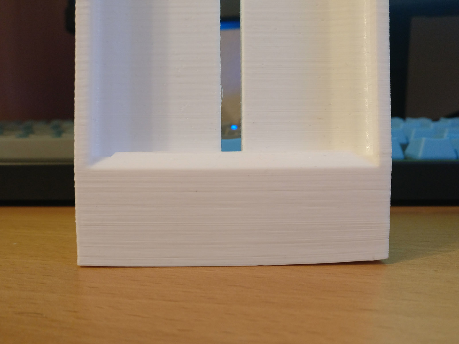

    No, after I opened the roll I printed around 200 gram part and it warped. The petg filament brand is esun. Here's an example. First layer starts fine and all but then it starts to warp after 30 layers or so. The Z isn't perfect either...

    Used a few rolls of that on the wanhao glass bed. No issues to report TBH. The only time i have lifting like that is if 1. beds not level 2. extruder/bed temp not hot enough.
    On glass i was priting esun at 250 with 85-90 bed and purple glue stick.

    You could try a darker filament. Natural petg lifts easier than the black. I use fructis extreme hair spray on glass for everything. The only problems so far is with pure nylon. My hotend tops out at 280c which is a little cool for nylon.

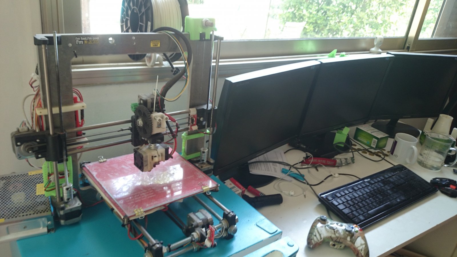

    here we are, i build my own printer 3d :)))) based on prusa i3

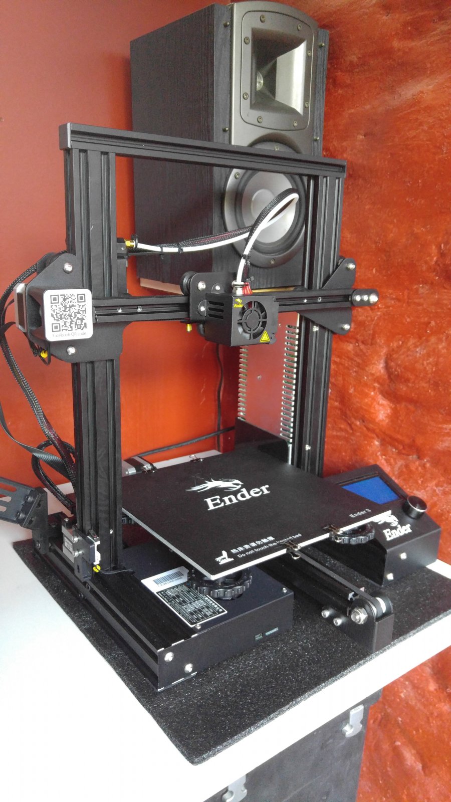

    Hey I got my first 3d printer! Creality Ender 3!
