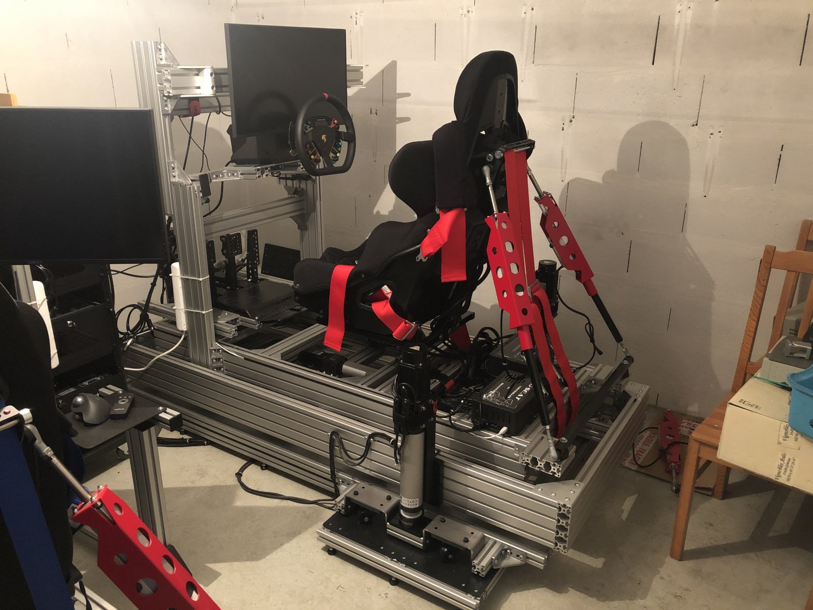

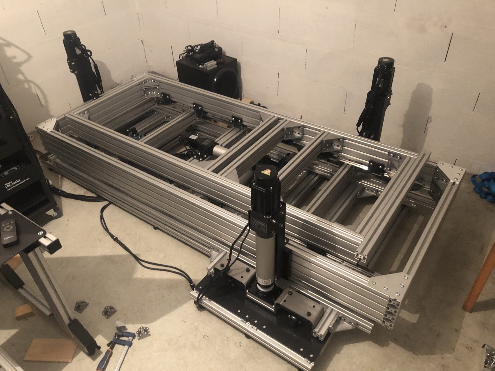

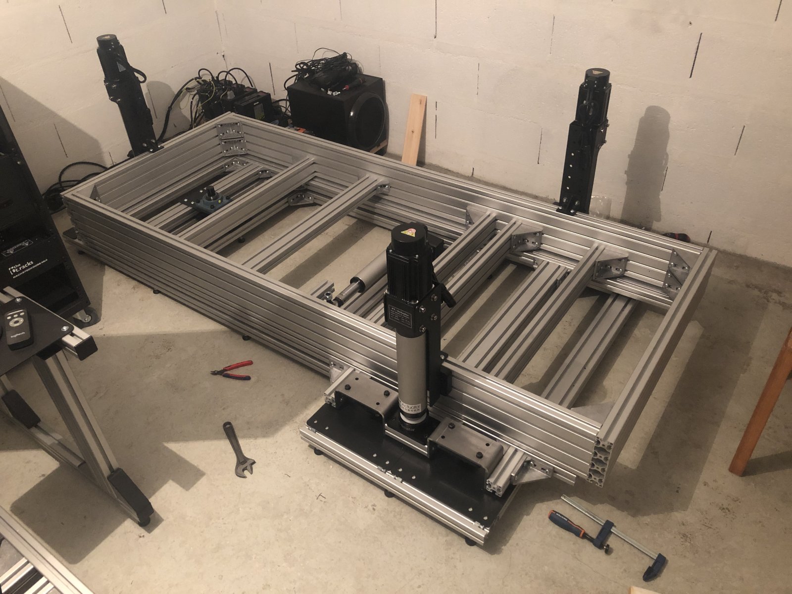

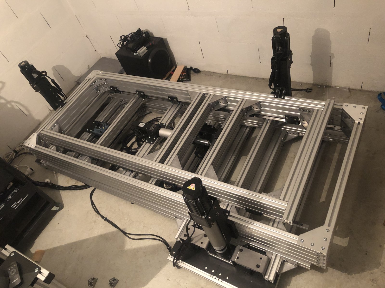

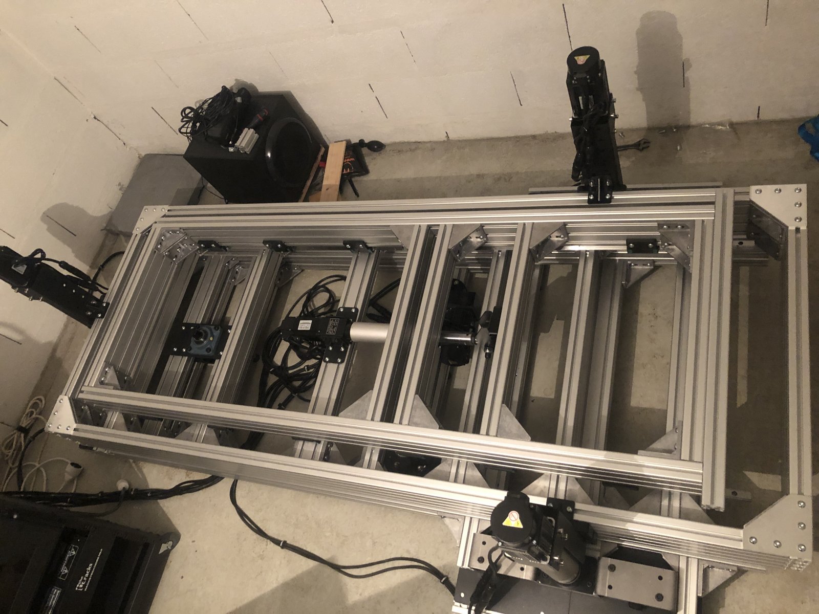

  18. alex928gt
    alex928gt Member
    May 2, 2020
    44
    409Coins
    Hi Thanos, noorbeast,
    Here are a few pictures (sorry no video yet). I'm still testing and need to mount the missing screens after designing a way to prevent them from moving too much when the rig is in action.
    A brief summary:
    - it's basically the same setup as Shao's 3DOF+TL+Surge but with lower profile since I did not want to use a ladder to access my rig...
    - I used 3 Mega monster actuators (1 front and 2 rear) for the 3DOF, a foldback PT-actuator for TL (I wanted foldback type to make the structure less wide) and a standard baby PT-actuator for surge. The controller is Thanos' provided by Shao
    - The setup is completed by a SimXperience GS-5 seat and the G-Belt active tensioner should arrive tomorrow.
    - As you can see I also kept - as a first stage, to be tested and removed if not actually needed at the end of the day - my SimXperience 2DOF seat mover setup. The previous setup was "just" SimXperience 2DOF+TL + GS-5.
    Overall, as a summary, I'm just using a setup that is very close to Shao's and want to get the best possible feedback from the surge horizontal actuator. I don't want the setup that goes forward when braking (as Barry's due to his passive belt tensioner, since I'll have the G-Belt) but conversely I'd like the surge tray to go forward on acceleration but stop and re-center slowly when the acceleration stops, and the same on braking, backwards on braking but stop and re-center slowly when the braking stops.
    Currently, as per Simtools' standard output, the position of the horizontal actuator and therefore of the surge tray is directly linked to the surge acceleration.
    This means that when accelerating (acceleration>0) the tray goes forward fast (you want it so to actually feel it as an acceleration and not just a change in position) but when the acceleration stops (acceleration back to 0) the tray also gets back to center fast whereas you would like to just re-center slowly since just stopping the acceleration is not the same as actually having a negative acceleration. Likewise on braking. So ideally I would like the position of the tray to change rapidly only when the acceleration (surge) is getting away from 0 (i.e. actual acceleration or braking) but to get back to center slowly when the acceleration (surge) is just on its way back to 0 (i.e. just release of acceleration or braking). And this surge behavior should only occur for the horizontal surge actuator of course. You'll tell me that you would then miss something when the surge figure just remains stable (constant acceleration or braking) but that's where the GS-5 seat is instrumental in simulating maintained g-forces...
    Where this was probably a bit puzzling for noorbeast is that the standard current surge behavior of Simtools is roughly ok for the vertical actuators being used with surge force since the fast re-centering is consistent with the behavior of shock springs that pop back to their normal position as soon as you release throttle/brakes. It's only for the horizontal surge tray actuators that a different output mode (filter?) based on the surge force would be required.
    As a summary we would ideally need in my view:
    - a standard way of driving the vertical actuators from surge whereby the position of the actuator would be directly linked to the surge signal (current Simtools' approach)
    - a variant of the surge output (a specific filter to be implemented?) - meant to drive horizontal surge tray actuators - and whereby the active change in the actuator's position would only be driven by surge figure getting away from 0 and the actuator would just re-center when the surge figure would be on its way back to 0.
    - mixing both approaches would not be an issue since the vertical axes would be fed by the standard surge force with no filter applied, while the horizontal surge axis would be fed with surge+specific horizontal filter
    Does this make sense? I'm surprised this point was not raised before considering all people getting horizontal surge trays on their rigs. But maybe most of them just use the tray the "wrong" way - or put more nicely - in a way that is indeed consistent with typical passive belt tensioning approaches (like Barry's) where the tray goes forward on braking so as to provide belt tension.
    Best
    Alex
