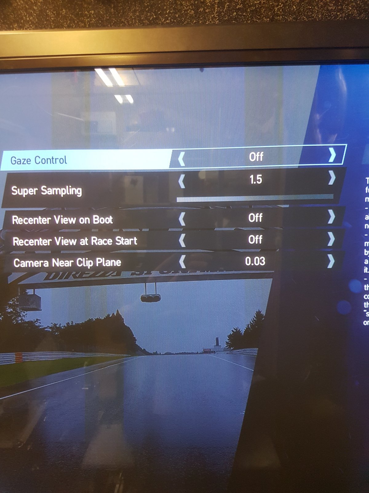

    what are your graphics settings for Project cars 2 VR.
    I have 1080 graphic card.
    Medium AA and 1.5x SS in SteamVR. Looks amazing. I don't use the in game SS slider as prefer to control that stuff universally through SteamVR.
  2. Javo5
    Javo5 Active Member
    Oct 10, 2014
    178
    Buenos Aires, Argentina
    300Coins
    +52 / 3 / -0
    Everything max , supersampling 1.5, i5 2500k @4.3 16 gb ram, GTX 970, some framedrops but bearable

    Is this in vr you can get max on all settings with a gtx970 ???
    seems abit high for that card. ?? i would say sturggle for low on al setting no ss.
    just curious what you have done for vr to get that out that card. :)

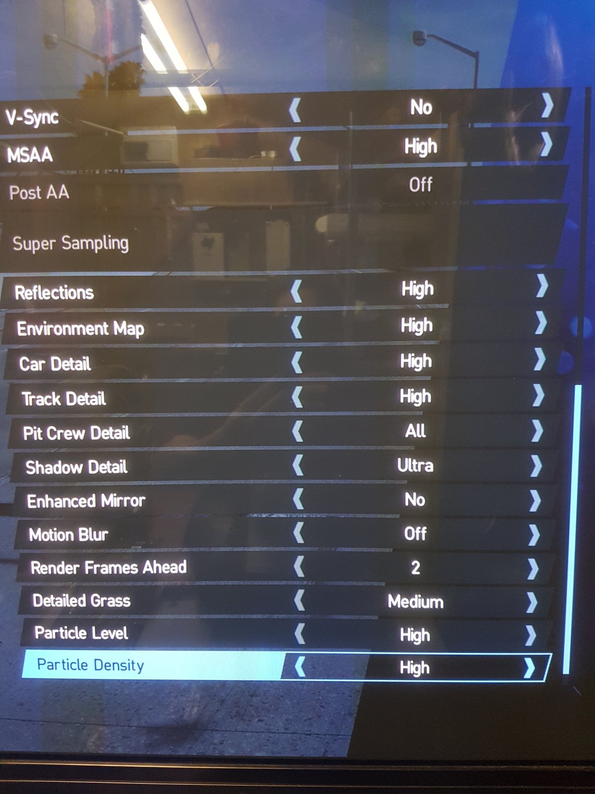

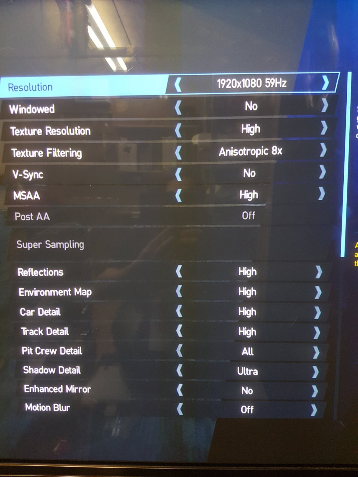

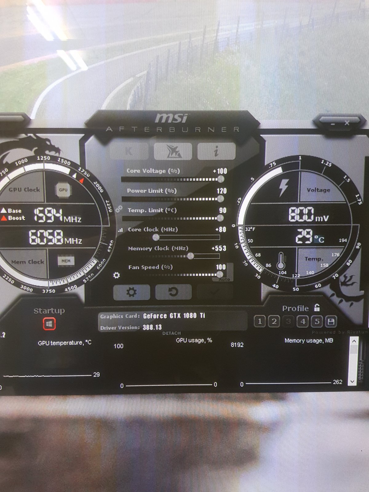

    Think i have found a break thru on projects cars 2 with vr graphics settings on my system ! lol
    System
    i7700k overclocked to 5.0ghz can goto 5.2ghz stable.
    32gb gskill trident 3200mhz
    Asus Posiden GTX1080 ti Overclocked (Afterburner)
    Solid 90fps VR (no drop outs either to 45 fps. ) awesome !!!!!!
    Oculus rift 1st realesed version SO OLD.
    I going to test as i have the lastest one too, as i swear it better than this older one.
    Only tested this track !! ( so far)
    Oulton Park.
    Porsche gt3
    25 Opponents
    Full Rain

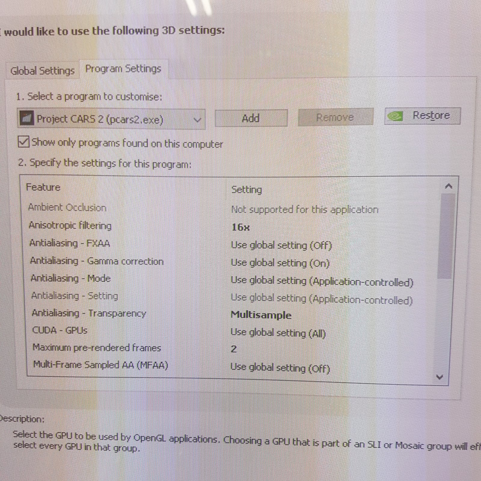

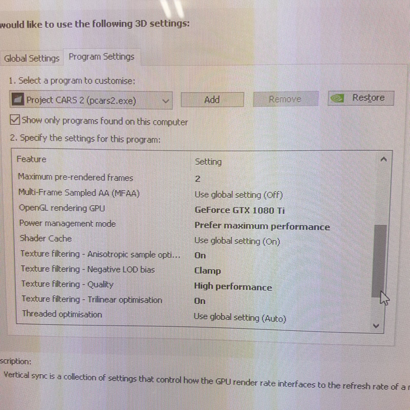

    please try these settings in nvidia control panel and tell me if you gain 20 fps like i did.
    i gained that and could run 1.5 ss in game just from that and was running 1.3 ss until i did.
    i alterd them and noticed i had gone from limit to plus +25 in gpu headroom.
    yes i was shocked !!!
    every thing apart from grass on high or ultra just about.
    i can run ultra in reflections/ texture filtering @x16 if i want but means i will get the odd 45fps pop up here n there at certain points in a race.
    my settings.
    Nvidia driver 388.13 i use atm.....
    i can over clock abit more than this b ut it is safe really and long game playing its better really.
    i hope somebody else can confirm this worked as could be quite usefull if it works for others in the nvidia settings. :)

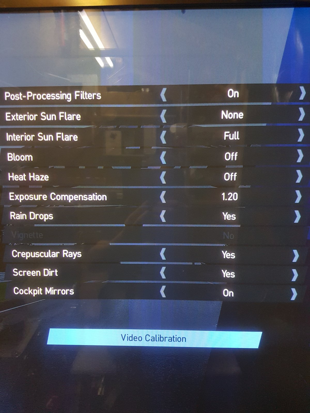

  13. f1iceman
    Aug 29, 2015
    850
    UK
    925Coins
    +396 / 2 / -0
    wow !
    25 cars still oulton park same as above but few graphic changes balanced out with all highs.
    did restart on pc as i have been doing with my new pc setup when i alter stuff.
    now running any snow or rain thunder at 90fps with high on all settings except ultra on desity.
    found i nice sweet spot for all the weathers.
    if i run 16x texture i get 45fps drops at start first corner and a few bits here n there.
    so dropped back to 8x and i can run what i have just said easily not slow downs to 45 fps at all.
    all still with 1.5 ss on.
    the racing is immense this now the best game ever in vr atm only messing with nfull rain n thunder and snow ect... but that alone is just immence and nothing i have seen can touch this, only issues i have is the cars have far too much grip in this weather i have been running i would say.

    just to give you an update on thoses settings really.
    i forgot to say you need to open debug tool on oculus and set it to 1 and enter.
    there seems to be a bug well for me in any case, what it does is you leave it on zero you loose fps big time like headroom goes -60 odd with ss in game set to 1.5.
    now set the oculus debug tool to 1 and enter and i then get 90fps with + and- of about 5 head room with the game set to ss1.5.
    so altering that 1 thing can kill it on its knees for me.
    also if i swop from ss 1.5 on oculus and set game to zero it has the same effect kills the fps to 45 and -60 odd headroom.
    so try to run it with 1 on debug tool and 1.5 in game big advatage for me.
    if anyone could test it aswell that would be great as i am on the older driver not the latest one so could be there, i just don't want to upset it atm too much, so sticking with this driver 388.13
