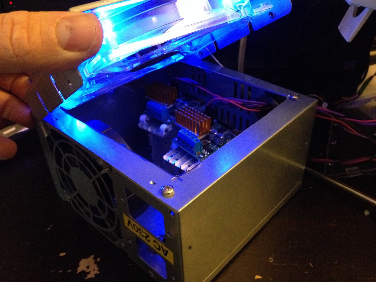

    Ok i write not clearly , i have put on a big chip the heatskin , this is the first time operation that i have made , but i built the box for the jrk only in a second moment with an old power supply case a big hole upon and a big 12 cm fun for cooling all, the distance to heatskin is 1,5-2 cm ...
    Last time i try only the fun was off.
    But ok in this days i try to set some u as suggested , ty again:thumbs
  2. bsft
    That setup should be fine, ive been running setups like that for 3 years.
    The JRK heats up very fast and MUST have fan cooling going or it thermally shuts down.
    If you have ever watched overclocking videos, a CPU at overload locks up in seconds when the heatsink /fan is taken off or the fan is turned off.
    Same thing with the JRK. Fan cool them constantly.

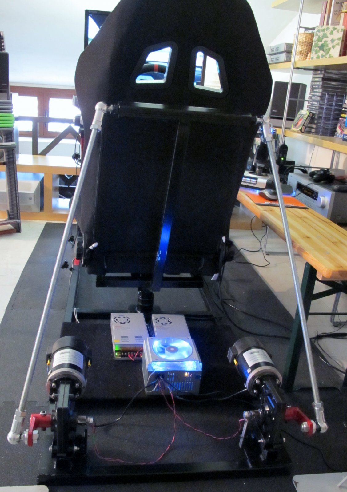

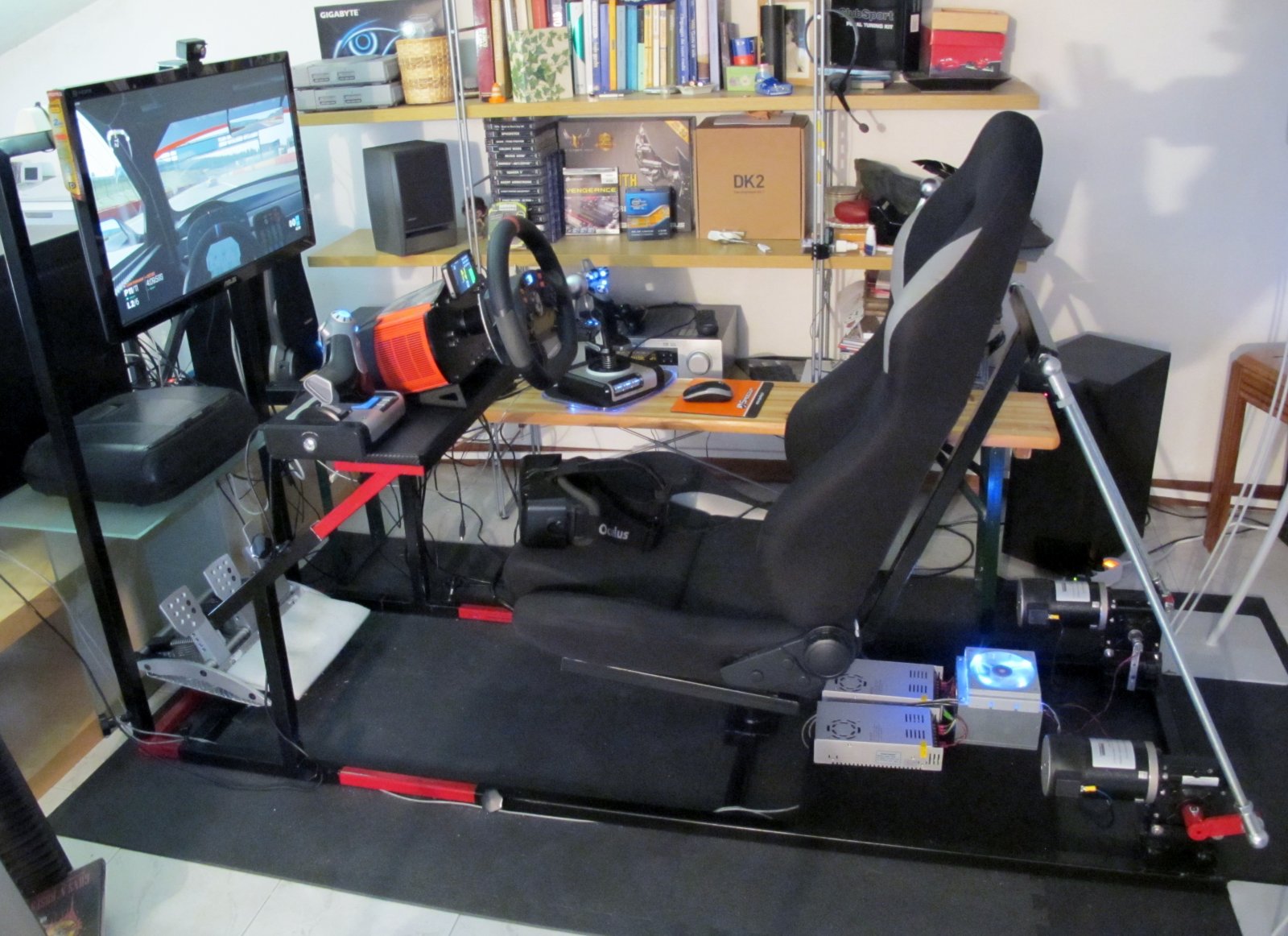

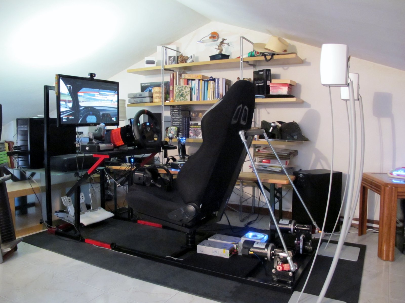

    Hi Guys, sorry for latitance but i ever say: tomorrow post a video, tomorrow post a video, tomorrow post a video and the time run.....
    ok there is non a god quality video, only show that all work , motor run well, a little slow but he make a good movement whit short excursion, in this video i have used PCARS on SPA with autopilot feature, really i not have make a very fine tuning for pcars, i use Assetto Corsa /Elitedangerous all time and here i have tunig all very fine, expecially AC. but this two not have an autopilot feature XD .
    Here a video in function
    this is my first motion work and i am satisfacted of result , should be better but in the future maybe......
    he have a little metal noise when in move, but if play at high volume there isn't a problem XD.
    HERE all picture of my work
    Thanks again for yours best support, expecially @bsft
  4. bsft
    you still didnt move the balance point.
  5. wDOCw
    wDOCw Member
    Sep 1, 2014
    35
    196Coins
    +29 / 0 / -0
    Oh yes, i have an slide seat, i tried many position and select the better.
    From what u can see think i need move forward or back?
  6. eaorobbie
    20,486Coins
    +1,687 / 23 / -2
    Pivot is not far enough forwards making the seat front heavy.
    Meaning the weight shift will be poor and motor may struggle or actual motion will not be as good as it could be.
    But really mate if you are happy and it feels good, leave it alone and enjoy.
    BTW NICE SIM , Top job indeed.

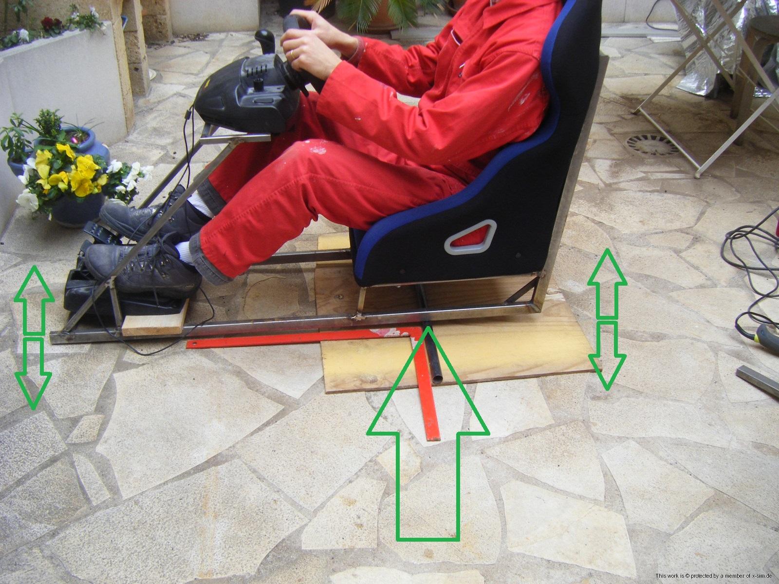

    But as well know , find the best tuning is never ending story.....
    I also have many other fix point to slide back the structure seat, i actually use the last hole, can try other solution... I have select this position because i think that if i move back my (ass) later need more power to push up seat, the lever are very distant to pivot and very small angle of the arms...
    http://i1377.photobucket.com/albums/ah65/WowDOCwoW/SIM WORK/IMG_4611_zps0e9a3f84.jpg
  8. bsft
    What you need to do is get rid of the rails and balance it properly. Get the top frame off, roll it on a piece of pipe, with you sitting on the frame and set the balance point right. Move the pivot to where it should be and I am going to take a guess it ends up about under your butt hole position under the seat. Dont move the whole structure back and forth as you will find motion is varied from teh motors arms angle being changed. Balance it right.
