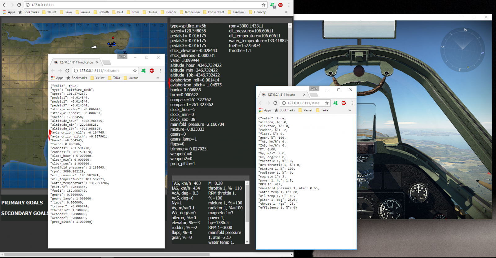

    The plugin provides Roll value relative to earth that you could use as banking. it does not take into account the g forces though, so if the plane is at 45 degree angle relative to earth and you pull on the stick back to do bank turn, the downward force felt by the pilot does not affect the Roll value. the Extra1 value is the Roll speed in degrees/second.
    If you can control your simulator with Simtools V2, this plugin will be able to move your sim.
    This plugin is using the values from the Dynamic battlemap thing that war thunder provides (open http://127.0.0.1:8111/ with web browser while the game is running). If there are some values that you can use, I can pretty easily add them to the plugin.

    Perfect! Just what i needed. Can you confirm that pitch is also +/- 180° ? Some times ago there was a max. pitch up +/-90° possible... exeeding 90°, caused a bank flip of -180°
  9. Ville Pesonen
    Ville Pesonen Active Member
    Jan 13, 2015
    136
    855Coins
    +200 / 0 / -0
    I don't remember how it is behaving at the moment. I think it is 90° degrees up and then the roll value will flip. You can check the behavior easily from the dynamic battle map (the values used for roll/pitch are aviahorizon_roll and aviahorizon_pitch) or you can look at the behavior from Simtools' tuning center.

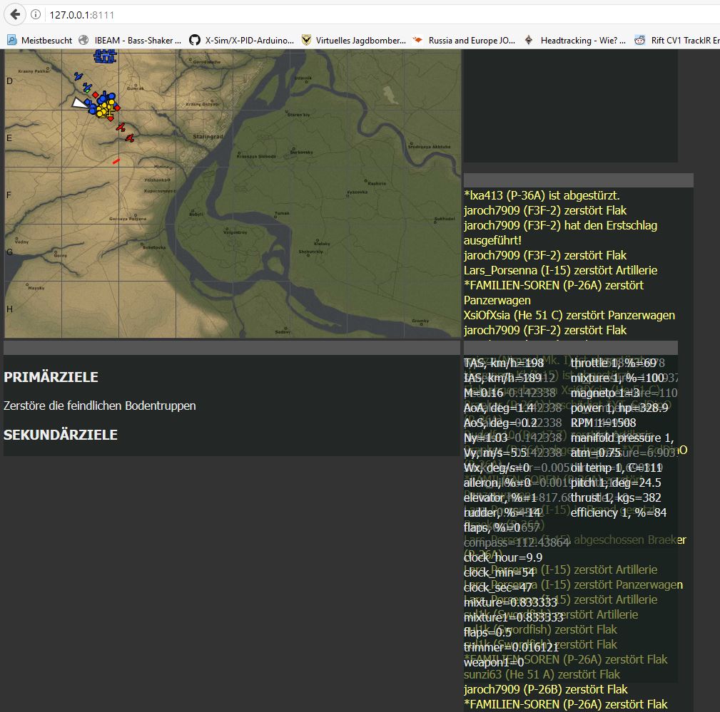

    Hmm, i watch the values in 127.0.0.1:8111 while flying around, but the only usefull one is pitch. But pitch didn´t change (allways 24.1). AOA does not work (relative value). And i didn´t found a bank or roll value.
    May i don´t see evere available value?
  13. Ville Pesonen
    Jan 13, 2015
    136
    855Coins
    +200 / 0 / -0
    The values used in the pitch/roll are named aviahorizon_roll and aviahorizon_pitch. the values are either in http://127.0.0.1:8111/state or http://127.0.0.1:8111/indicators. These urls don't update on their own like the dynamic battle map. the dynamic battle map shows the values from those two urls.

    I don´t get it...no aviahorizon_roll at all...i didn´t find it in state or indicators eather. Screenshot added

    You can move the windows inside your browser to make them visible. I think the values are hidden under all the other stuff in your screenshot:
    You can see the values at http://127.0.0.1:8111/state only when you're flying. The values will not show up there when you're in the menus.

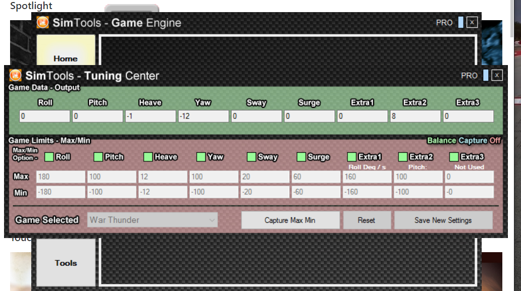

    2DOF, SCN6
    Hello, i have little troubles with this plugin, installed it normally but it seems that the game does send none - very little data to simtools:(
    It seems that the plugin is installed correctly,i tried it few times with no help.
    When i turn on the game the simtools goes blue and tuning center is able to do mods.. But still no movements..
    Images attached, any ideas, please?
  18. Ville Pesonen
    Jan 13, 2015
    136
    855Coins
    +200 / 0 / -0
    Does your computer have a firewall? If so, try to disable it for a moment and see if the plugin works.
