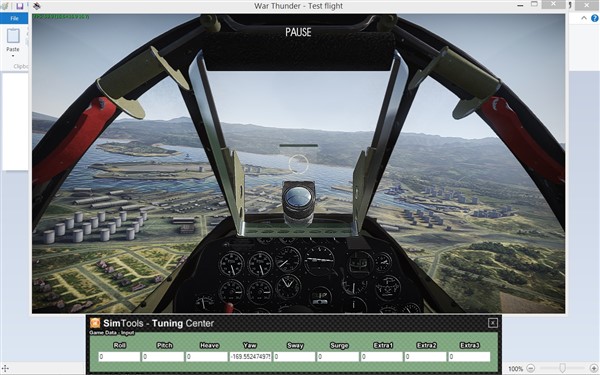

    I have Yaw output @value1, but nothing else. Anything I can do to fault test?

    Hi @noorbeast
    Did you run GameManager in admin mode while playing. GameManager needs to be in admin mode to catch the data.
  12. noorbeast
    21,592
    151,215Coins
    Yes @value1 GameManager is started in admin mode and I do have Yaw data, but nothing else.

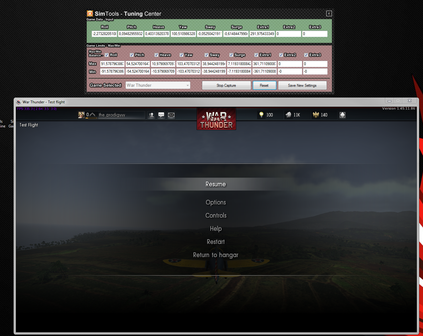

    @noorbeast
    I've just tried it, with latest version 1.45.11.86 and I got all the data and motion, used the Test Flight mode in game.
    EDIT:
    @value1
    Found the problem, it is in "Cockpit View" - There is only Yaw data in cockpit, in third person view is all other.
    IMHO, it would be better to have all data in Cockpit view, while it's more immersive and realistic view, rather than third person view.
    21,592
    151,215Coins
    Thanks @prodigy.
    I have to agree, while a lot of mouse users play War Thunder in third person view in cockpit is what suits simulation.
