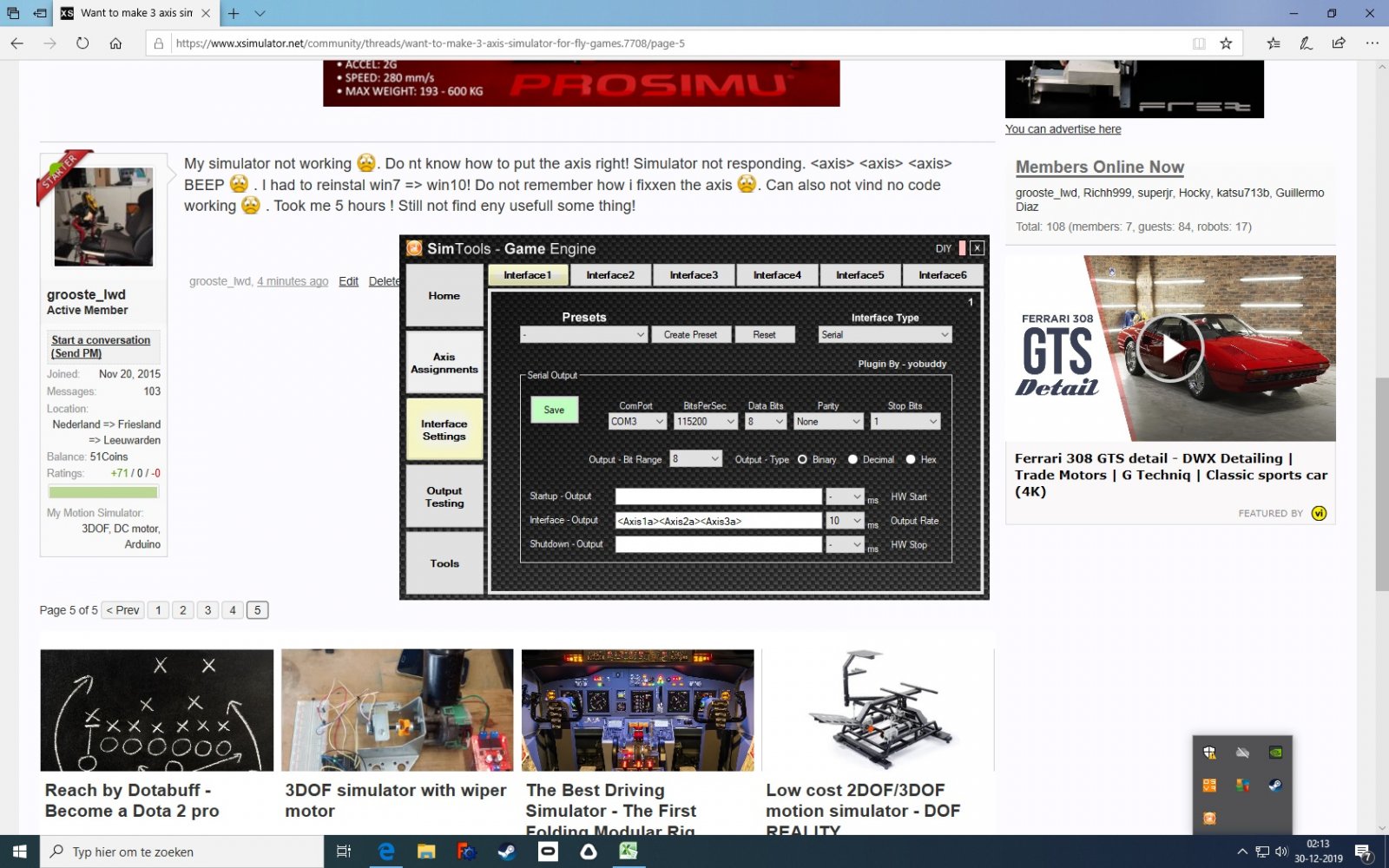

    My simulator not working :(. Do nt know how to put the axis right! Simulator not responding. <axis> <axis> <axis> BEEP :( . I had to reinstal win7 => win10! Do not remember how i fixxen the axis :(. Can also not vind no code working :( . Took me 5 hours ! Still not find eny usefull some thing!

    SMC3 Interface Settings for Simtools 2:
    [A<Axis1a>][B<Axis2a>][C<Axis3a>]
    Set for 10bit binary output
    Baud rate 500000 , N , 8 , 1 (10ms delay)

    Thnx :). --== Noordbeast FIX is good! Sim is moving again! Dirt compleet fails. Oculus, revive, osvr hdk2, is a money RIPPING. Nothing works :( enymore!! THNX microsoft!!!! Now i can do candy crush en skype !!!!!!!!!!!!!!!!!!!!!!!!

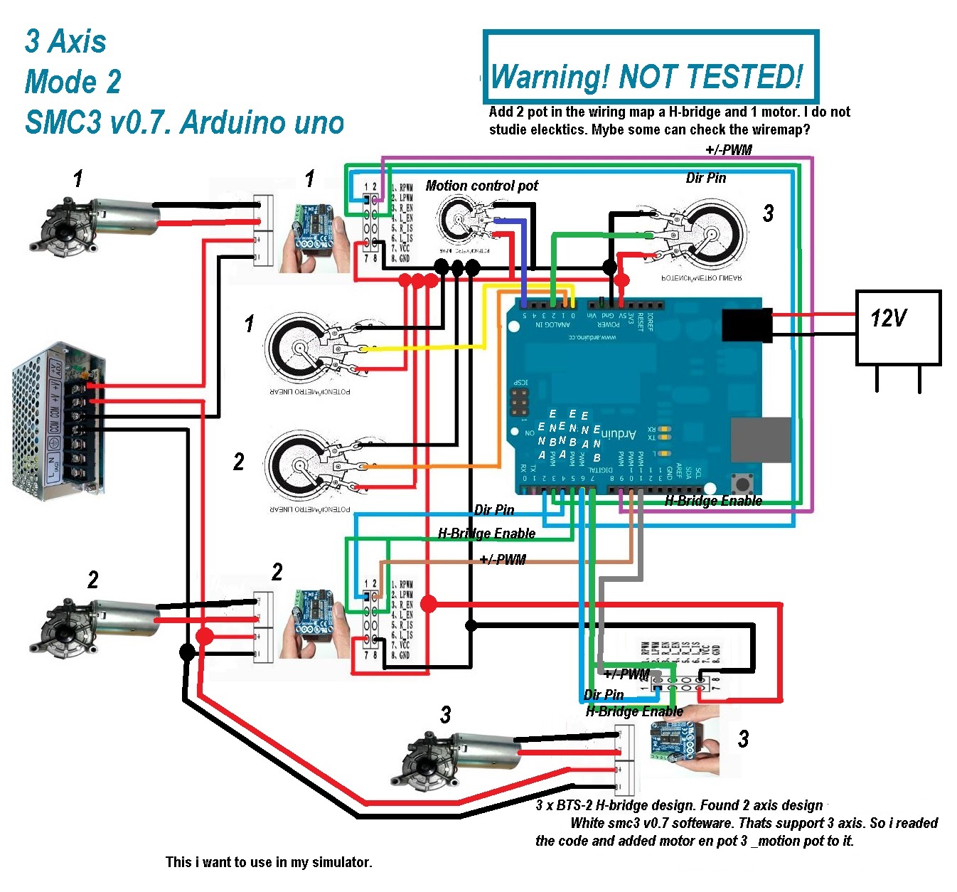

    Hello, first of all nice job congratulations.:thumbs
    I wanted information if it is possible: The fourth potentiometer that you use the "motion control pot" is used to increase and decrease the movement of all forces? What did you use a 10K pot?
    Thanks in advance

    noorbeast Hello and thanks for the quick reply.
    Sorry but I use the online translator.
    Maybe I have not explained myself well: In the wiring diagram that grooste_lwd published, he inserted an extra potentiometer that is "Motion control pot". I kindly wanted to know what it is for? Then he put a reset switch on the Arduino and I wanted to know what it's for too. I hope you understand now. Thank you

    I do not use that pot :( . Sorry. I think it has to 10K for arduino to use....
