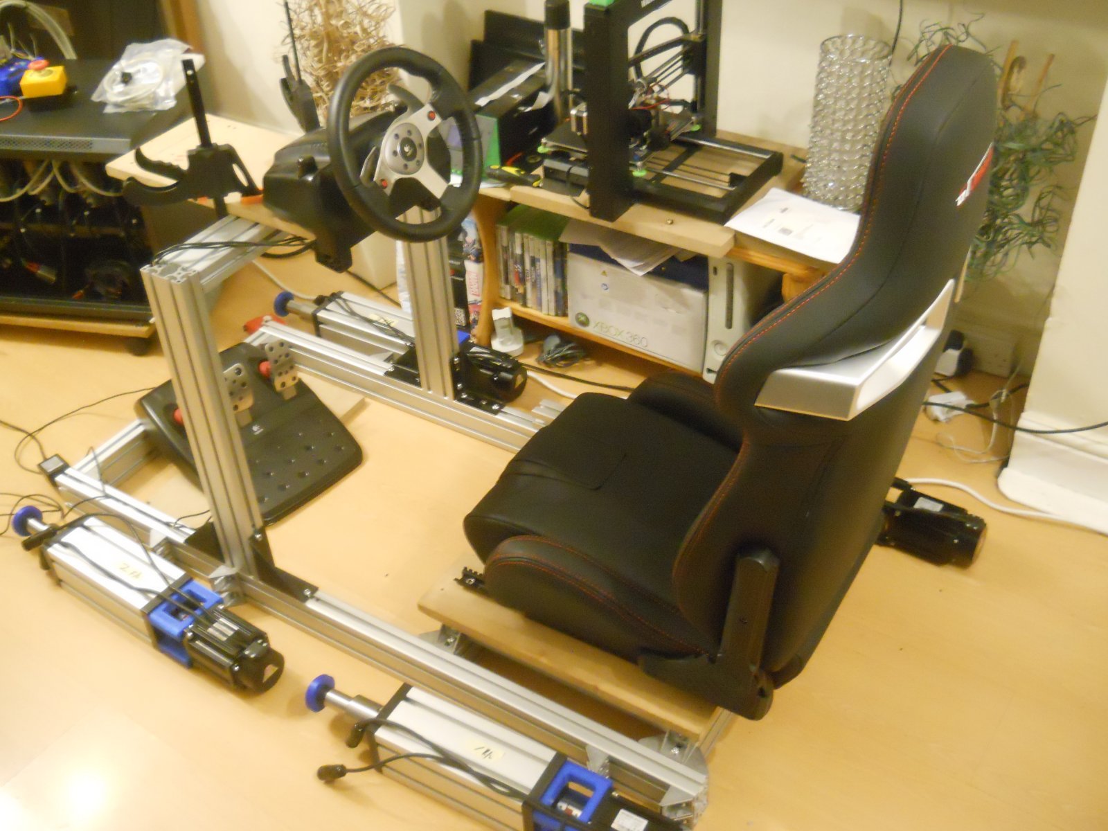

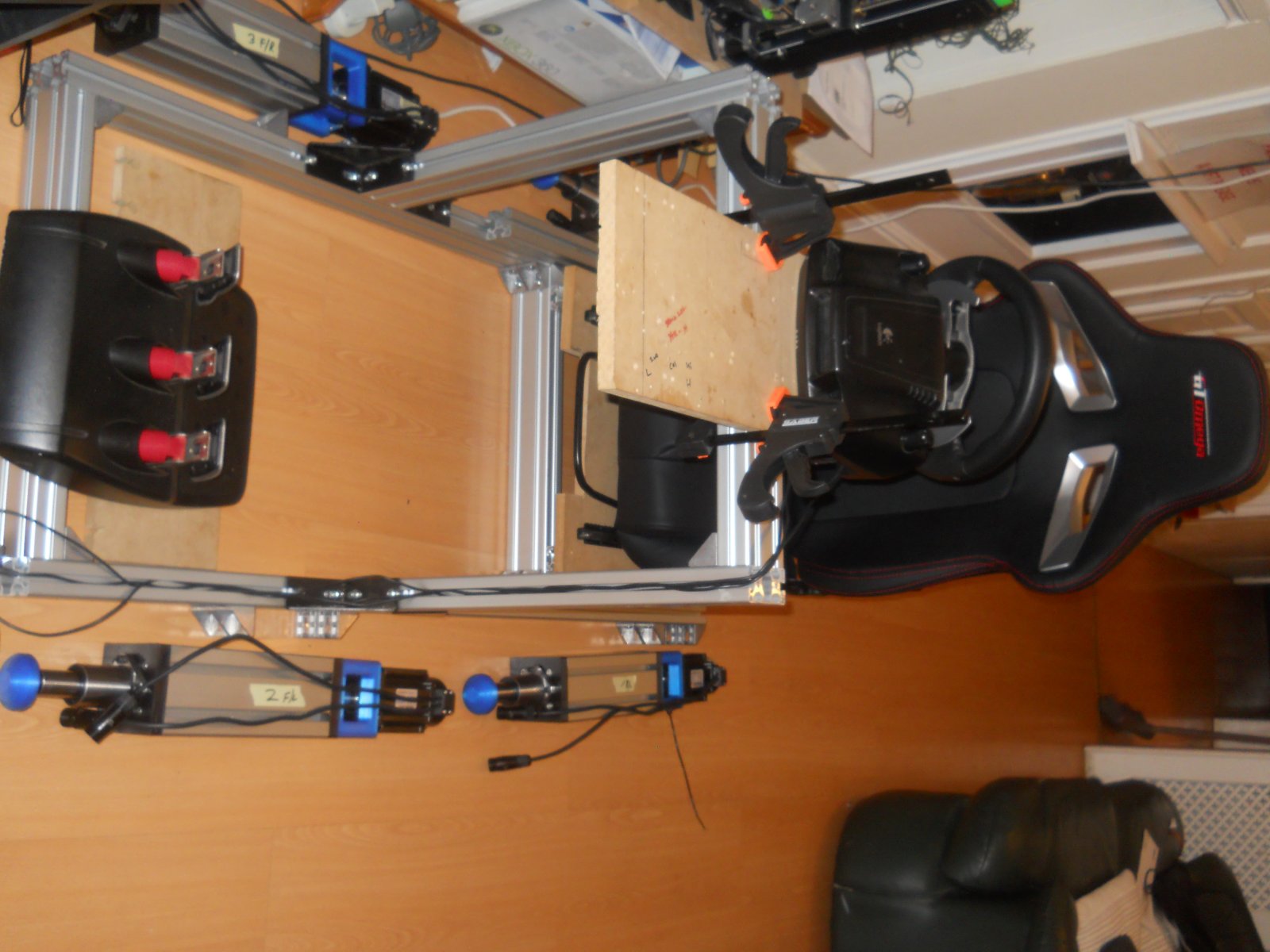

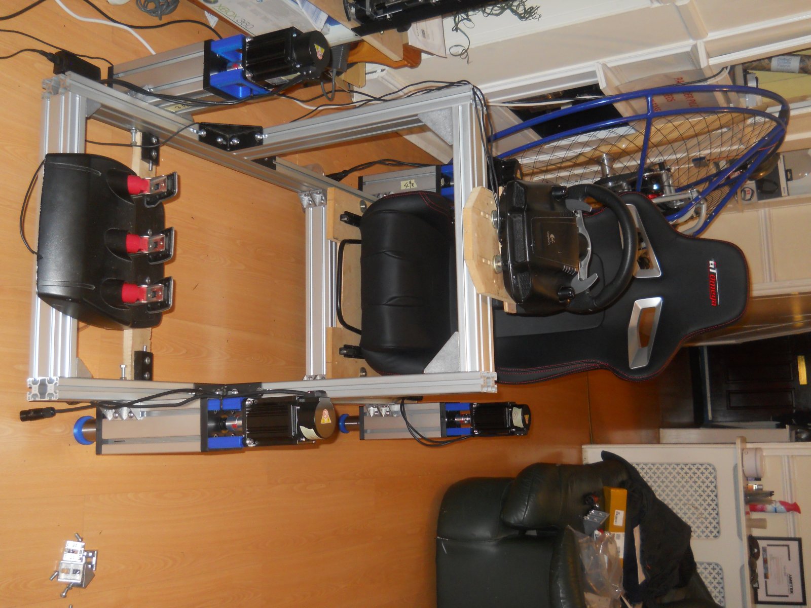

    Dammit didnt order enough brackets for my Cokpit so another delay waiting for parts Bugger :-( anyways more bits ordered so hopefully only a few more days delay this time as Motedis UK seem Pretty good deliverywise..

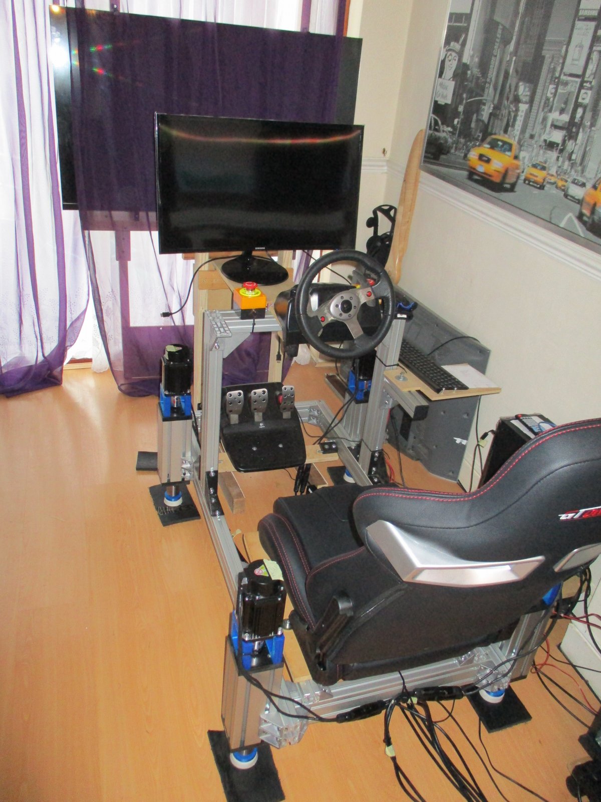

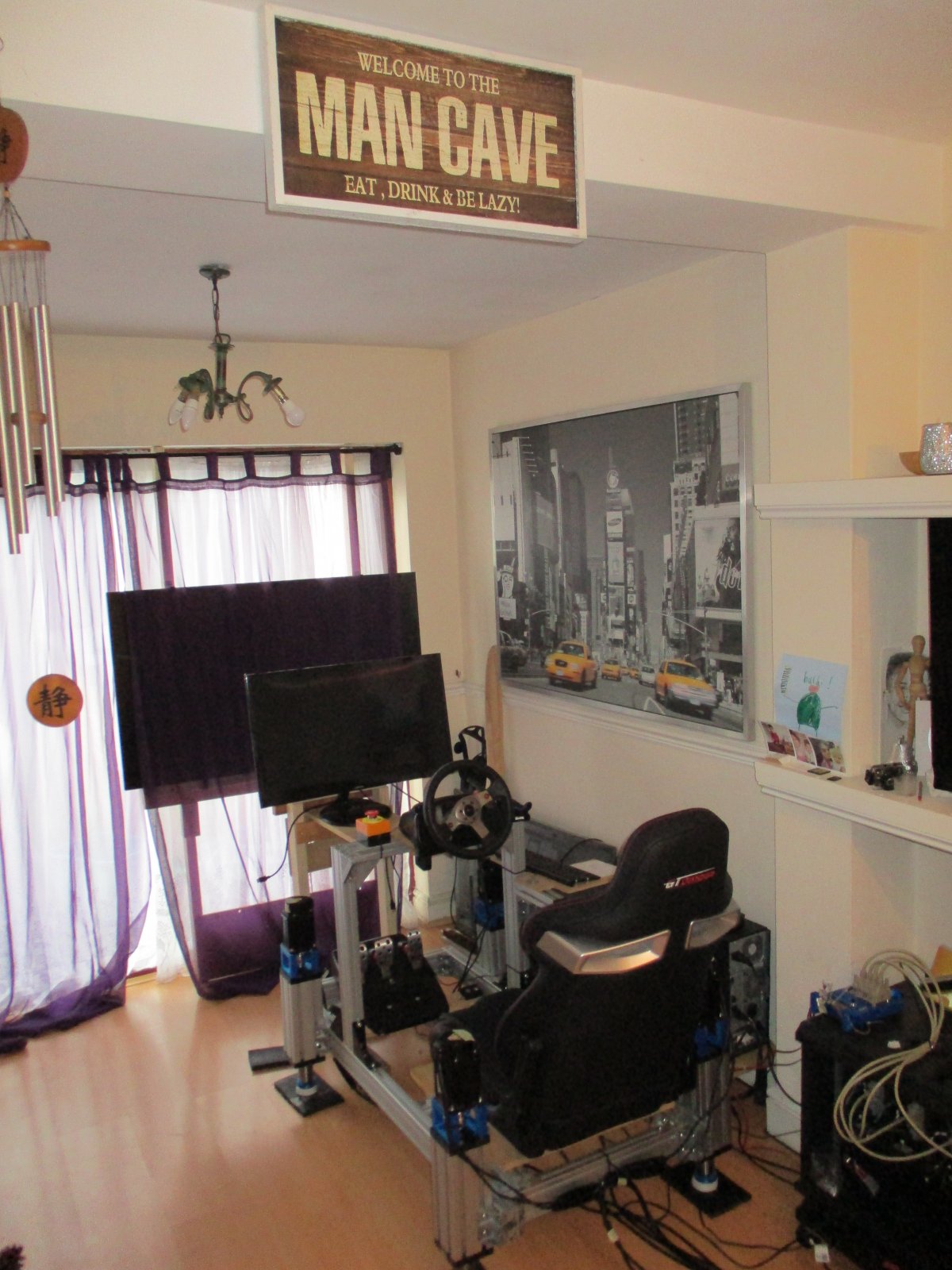

    runnig out of excuses now LOL :) cockpit and actuators mounted and very close to system power up .. more taster pics , the learning detail will start once shes powered up and im running FlyPt Mover .. fingers crossed there will be no bangs smoke or other breakages .
    Had to replace one of my actuator ball screws as mate inadvertently wound the nut down to far --------balls everywhere and must of been short when i reassembled the ball nut as it worked , but just did not feel right ..
    So new one ordered off flea bay last Sunday and its here today so happy chappy .. temporary parking spot till full power up time

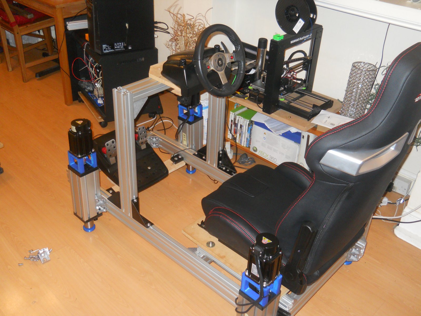

    Looks good!
    I just hope the motor mount supports can handle the torque... Keep the video rolling when testing, might be able to get some viral destruction video out of it!! :p:p
  7. wannabeaflyer2
    Jun 12, 2015
    724
    london uk
    8,359Coins
    +958 / 7 / -0
    LOL you have now Officially placed a seed of doubt in my design thinking :) But remember there are 4 M6x 110 Stainless steel screws so my train of thought was that the 3D printed parts were just stand-off and any torque load should be absorbed with the screws ..... ( He Say Hmmmmmmmm maybe just Maybee :) mind you i have the option of making the same design using CNC delrin Material ( Thats Gotta Be stronger that 3D printed part) HHHHmmmm he say rubbing his chin again " Or Is It" :) Cheers for the feedback guys
