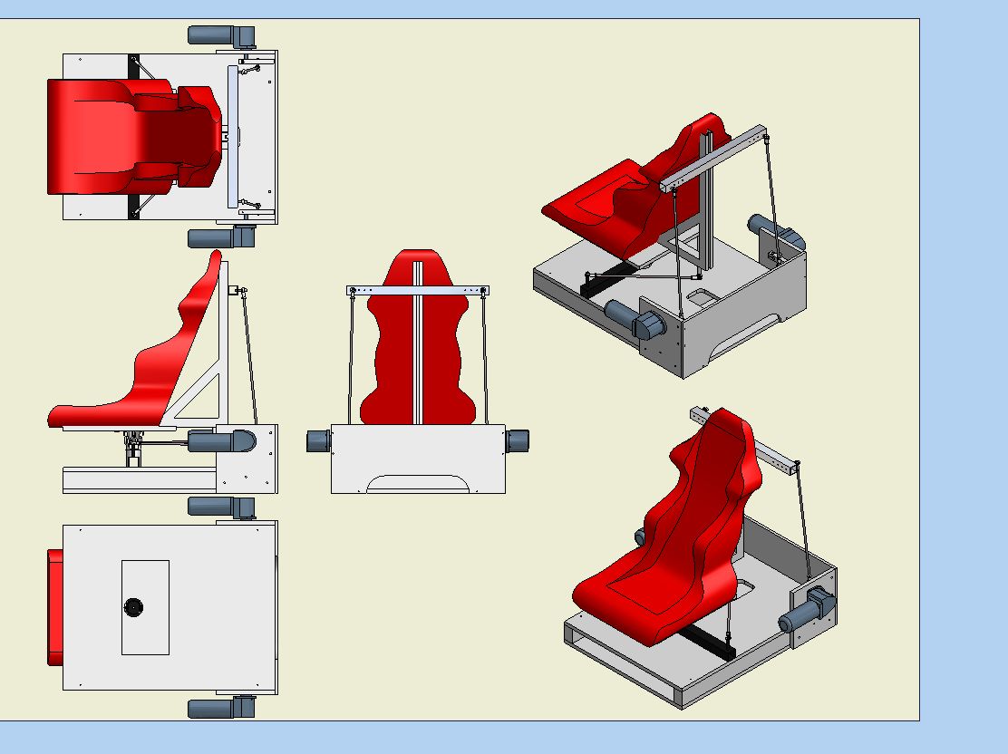

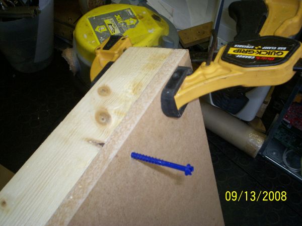

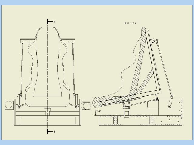

    :hi: guys. well at long last things are coming togather, been collecting all the bits and sourcing the parts , have even made my 1st prototye of the mechanical build just to get the size and feel for my 2DOF project ( Simforce GT/ Tronic /Wannabeaflyer ) 8) i have started my cad drawing for a design made from MDF ( Medium density Fibreboard) and some welded 40mm Square tubing will post the pictures tommorow if i can get them small enough to upload..i have attached some draft drawings of my initial design but needs a lot of refining so no laughing .. feedback always welcome and look forward to being an active member once the ball starts rolling :cheers:

    Forgot to add some planned details
    Will be driven by Tronics AMC & DSHB circuit Boards .
    X-sim Of Course
    will try my 2 Electric Wheel chair Motor ( With Electronic Brake Built in ) for actuators
    Mounted on 18mm MDF base Frame
    40mm Square tube for seat and Unibersal Joint support
    8mm Track rod ends and M10 All screw Rod for Push rods
    My Driving Force Force feedback wheel and pedals ( until i can afford a G25 8)
    and runnig LFS
    :highfive:

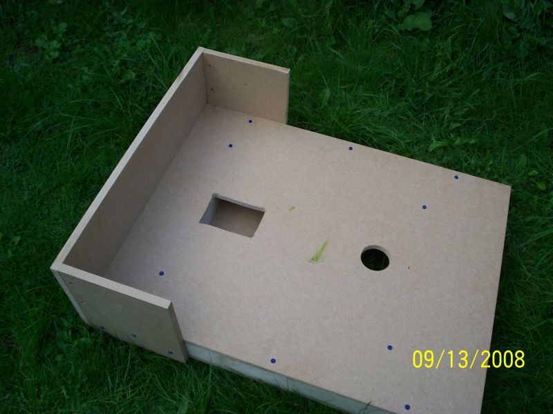

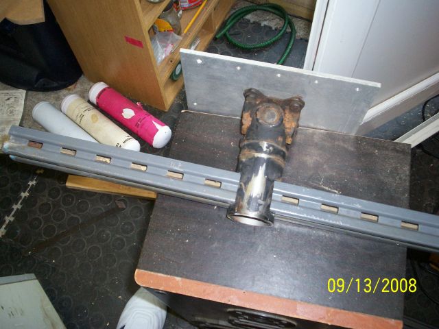

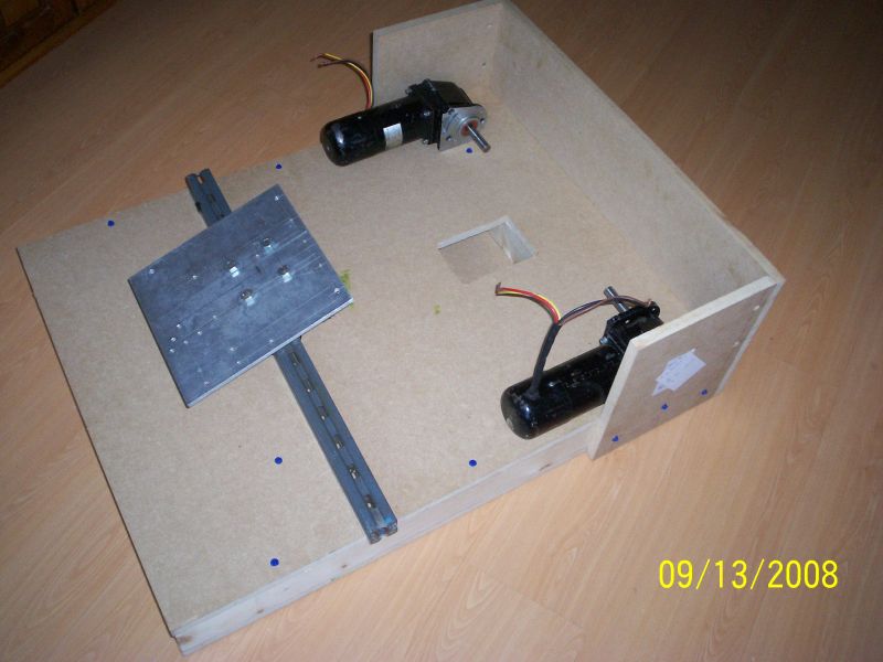

    Just some quick pics of saturday efforts
    :) not finished and its a concept prover so much work to be done but the idea is to make a sstron simforce type simulator using cheap but strong materials comments welcome but no laughing its whats called work in progress :yippiee:

    Re: This is my 1st attempt at a project blog
    The built-in brake is a nice feature. Do you have some additional specs of the wheelchair motors?
    How much Watt and how many rps?
    Have fun with your project! :thbup:
    Regards
    Christian
  5. wannabeaflyer
    wannabeaflyer Active Member
    Jul 31, 2008
    248
    UK - London area
    973Coins
    +34 / 0 / -0
    Hi christian the motors are made by a company called FRACMO ( Location Hastings in england ) they are 24Volt Dc 68 RPM but No Current info on the nameplate :? they were tested on a 12 Volt car battery and worked great ... this weekend i hope to have the Lever arm Made to fit to the Motor Shaft so should have some better pictures soon :) Just seen the OUTPUT Torque and it looks like 24lb force inches will have to convert that to newtons later :thbup:

    Hi Rene Thanks for the comments ...the Square tube was from a Scrapped Work bench from the company i work for. thewy were throwing a lot of old workbenches out and i saw them so thought they may come in handy sometime in the future :yes: turns out i had the exact need for these in my design :) there is also the option to Weld the Universal Joint too a flat metal plate and bolt that to the base will post pictures soon ...like the idea of the name change so will use that suggestion Thanks ...

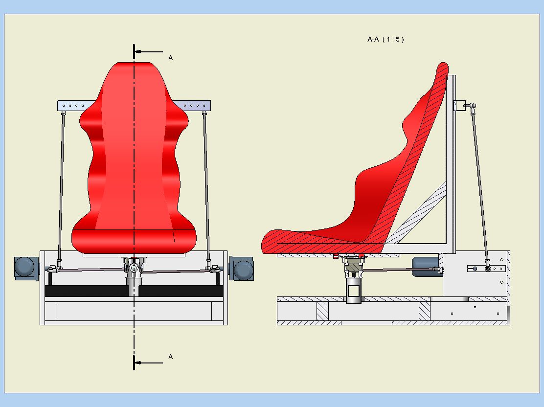

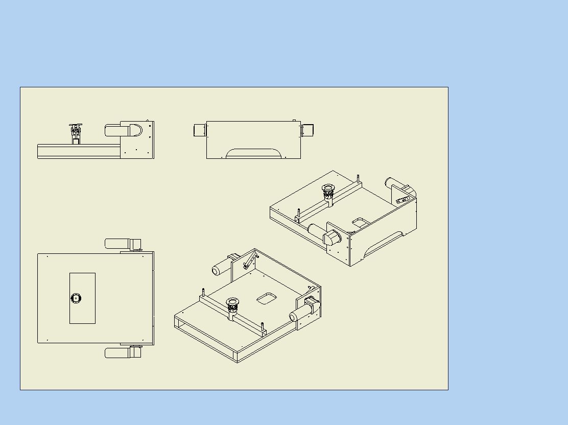

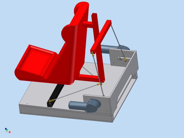

    just a few cad Drawings of my Project 8)

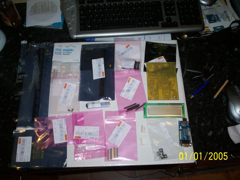

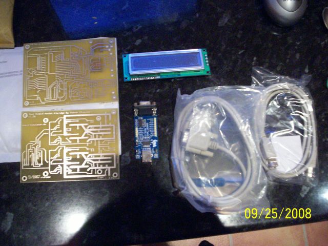

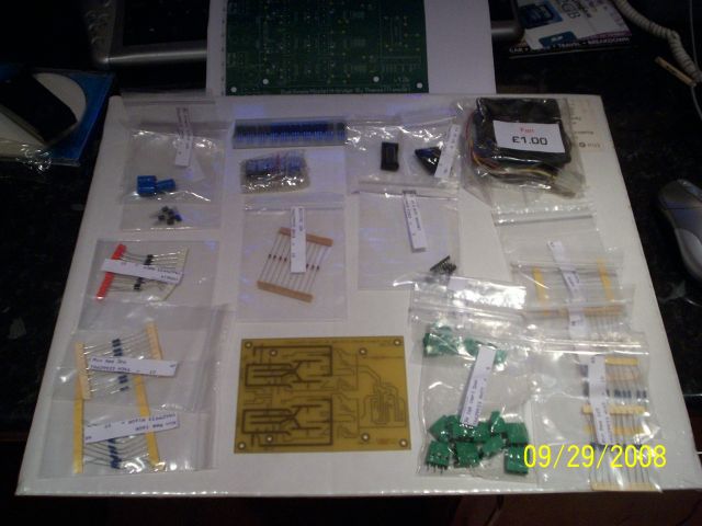

    Got in from work today and :yippiee: :yippiee: and more :yippiee: Heinz the main man has sent my PCB's he did an excellent job and great service i mangaged to use Bablefish and was able to talk to him through e-mails in german/ english and i have to say he was very helpfull and was a pleasure doing bussines with him..as ARNIE would say in the terminator movies I'll be Back 8) cant wait to start soldering at last .. also got 2 LCD displays form E-bay at an excellent price and to top it all my FT232R USB to RS232 Evaluation Board Arrived so good day all around .... Once again Big up thanks to Thanos , Heinz , Christian and all the guys that made my 1st steps possible ...easy part was getting the bits now i have to make it all work LOL:) so be prepared for questions Guys 8) :cheers: will keep you all posted as and when i make some progress....
  10. tronicgr
    tronicgr

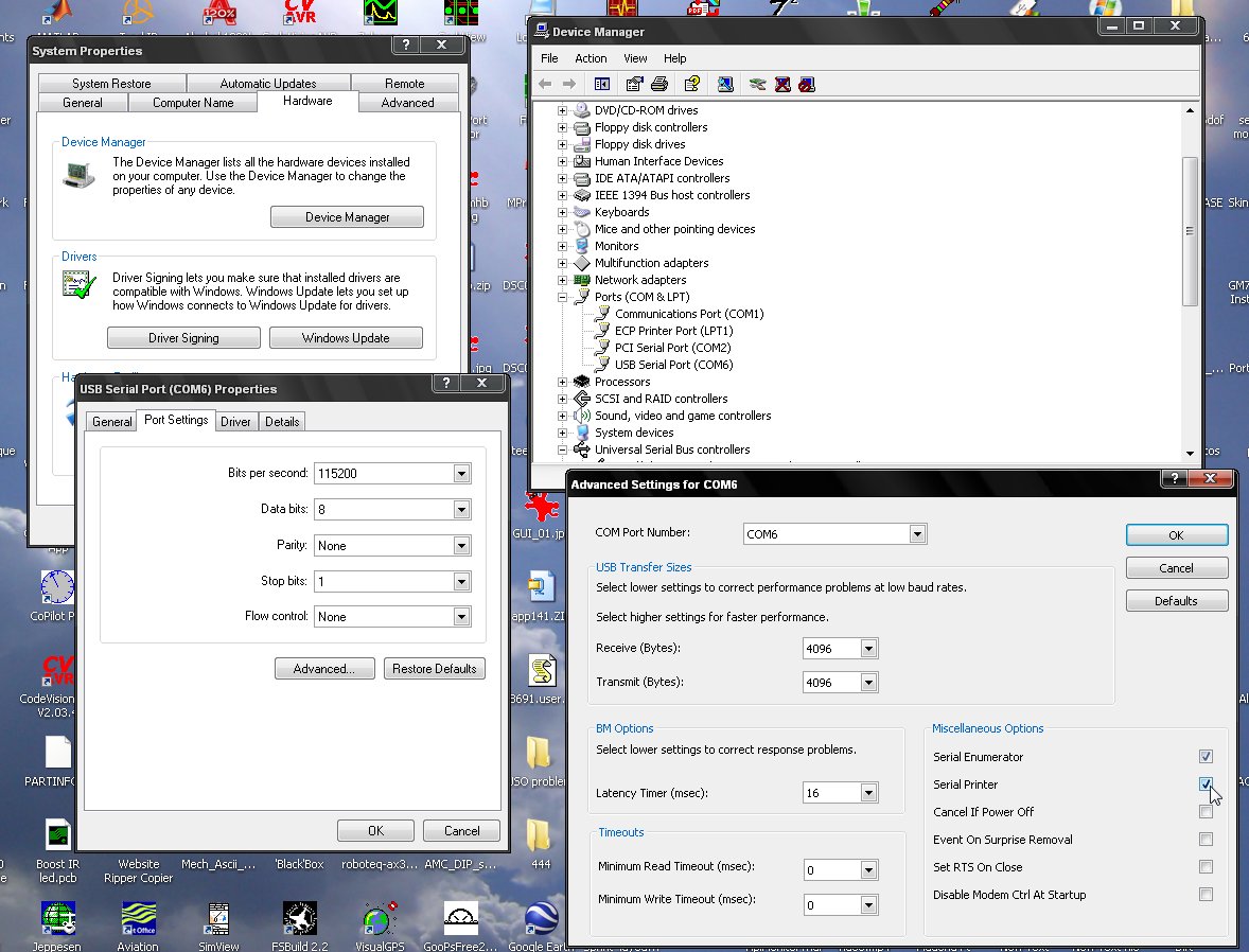

    Now that you have the FT232R USB to RS232 Evaluation Board, you can skip building the Max232 serial motion input subcircuit and connect the RX TX lines directly on the Atmega pins as I did! See this post:
    post9258.html#p9258
    And there is also the ability to just connect the serial port of the adapter to the Prog input of the AMC to program its firmware as well! (a gender converter is needed here though).
    And something to save you from frustration if you can't get it work. Be sure that you have checked the Serial Printer option in the advanced options:
    Any other question, is welcome!
    Regards, Thanos

    Actually this option exists on every FTDI FT232R chip adapter, (no matter its packaging). The manual says:
    If enabled, serial printer will disable timeouts to allow for long delays associated with paper loading
    But I found it necessary, to have this option enabled, with any kind of microcontroller type equipment thru it without problems. It seems that if the communication transfer rate isn't constant (for example delays in microcontrollers) can make FT232R VCP enter a state that is inaccessible .
    I encountered this problem many times, where my customers was trying to interface their handheld diagnostic equipment with FTDI serial converter, and in all cases this option made the trick!!!! (BTW, I sell and maintain computer systems :D )

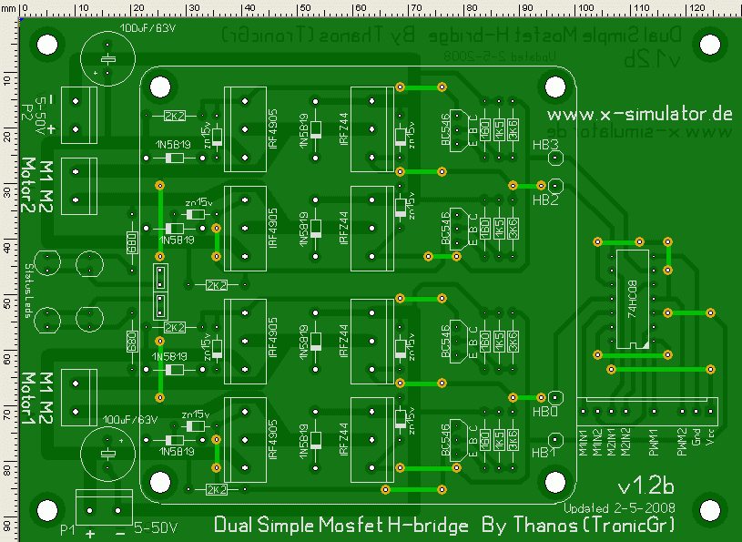

    Update Post :lol: let the assembly Of Thanos's Duel H Bridge Commence 8) 8)

    Hi Guys More smilleys as today i got another present in the form of most of the bits for my Tronic AVR Motion Controller ... Crazy weekend but great weekend coming up lots of soldering to be done and shopping for the last few items.. Fingers crossed :cheers:

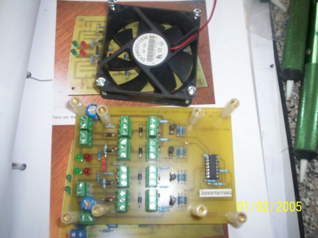

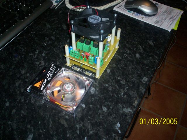

    Progress report :) :) :) DSHB built and only got 3 jobs to do Thicken tracks for higher current ( Build up solder on FET CCT ) bend Mosfetts and and fit to terminal blocks and fit heatsink.... oh almost forgot theres 4 :sos: switch on and test 8) Thanos big thank you again i know its not completed and tested yet so i'll be going back over all the forum post before power up but for allowing me to get this far big thank you. :highfive: will start the AVR controller PCB later Today, Now that should be Fun :lol: ... Thanos any thought on the use of Figerllia Actuators instead of my Electric Wheelchair Motors i weigh 95KG's :blush: so need ti make sure they will be up to the job ... ( SCN5's are the way to go but thats next generation for me ) :cheers:

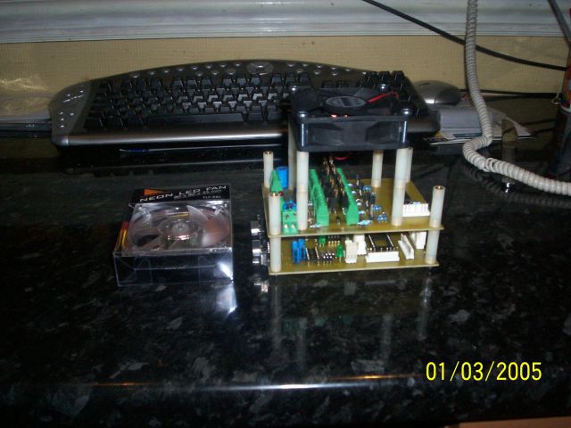

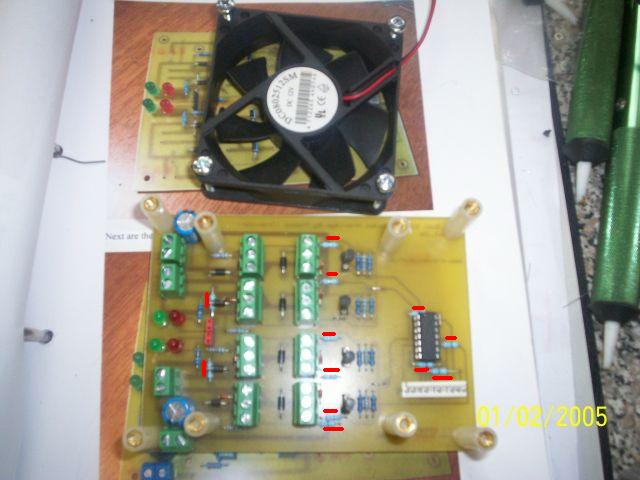

    :hi: Guys next installment, My TRONIC (AVR ) Controller board is almost built just a couple of components missing, Parts Order has been placed so hopefuly 2-3 days and she will be complete.. still got a lot of tidying up to do but most of the key work is done. So its looking at last i can start to have something to show you guys for all the silly questions i've been asking :thbup: some sort of case needs to be made/ bought but that will come after testing both circuit boards to make sure they work the way Thanos designed them to perform :yippiee: D'oh jsut noticed the wrong date stamp on the last lot of photos .. battery change on cheap camera and did not reset data before taking snaps .... :blush:

    Hi wannabeaflyer,
    what are these blue things (red market at picture)?. Are these resistors?. I hope not ;).
  18. tronicgr
    tronicgr
    Yes, they are resistors. They are blue as indication that they are 1% precision !! But don't worry, normal 5% precision will do, if they are not too offset!
    :brows: <--- nice funny smilie isn't? :lol:
    Regards, Thanos
  19. Michael N.
    Michael N. Member
    Dec 27, 2007
    274
    Germany, NRW, Düren
    611Coins
    But, thats wrong or?. There must be wire bridges instead of the resistors, look at this Picture.
  20. Mambo
    Mambo New Member
    Aug 5, 2008
    168
    Czech Republic
    288Coins
    It would be resistor 0ohm.
