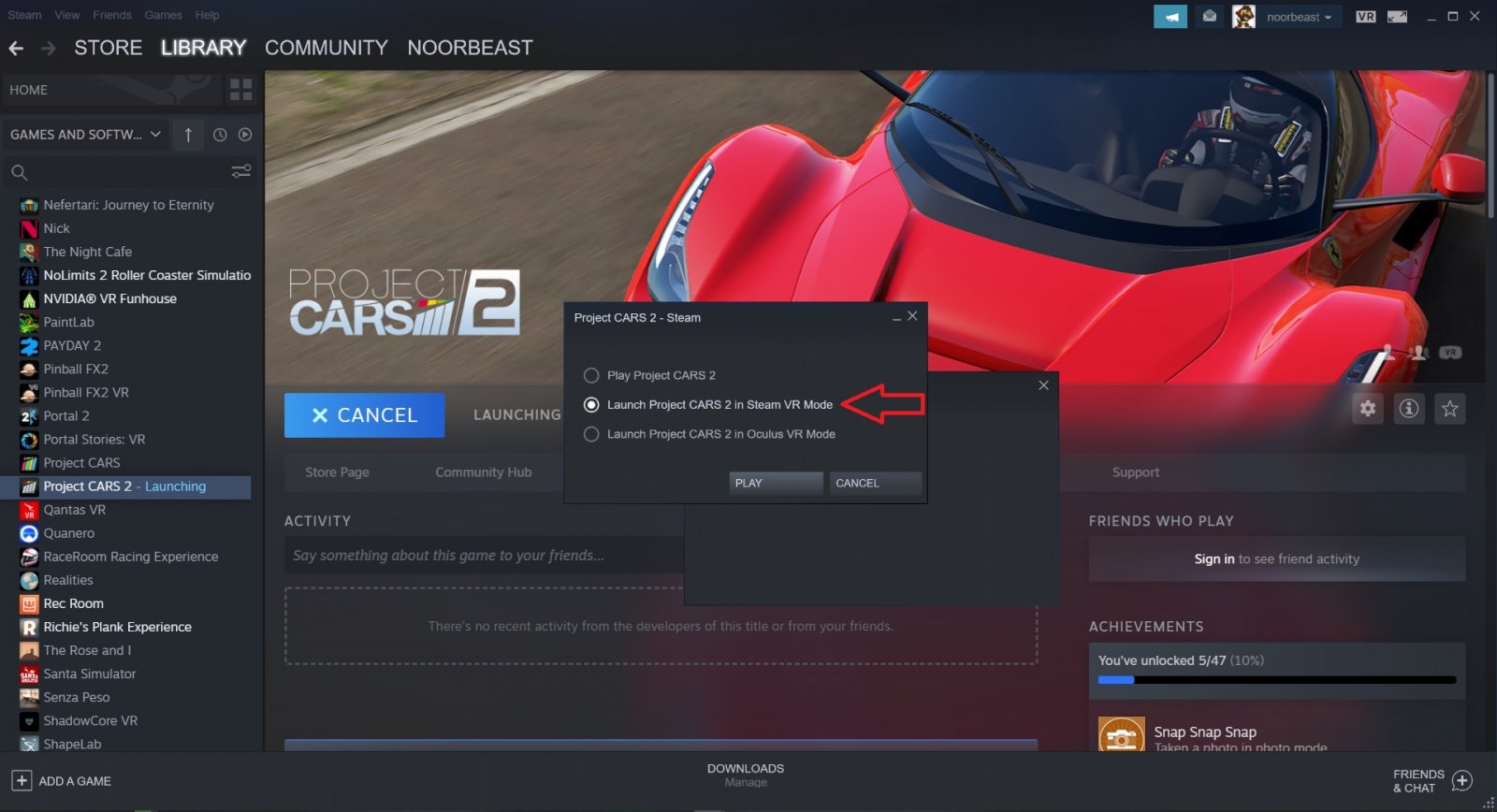

    Again, just to be clear, a game must be launched not just within Steam, but specifically with SteamVR option seleted, not the Oculus option. SteamVR will hand off to the Oculus software but should still allow the motion cancellation to function via SteamVR.

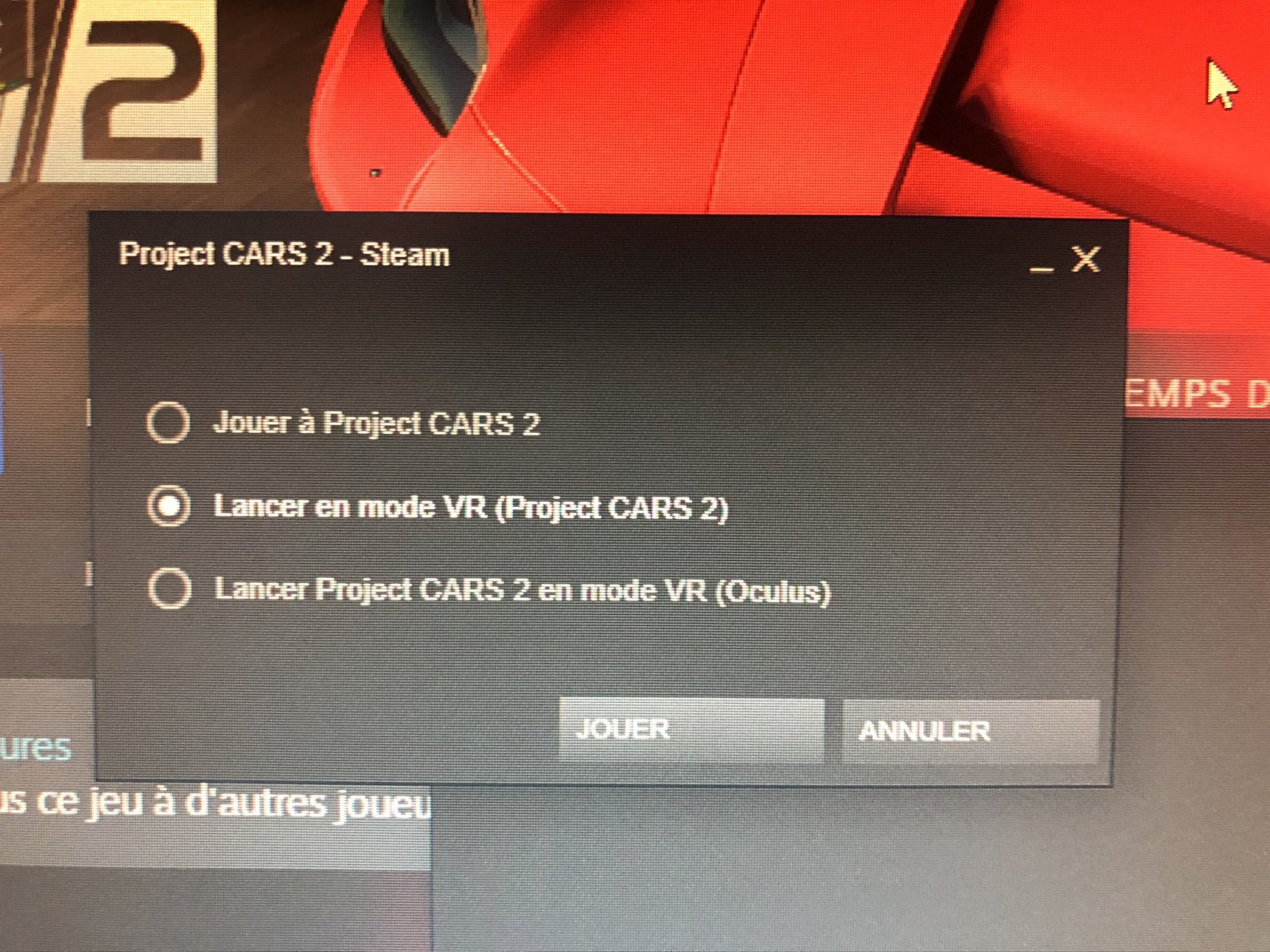

    @noorbeast : When you said the game must be launched with steam VR option selected could you tell me what the process you was thinking about ? which setup ? what check box ?
    I tried a lot of things, I launched the game inside steam VR wearing my headset without success also and one more time , I can’t explain why some games ( assetto corsa competizione , assetto corsa , pcars1 ) it works perfectly and other not with exactly the same method to launch the games !
    I don’t know where you select steam VR , I never seen this option .
    Look at my pics from launching option into steam .
    The first one you launch the game into steam like you are in a cinema . You watch a screen in front of you in the headset .
    The second one is for me the one used for launching the game into steam vr
    The third one is the one you surely launch without steam vr into oculus .
    The problem I ‘m facing is that the second and third option have exactly the same result !
    For the third it’s completely normal not the second and I don’t know why !

    I mean launch from Steam, not from within the HMD, like this, so that SteamVR has control:

    Did you have already launched steamvr ?
    When I look at me , I first launch steamvr to apply motion cancelation feature and then I launch the game like you described .
    The difference is that I don’t have the message that the game is launched with steam VR .
    Look at my pics when doing the process I described.
    I don’t have the information with steam VR and steam be is already launched !

    SteamVR should launch when the game is started using the SteamVR option.

    @noorbeast : I checked on my pc without launching before steam vr . And when I want to launch the game i don’t have the second option which says launch the game with steam VR . It’s just written launch the game in vr mode .
    And the game is launched via oculus software . And I noticed , the second and third option have the same result , game is launched via oculus .
    First question : why this second option launching with steam vr is not proposed on my steam application ?
    Second question : do you think it could come from revive application ?
    Maybe I have to uninstall revive because Dschadu motion feature works ?
    Or any other idea ?
    Thanks !
