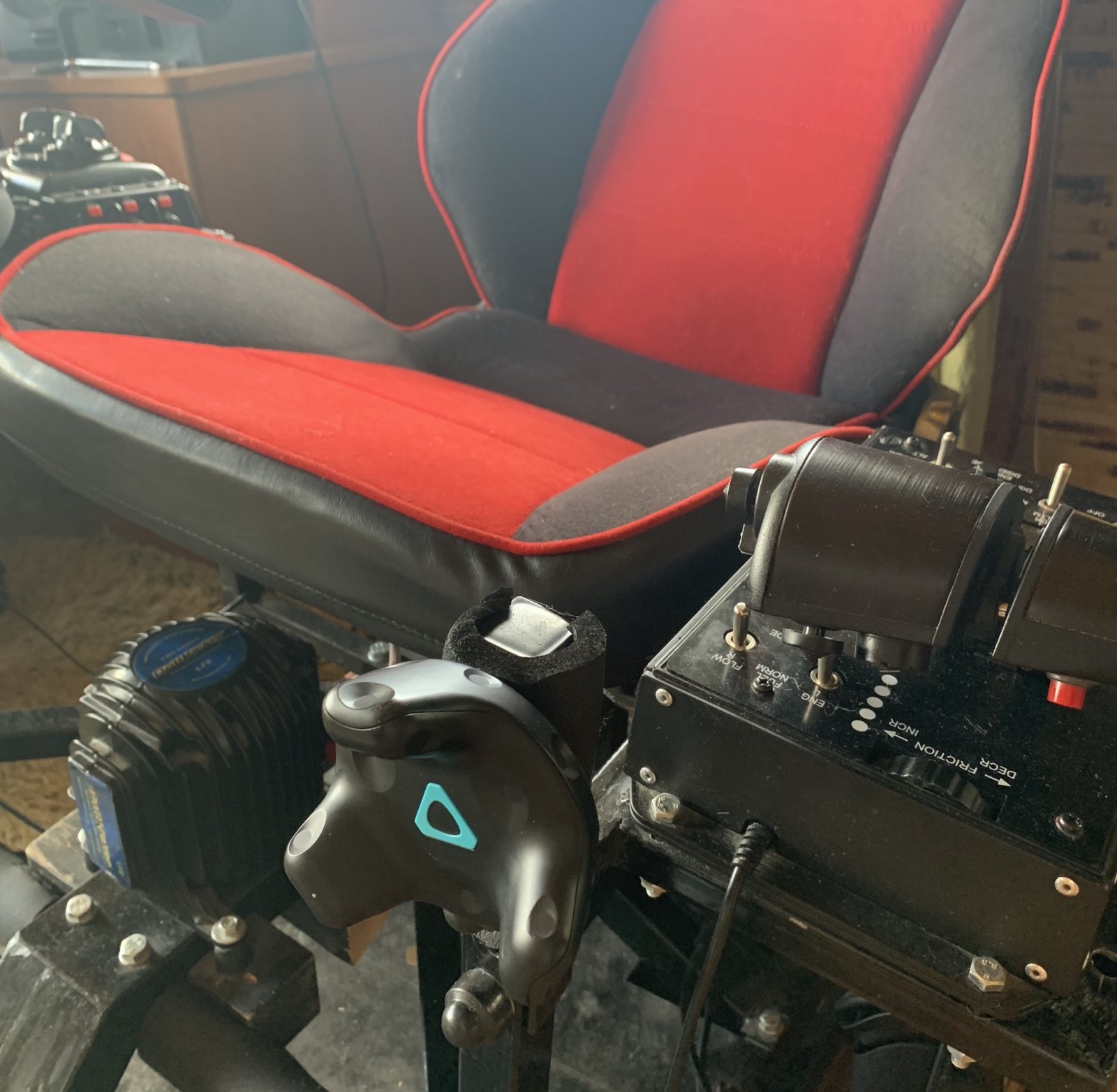

    In my case after long search for the sweet spot I found pretty unlikely place for 2.0 tracker - bolted really firm and tight on the base frame close to buttkicker itself. It seems that long metal armature does in fact increase vibe amplitude and after-wobble. With this setup, small shaking is quite severe during cannonfire (which in case of WWII planes I currently play is actually realistic), but doesnt entail any trashing around or tracking issues. Since I usually lean to crosshair at this time, I dont even notice it. Also, I got totally calm picture with engine rumble, while it still feels well enough.
    Tracker positioning as close to head as possible seems totally unnecessary in my case, but that may be actual for particular 2dof platform with limited angles I use.

    Interesting. How high is your center of rotation for your 2DOF and how big are your angles? The higher your center of rotation, the less translational error there would be in tracking your head during 2DOF motion. If you had fairly large angles and the hinge was under your seat you would find that in pitch motions you go forward and back in the cockpit quite a bit, and in roll motions your head would move left and right, in a fighter almost certainly through the glass canopy.
    With my sim if I put the tracker that low my head will go outside the cockpit in pretty much every direction! =P
    Also interesting, with my equipment (lighthouse 1.0) the problem isn't just vibration of the camera, it's like SteamVR decides the tracking data is corrupt. If I'm looking at the controller in SteamVR home with the shakers running the controller/tracker will wobble around a bit and then just disappear. It might stay gone only for seconds or for minutes.

    With 15 degrees of angle and about 1 meter from hinge to head (half that to tracker) I dont bump into canopy even without compensation.
    I did experience tracking loss as you describe, when tracker (or wand, have no difference in their performance) was far from vibe source and fixed with gel pack. Seems that amplitude plays greater role in this trouble, then actual force, but that is just a hinch. No such problems with latest setup on pic.
