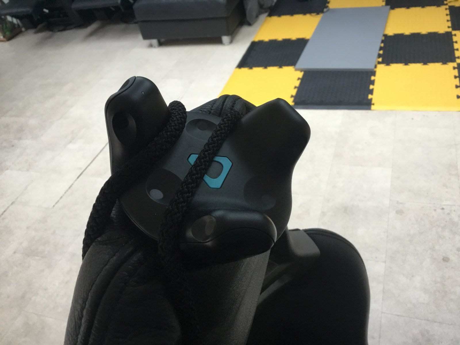

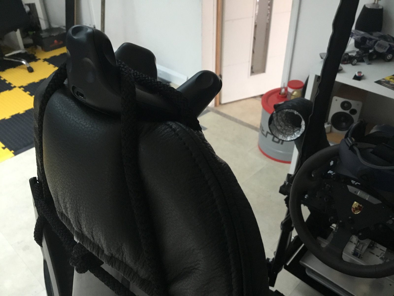

    What you need to do is Mount the controller on your rig behind the seat just above your head, that providing your seat has some cushion or foam behind the seat material, get some bungeee rope and tie it on really strong and tight so the controller nestles into the seat, you should find a huge improvement. Basically what you are attempting is to suppress the vibration from the rig. I use Vive Pro the a Vive tracker behind my head at the top of the seat, my bucket seat is carbon fibre with leather and foam, I have no vibration at all. I’ve tried all sorts of solutions and that basic set up works best.
    If you fit the tracker or controller to a mount and then mount again to the rig theirs no suppression,
    If your sneat hasn’t got foam then fit some and try it out, I wish you luck and hope this fixes your vibration, by the way are setting the motion compensation to SET ZERO, you will need too.

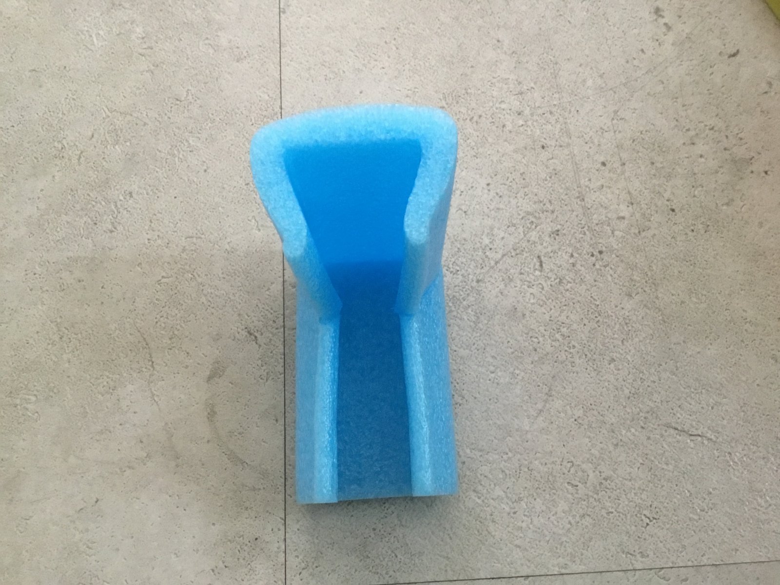

    Cant you just do the same at your mounting point by building up a cushioned area?
    I get the same as you in your video if I mount onto any hard part of my rig with a clamp, I've tried gimbal rubbers, they don't work.
    see pics below, my seat already had some foam under the leather, I inserted more from a bit of packing I found, (Last Photo)

    Yeah tried all sorts but the way the WMR controllers are made it's really hard to secure all of it to stop the vibrations and little spikes.
