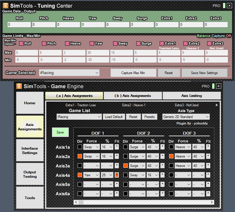

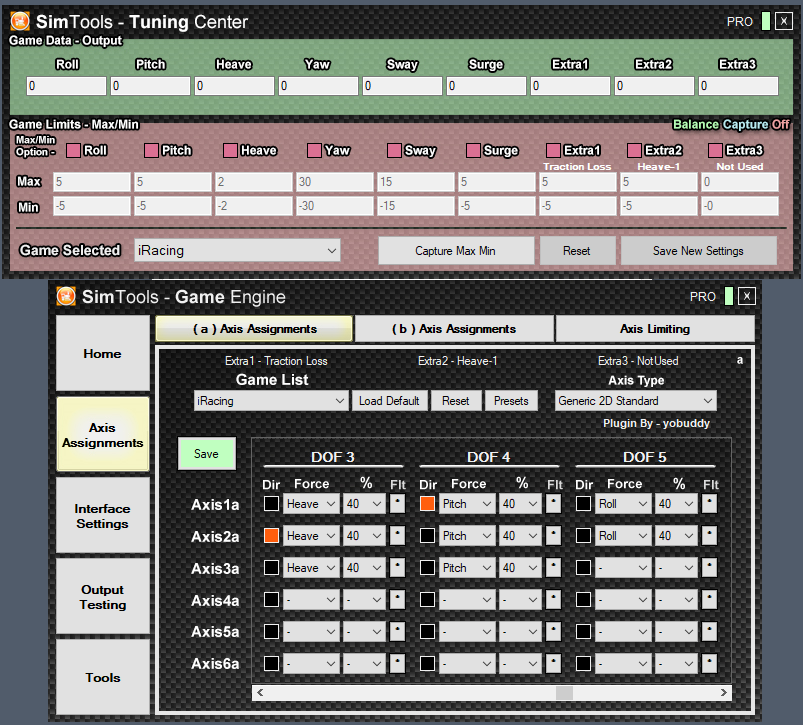

    I wont try to mount the base stations on the rig, its not required.
    The current set up is working, the anti vibration plate will be for the Tracker, if it helps that is, I will try.
    Could you please look at my settings and give advice on whether they are working in Harmony or conflicting, everything feels ok its just I don't know myself and would like some guidance and reassurance for the longevity of the motors and parts.
    The above post (407) has the video of how the rig is moving with these settings.

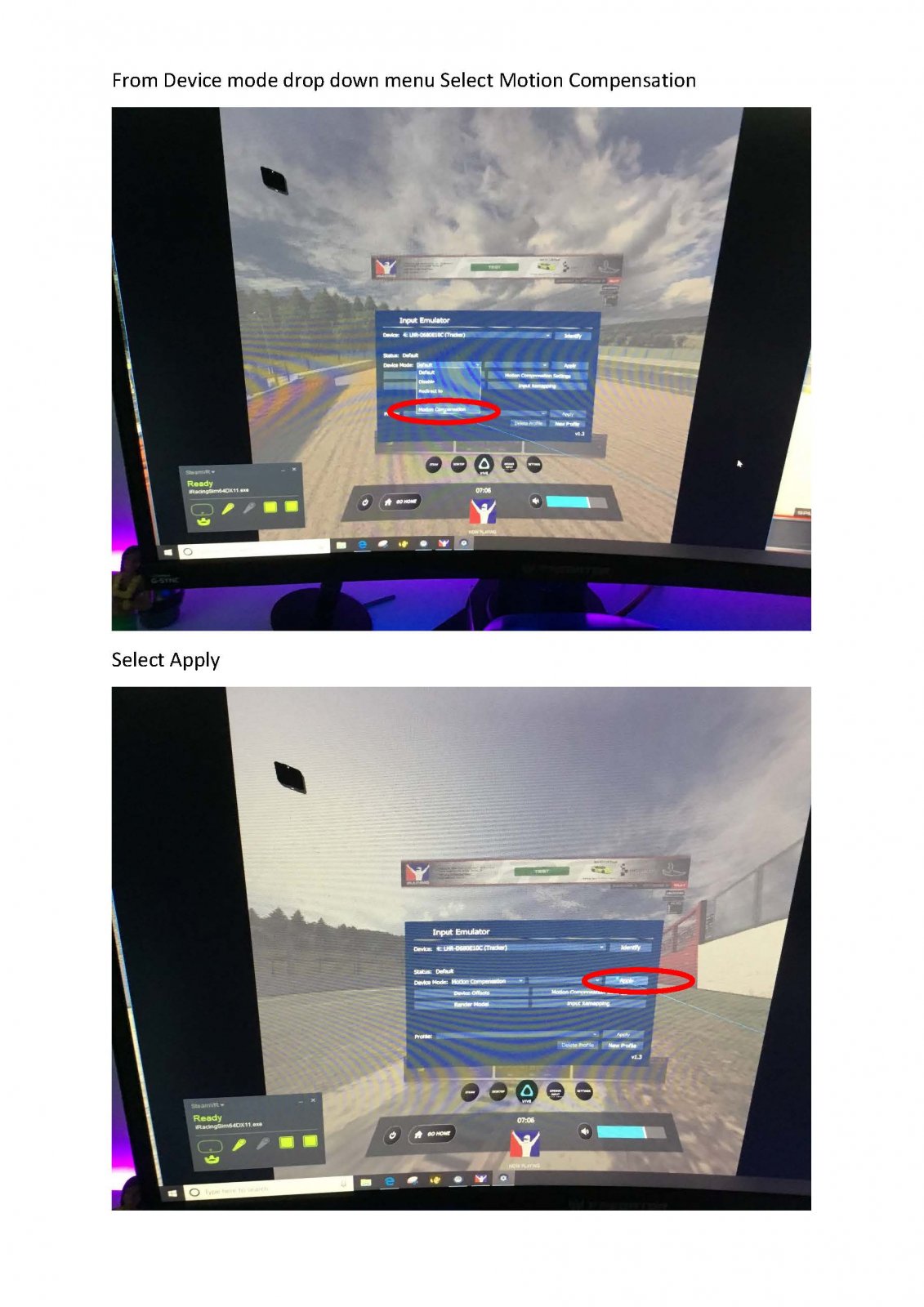

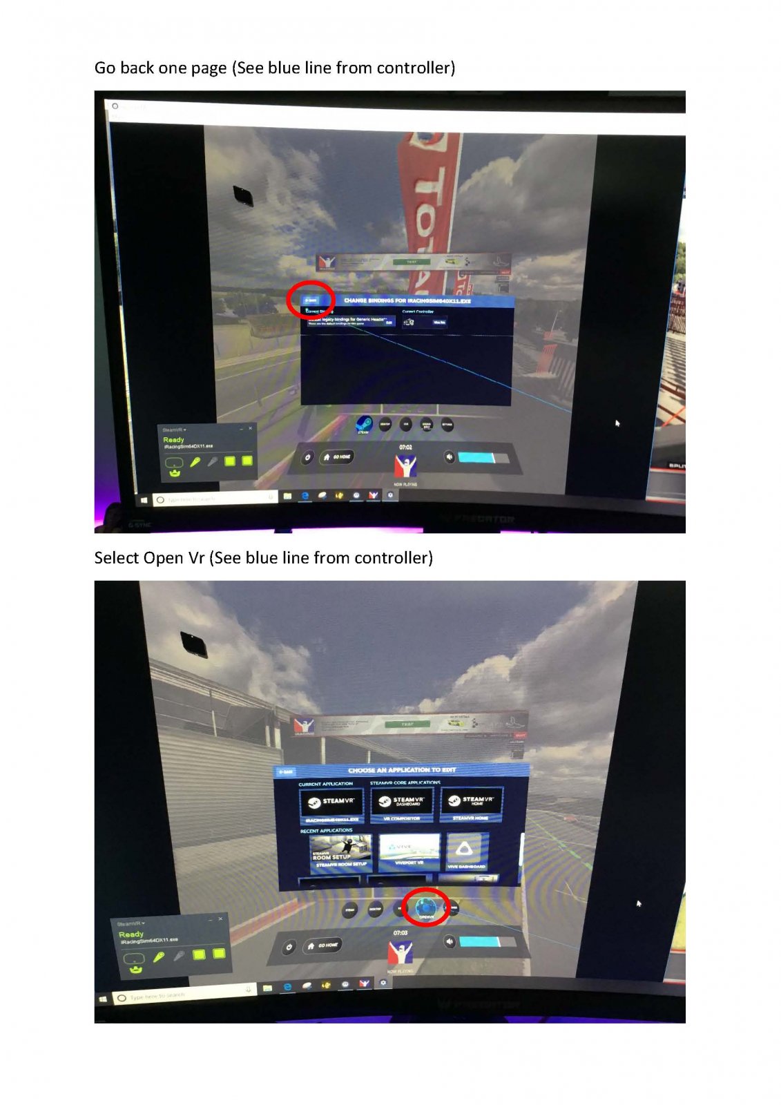

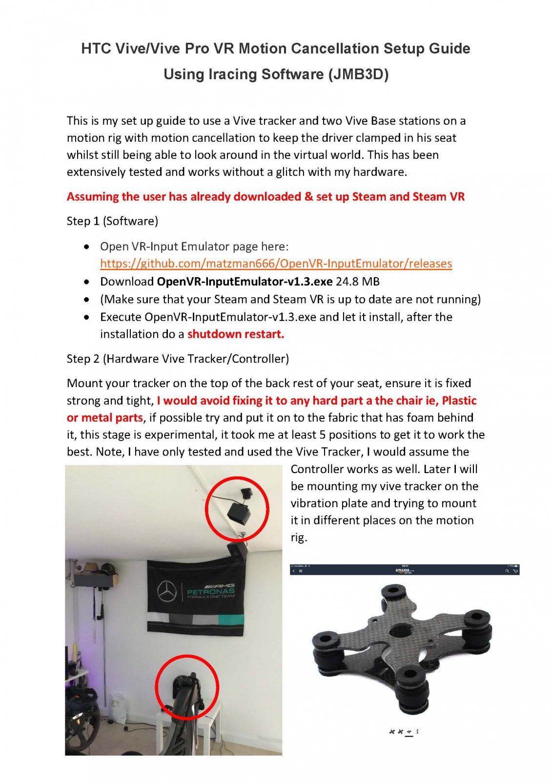

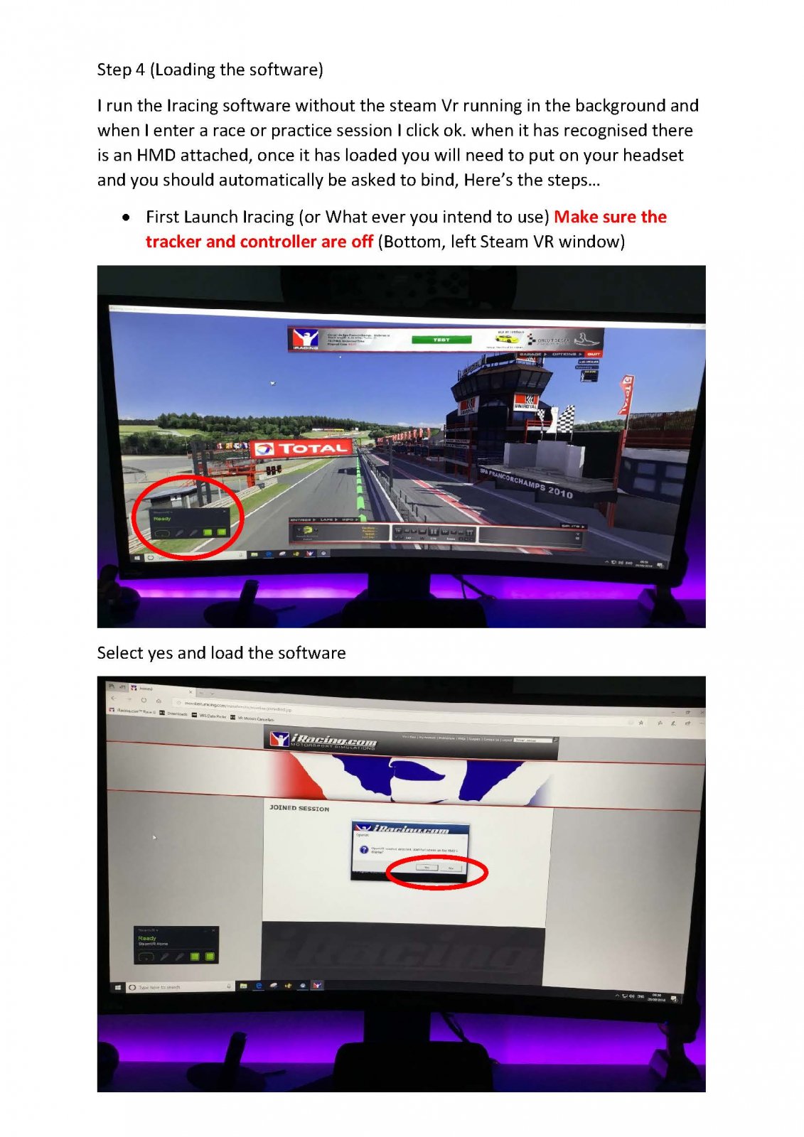

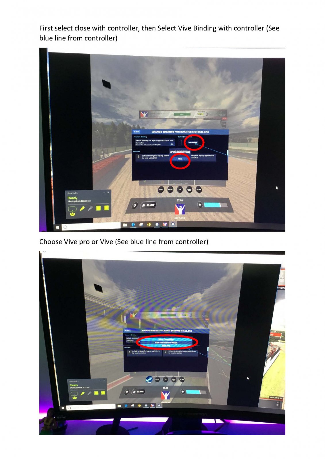

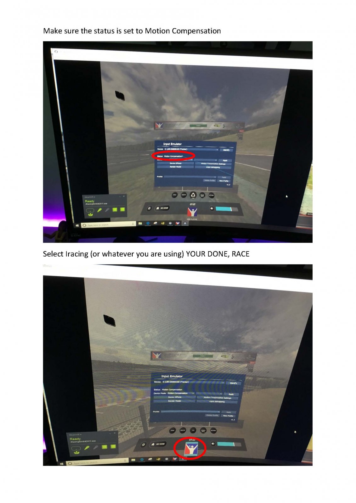

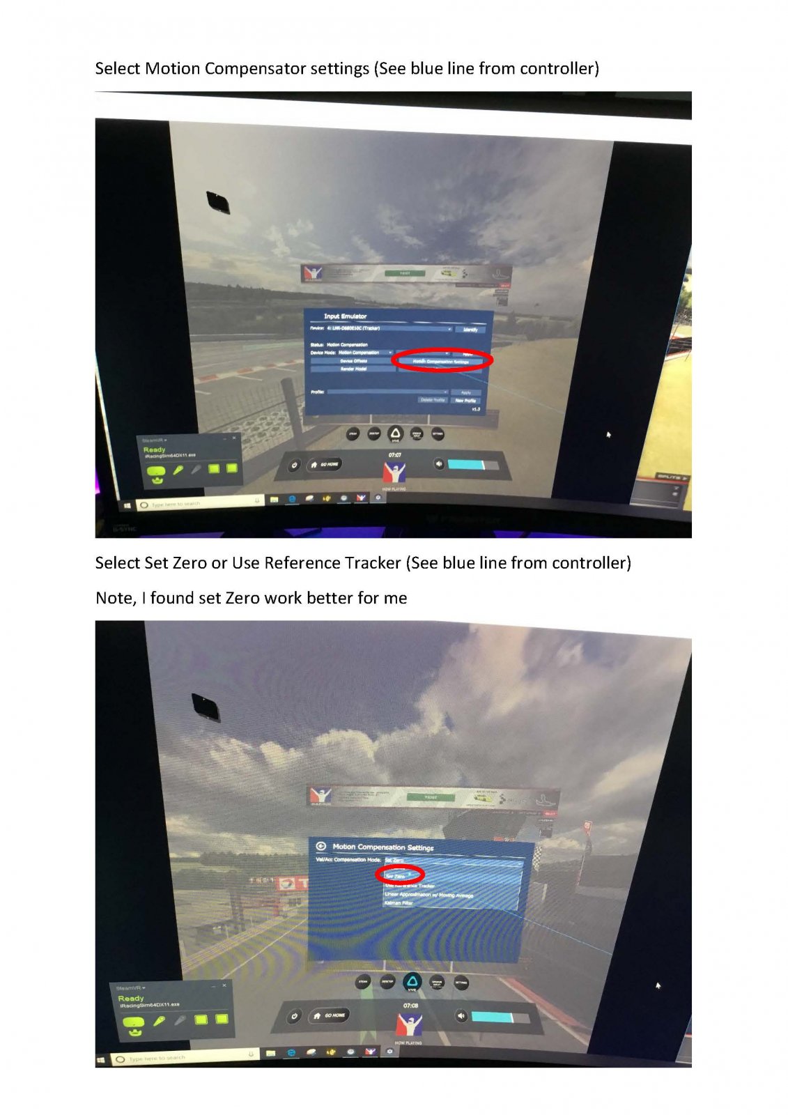

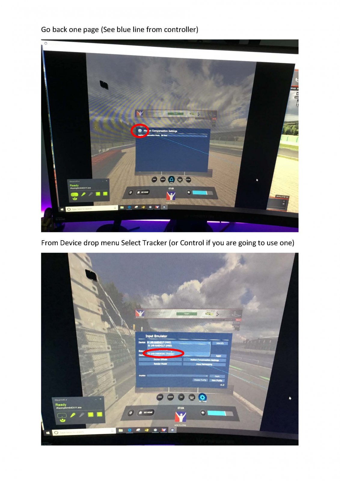

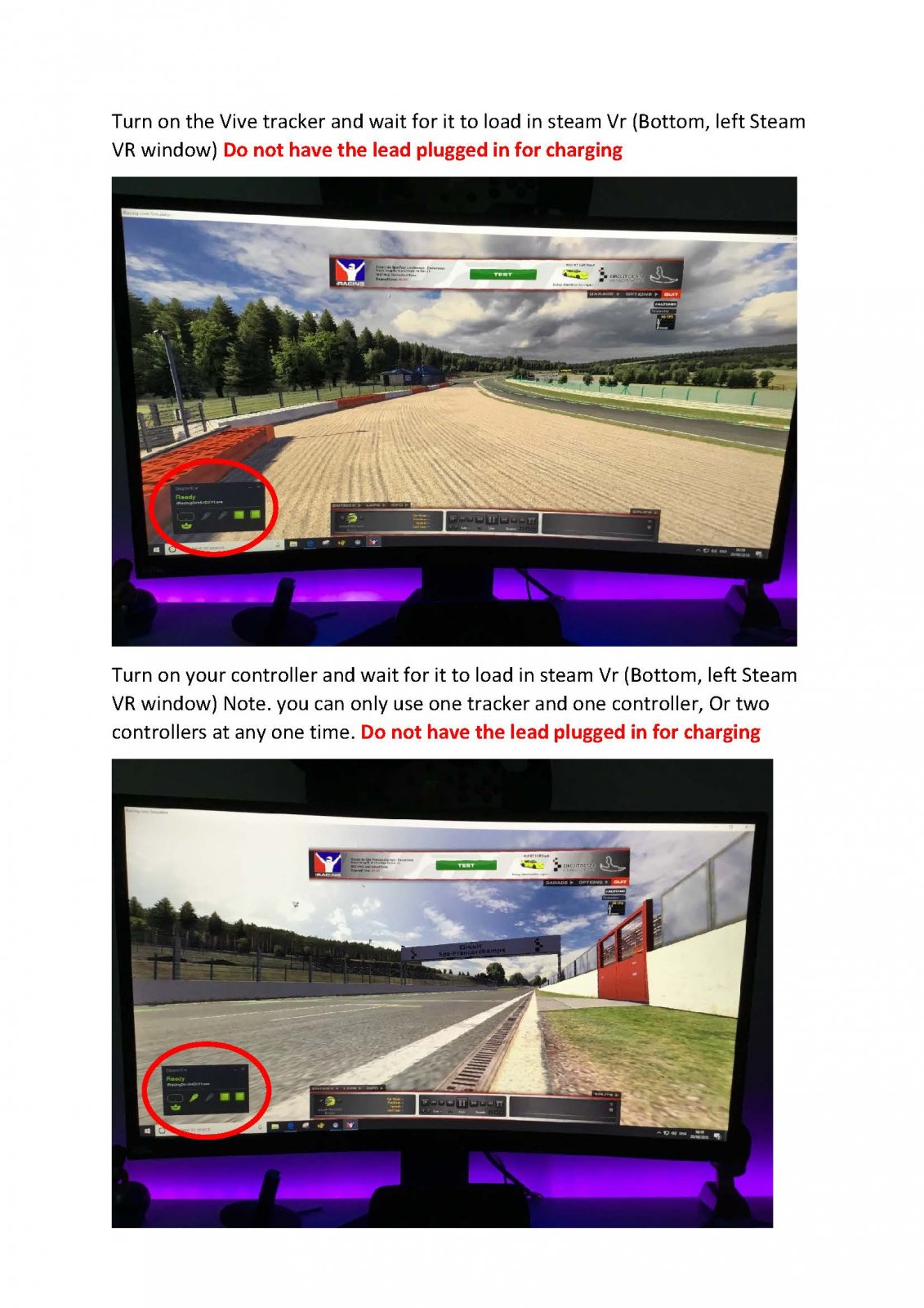

    HTC Vive - Vive Pro VR Motion Cancellation Setup Guide.
    HTC Vive Vive Pro VR Motion Cancellation Setup Guide_Page_01.jpg HTC Vive Vive Pro VR Motion Cancellation Setup Guide_Page_02.jpg HTC Vive Vive Pro VR Motion Cancellation Setup Guide_Page_03.jpg HTC Vive Vive Pro VR Motion Cancellation Setup Guide_Page_04.jpg HTC Vive Vive Pro VR Motion Cancellation Setup Guide_Page_05.jpg HTC Vive Vive Pro VR Motion Cancellation Setup Guide_Page_06.jpg HTC Vive Vive Pro VR Motion Cancellation Setup Guide_Page_07.jpg HTC Vive Vive Pro VR Motion Cancellation Setup Guide_Page_08.jpg HTC Vive Vive Pro VR Motion Cancellation Setup Guide_Page_09.jpg HTC Vive Vive Pro VR Motion Cancellation Setup Guide_Page_10.jpg

    A question, so you first need to install OpenVR and set it up for the Tracker correct? Then using the guide you can configure for games? Does this have to be done for each game when you want cancellation
  12. JMB3D
    JMB3D Member
    Jun 1, 2018
    50
    UK
    689Coins
    +31 / 0 / -0
    4DOF
    Yes install first as guide says, Then for each time you use it you have to apply the settings in the guide, unfortunately they dont save or default back to the last ones you used. Once you get use to it takes literality no time, I do mine in 20 seconds, its done.

    For what it's worth the Vive tracker (2018 model) is supposed to work while plugged into USB, at least according to the manual. I haven't even done the wireless setup on mine and have only ever used a wired connection.
    That said, it seems to be very finicky about the USB connection. On multiple occasions I'd get everything set up and tracking but the moment I started driving the tracker would immediately (and consistently) disappear from SteamVR. When this happened, getting it to show up again could be an ordeal.
    As I recall, I moved it from a USB 3 hub shared with a bunch of other gear to its own port attached to a motherboard header, and that seemed to help.
  14. JMB3D
    JMB3D Member
    Jun 1, 2018
    50
    UK
    689Coins
    +31 / 0 / -0
    4DOF
    I'm finding with the tracker that if I have the USB plugged in for charging and switch it on once steam VR is loaded it wont track,
    I always leave it unplugged an its fine, never lost racking so far and I have done loads of races now,
    once it is tracking I can plug in the USB for charging and it stays stable and tracks no problem.
