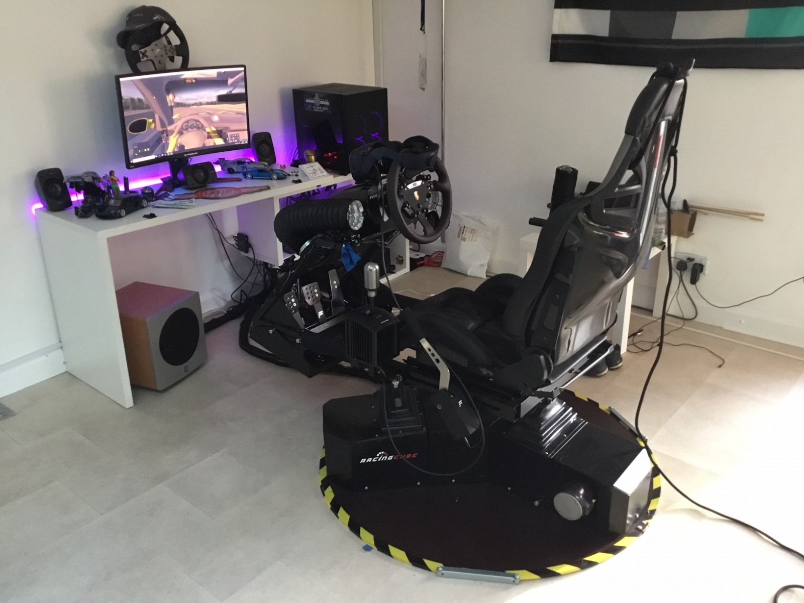

    Ok Tested with Vive Tracker Mounted relatively securely on Top of Carbon Fibre Bucket Seat.
    Great News this is now working, I've tuned up the Yaw from 5 to 15 and the pitch from 10 to 30 for testing and its great, what relief. I'm driving the Porsche Ruf Track at Barber, This track has got it all for motion with tight corners, nice hills, some quick some slow, and places you need to use the kerbs, the Tracking is pretty much spot on, still room for a little improvement but more than useable, I will spend the rest of the day tuning the motion rig to get a good field of movement that I can enjoy.
    A few pointers so far, I've opted out a Beta, and I'm using the Set Zero setting I think their is a slight improvement with this over using reference tracker.
    I cant thank the maker of this enough, Top Man.

  7. JMB3D
    JMB3D Member
    Jun 1, 2018
    50
    UK
    689Coins
    +31 / 0 / -0
    4DOF
    I just finished an extensive test session, I feel sick TBH, you take a bit of getting used to but maybes that my age. [​IMG] [​IMG]
    What i can tell you is you will need two hand held trackers or one tracker and one hand held tracker.
    One on the rig is fine I tried it in lots of positions, the one in the photo at the Top of the seat is the only position that worked for me.
    Every time you start you need to set the tracker in the steam extended settings and then that's it away you go, you can change tracks and cars as you go along without changing the settings.
    When you change track you get that annoying pulsing noise over the speakers that comers with steam and the vive controllers, all you do is touch the thumb button to get rid of it.
    Tracking is completely stable i would say 98%, I want it to be 100% so will take this further and invest in a gimbal later.
    Video Now ready
    Thanks again for support.
    If I can help just ask [​IMG]

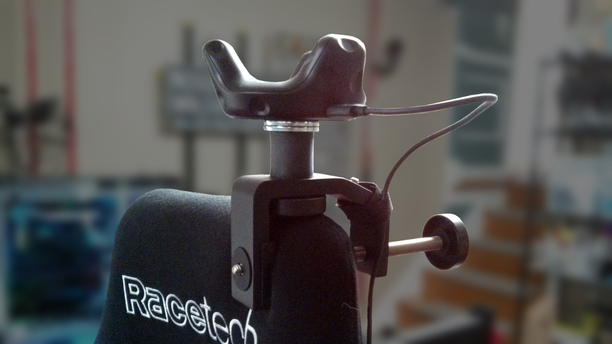

    Just wondering how these trackers and gimbals are being attached to seats? Are you using clamps? Velcro...
  11. dododge
    dododge Active Member Gold Contributor
    Mar 8, 2015
    100
    854Coins
    +72 / 0 / -0
    Camera clamp, with a 1-inch rubber isolator between the clamp and tracker. Everything is threaded 1/4-20 so it all just screws together easily.
  12. greatg67
    greatg67 Member Gold Contributor
    Aug 14, 2018
    71
    509Coins
    +8 / 1 / -0
    Thanks, did you get the parts on Ebay or Amazon?

  14. dododge
    Mar 8, 2015
    100
    854Coins
    +72 / 0 / -0
    Amazon.
    1/4-20 camera clamp. Includes a detachable swivel head. The main issue is getting one that opens wide enough for the seat back. I also had to stick a block of wood between the clamp and the seat because there's a big gap in the back under the fabric.
    1" 1/4-20 isolator. The screw shaft is too long to go into the tracker so I also stacked a couple wide 1/4" washer on there.

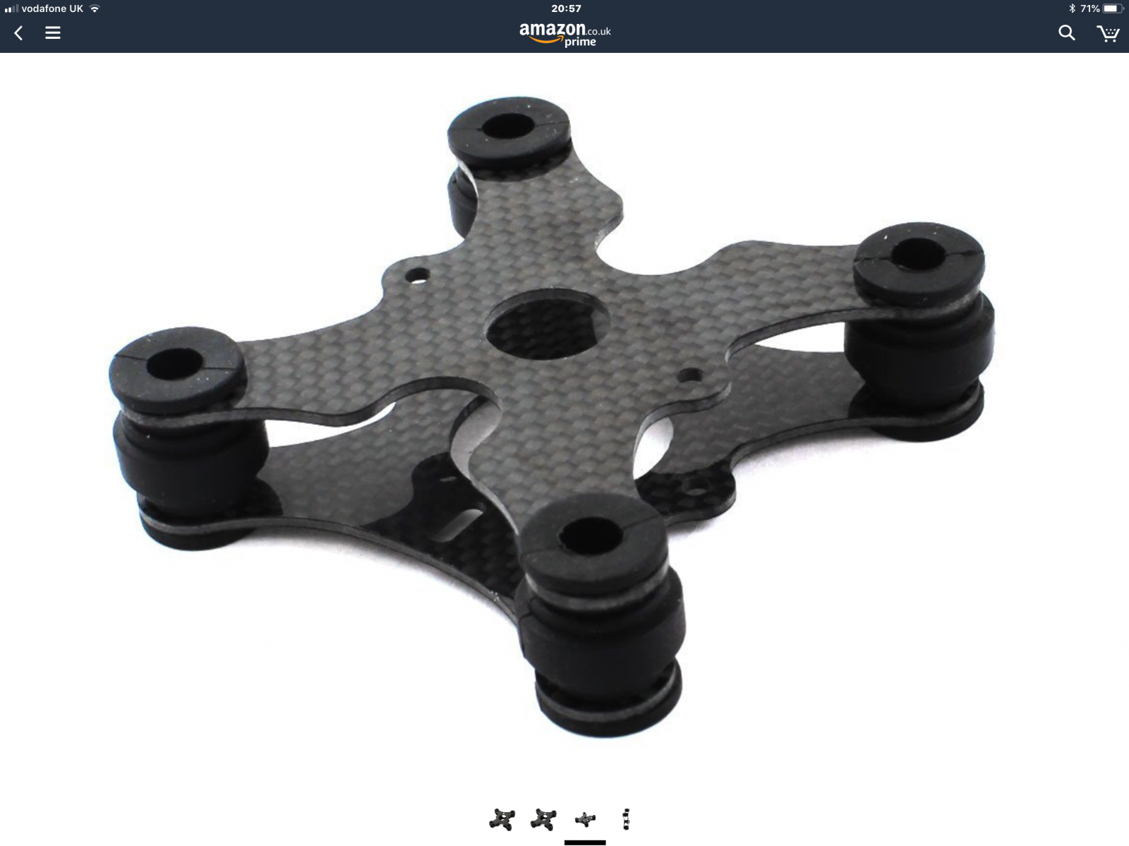

  15. JMB3D
    JMB3D Member
    Jun 1, 2018
    50
    UK
    689Coins
    +31 / 0 / -0
    4DOF
    Thanks, point taken.
    I’ve opted to try out this, 15 quid of amazon, I will let you know if it helps.

  16. RiftFlyer
    RiftFlyer Active Member Gold Contributor
    Apr 15, 2014
    198
    1,711Coins
    +121 / 0 / -0
    DC motor
    Having spent a lot of time doing aerial photography and video with rc helicopters in the past I can tell you that vibration isolation is a tricky subject. There are a huge number of variables. Frequency and amplitude of the vibrations, mass of the load, elasticity of the dampers etc... if you want there are lots of things to try and tune the vibrations with the pad you linked above. You can add extra weight, fill the rubber boots with silicone, mount it with gyro tape or gyro gel pads (rc hobby store) or use bolts and washers to compress the rubber doughnuts. All of this will change its absorption properties. There is an iPhone app which graphs vibrations on the screen. You could use that to help get an idea of the vibrations of your platform while tuning.
    The big thing to avoid is causing the vibrations to increase in amplitude due to the isolation being too flexible.
