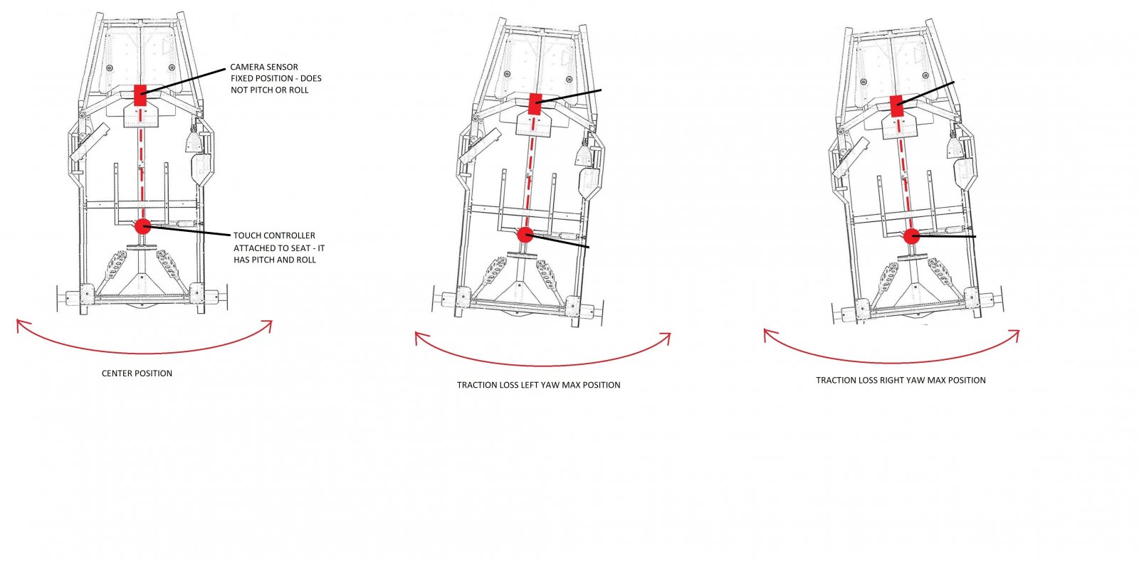

    Tested and not working. It is as I suspected, when the camera is moving/ especially tilting/rolling, the Oculus seems to reset the pose / viewscreen. Unless using a Gimbal stand as seattime, it doesn't work.

  15. ANiMESoKAR
    ANiMESoKAR Member
    May 27, 2016
    44
    Australia
    365Coins
    3DOF, SCN5
    Thanks for testing. Did you try just turning the camera left or right on it's spot? As if the camera was in a fixed position and is simulating moving left or right with the whole frame for Traction Loss.
    I've got a 3DOF Simx Simulator (Seat Mover) and the cockpit frame moves on top of the Traction Loss base. Only my seat has pitch and roll which the Touch Controller will be mounted to.
    I've attached a picture to show what I mean. Hopefully this makes more sense. My thinking behind it is the Camera is always in a stationary fixed position moving in the same frame as the Touch Controller when using Traction Loss yaw. It shouldn't lose the Touch Controller as it never leaves it Line of Sight. SIM OR SENSOR.jpg
