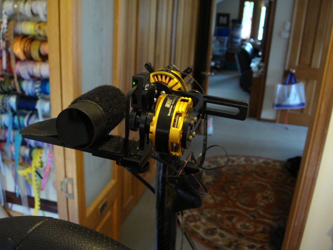

  18. SeatTime
    2,573
    When the motion cancellation software stopped working due to a steam update. I mounted my camera back to a gyro-stabilised mount. Picture below from when it was fitted to my old rig. I have never seen a black line yaw issue on my sim, but it does not move that much in yaw - not necessary on my sim.

  19. ANiMESoKAR
    ANiMESoKAR Member
    May 27, 2016
    44
    Australia
    365Coins
    3DOF, SCN5
    That's awesome! Got any info on how to build the gyro?
    So you're not using the Motion Cancellation Software at all now? I thought some guys were running the older version to keep using the software.
    I've got a 150mm SCN5 traction loss so the movement is quite a decent amount. Just trying to figure out my best option before I go spending money on this setup. If I can't use my traction loss then I might pass until it's implemented properly with no black lines.
    Maybe if I use a gyro setup like yours mounted on the rig in collaboration with the Motion Cancellation Software (if it still works) with a touch controller on the seat that might be the best way to go?
  20. SeatTime
    2,573
    It's a camera Gyro - came as a kit of parts. I have a 6DOF so it can move quite a bit - have never had too many issues. I could not stay with the older version of Steam, as some of my Games would not work properly.
