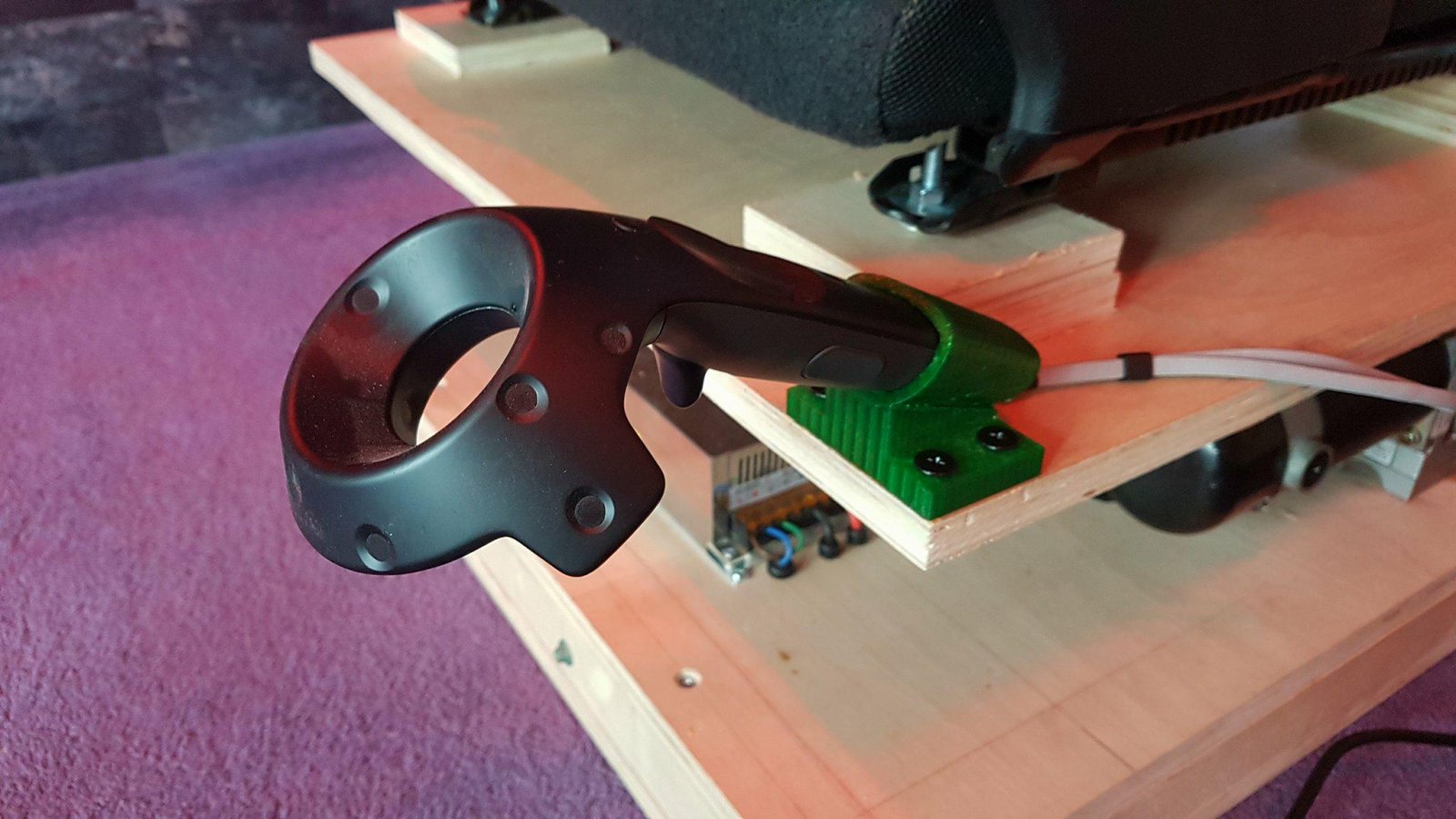

    Ok,
    So I got the input emulator working, I re-installed it and also opted out of the Steam Beta. Not sure which one fixed it but it is now working.
    I currently set the motion compensation to "Set Zero" is that the best one for my setup?
    Here is a photo of my Vive controller mount, If anyone wants it then let me know and I'll stick it on Thingiverse or attach it here.
    Matt.

    From what I have read it depends on what mode you choose. If you select the Use Reference Tracker then you need it mounted close to your head, but apparently with the other modes this is not needed?
    It seems to be working pretty well now where it is but I don't know the difference between the rest of the modes.

    I have actually moved my controllers higher now. It was working most of the time connected to the base, but every now and again it was losing tracking as it was completely hidden from one base station and quite a distance from the other one. I have managed to mount it near my head so it gets better visibility and can also use it as the reference controller.

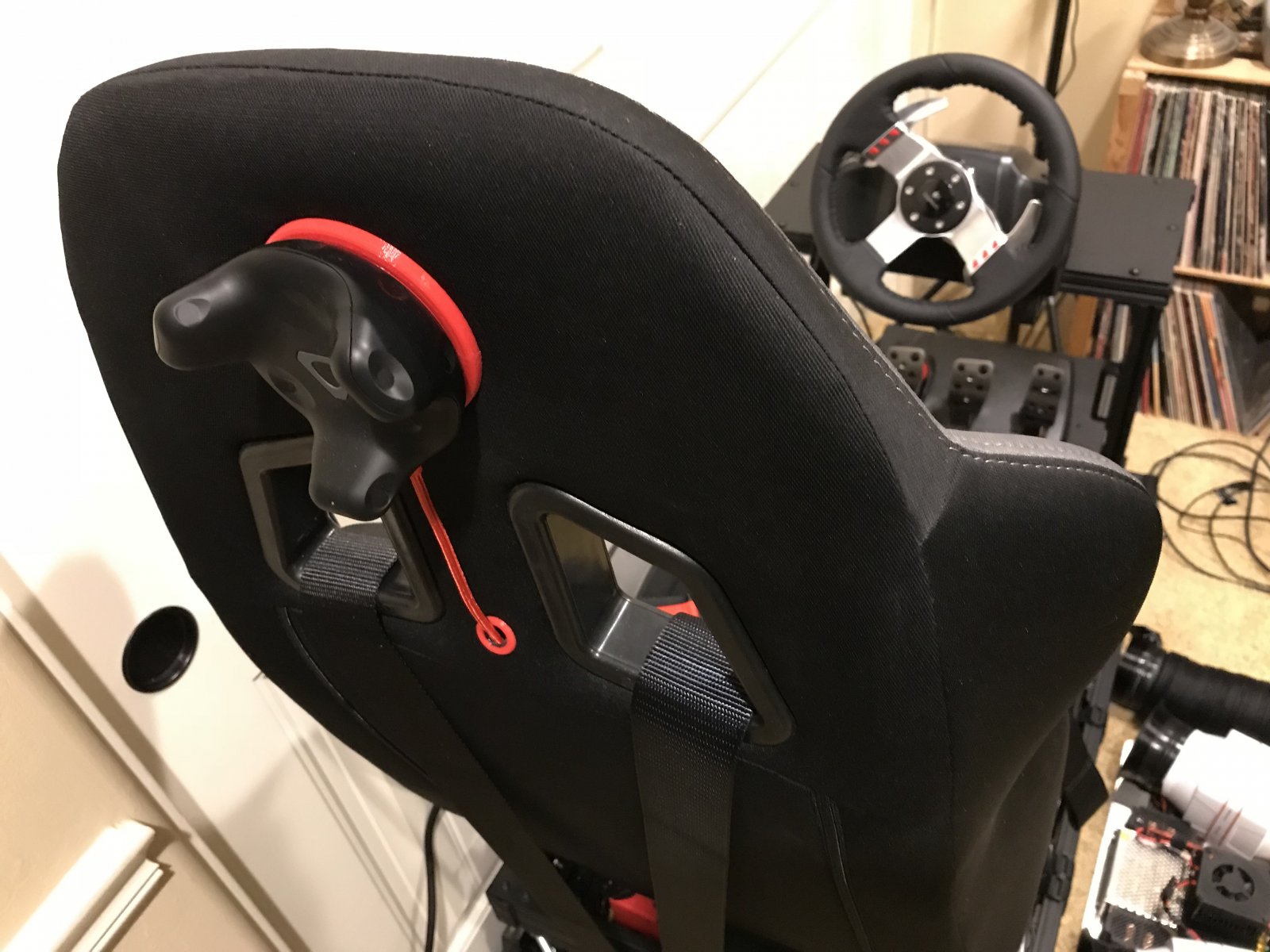

    Motion Cancellation with the Vive and Vive Tracker - a Tracker Mount
