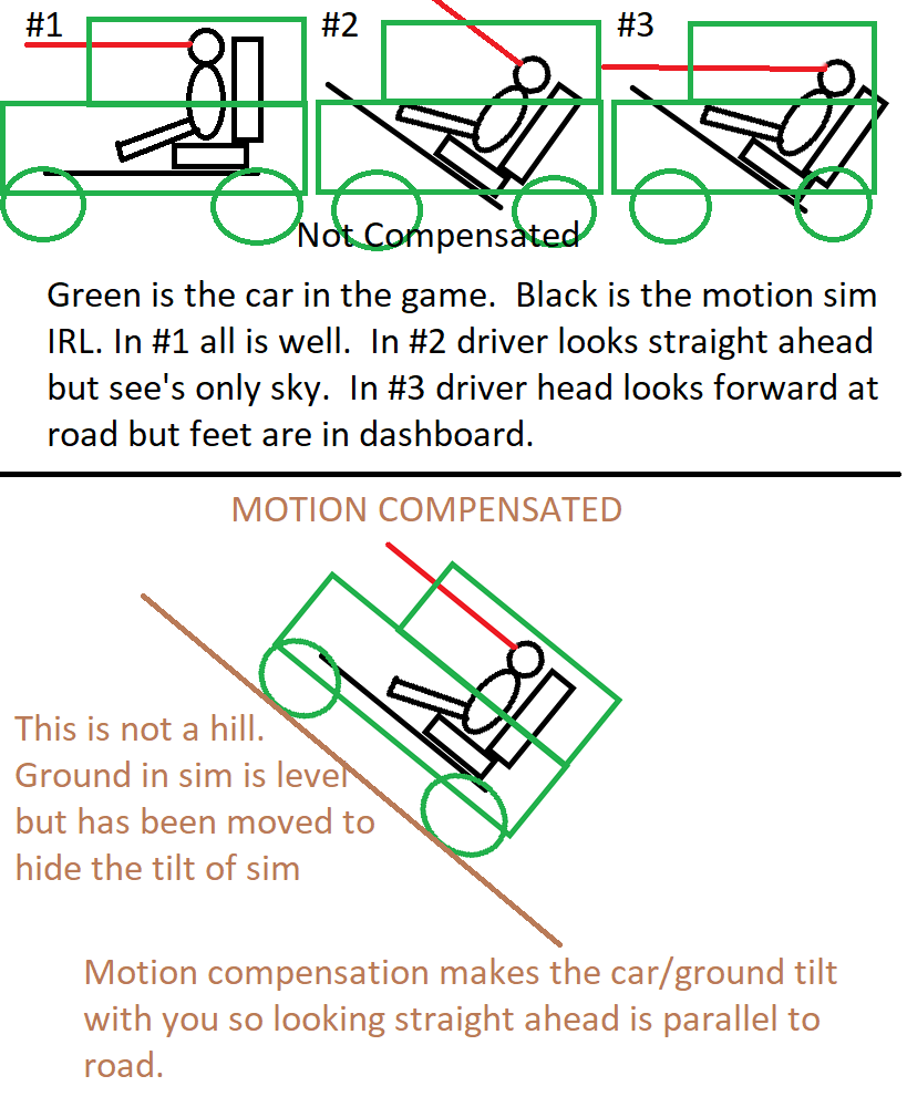

    @prodigy I will explain as simply as I can. I will give an example or two.
    With the motion simulator when you accelerate hard the sim tilts backward to simulate acceleration. Without Motion cancellation the VR software see's that your head tilted to look upward. Your head actually automatically tilts down to compensate BUT your feet are now in the dashboard instead of down on the floor!
    Same thing goes for roll and yaw. Translational movement on sims that have it is even a much bigger problem. Without any solution at all for this when I go over a bump my head goes through the roof, or down on the floor of the car!
    Behold my epic art skills! (see attachment for a really bad diagram I made)
