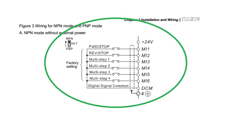

    As stated before ...
    All you will need for wiring a VFD to control a motor is :
    -the pwm signal wire for motor No.1 called PWM1 .
    -the two direction signal wires for the same motor [ M1D1 & M1D2 ] .
    -the ground .
    For converting the PWM1 coming from your controller to a V1 (0-10v analog signal) a separate 2 wires also will come out of it to > the VFD ... you have to make a small circuit as @yobuddy suggested earlier in this post
    and the required circuit I'm talking about is the PWM to Analog~EZ ...
    As I'll always refer it's originality in this forum to his scoop :cheers ... Sorry first post always win

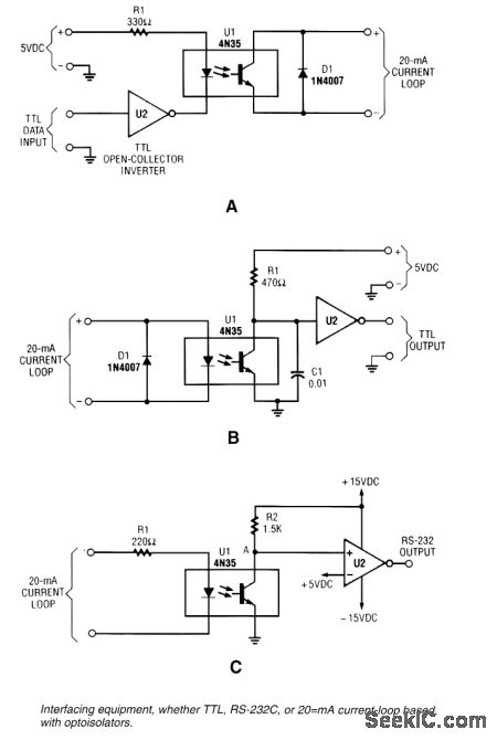

    As I added optical coupling and a schmitt trigger inverter 74HC14 for signal shape correction ...
    plus some input/output connection modifications to fit the Sim Axe controller ...
    I made three of it to my controller as it performs that conversion instantly and effectively ...:thumbs
    This circuit is already tested in my Sim if you need to see it in action (see below link ) ... and for SimAxe compatibility just moved the components to fit in one board ...
    Now I suggest that we are going to use a PNP stander in all VFDs ... so we don't have to change transistors and the connection will be without any external power ... except the 12-15v for this board .

    @Martin van Hagen ... Exactly that ... and it is pin to pin compatible with SimAxe controller as is ... Or you have to correctly wire it to the Arduino Or even the old AMC 1.5 or the 1.6 with @prilad FW.
    And please note that it is for 2 DOF motors :
    - Connect both grounds on each side respectively to there source ... Never combine the ground from the controller with the ground of the 12-15v supply side of the board ... keep them separated as they belong .
    - Always use shielded cables for both sides and keep this board and the controller away as much as you can from the VFD's to avoid interference .(audio cables are perfect)
    - Be sure that you're using the PNP connection type settings in the VFD .
    - V1 / P1d1 / P1d2 are for motor 1 connected to VFD1 ... and so for VFD2 .
