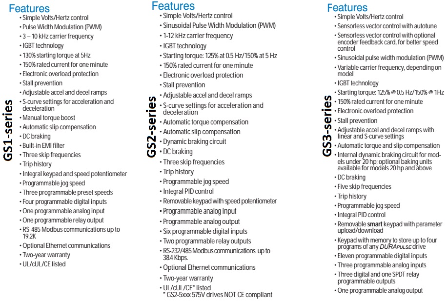

    Speedy and ALL,
    Find attached the list of "Features" for my VFD - the list you posted with "check-marks" and asked IF I had any questions...........
    I answered them to the best of what I could find.....please expound on these - (Please keep "bitching / ranting & raving" to a minimum)
    Let's see if I got any of them right????
    Thanks,
    Tom

    • Simple volts/Hertz control : that is the new advanced strategy that inverters use for controlling AC motors ... as the input side will be an analog voltage signal and the output side will be output frequency ... the older one is Scalar control ...
    • Pulse Width Modulation (PWM) : that is the methodology of the internal control of each drive with additional modifications/stages in each model for additional features for speed control ... like modification made to the PWM to be Sinusoidal PWM and the additional vector control technology and its additional Feedback card ...

    Hi Speedy,
    In my .pdf, reply 106 - Were my answers fairly correct the way I answered them??
    Thanks so much,
    Have a blessed one,
    Tom

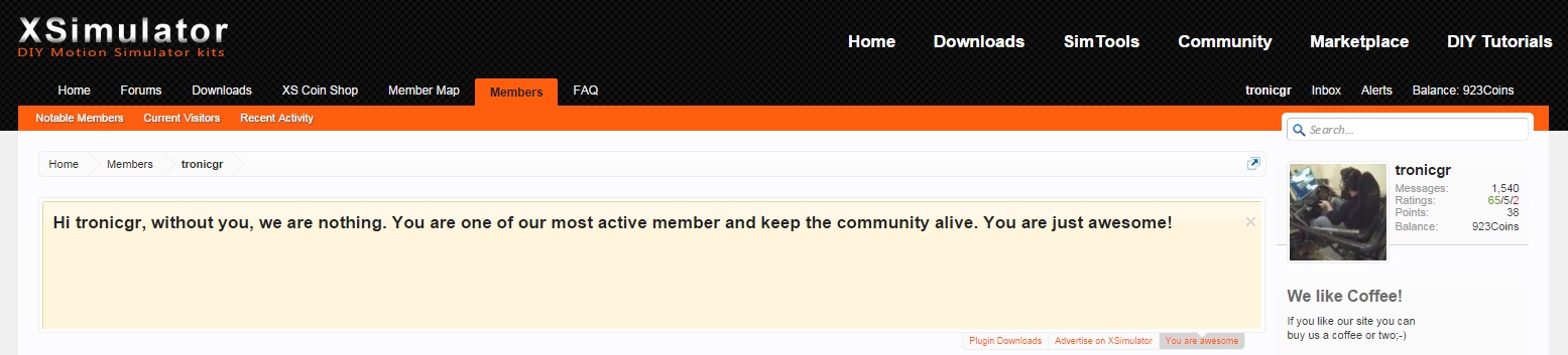

  17. tronicgr
    tronicgr
    Here is another funny picture I see every time I visit here:
    Lol... really?
