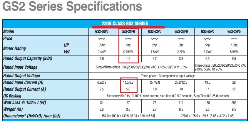

    what is your motor ratings again ? do you still have that photo of the nameplate ?
    but as a start the GS2-21P0 is more than enough for a 1HP 3phase motor .
    In general it is importent to choose the device input voltage that matches the power grid ratings ... for Tom live in the USA they spare the 230v for the heavy loads ...
    note also that as per the input current stated for the single phase 230V is 11.5Amps per wire so as the output 3ph wires is 5Amps per wire ... that helps calculating the wires ratings to be used .
    and as base line current calculation ... 1mm solid copper wire can hold 3amps & for the twisted copper holds 4 Amps ... wire thickness calculation is done for 120-130% of the actual passing current

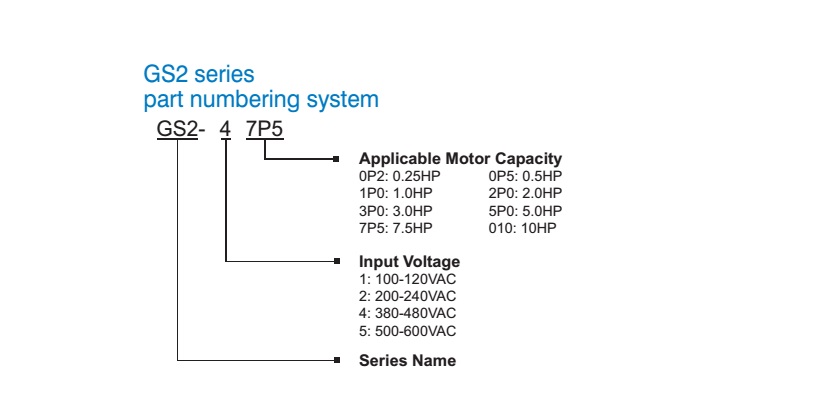

    If your motors rated to run 230V 3ph ... So why not the GS1-21P0 ... why more when less is very good ?

    Hello Speedy,
    Thanks for the informative reply.
    IN reply #23, of this topic, (way back) you have a picture of my motor - It's the Automation Directs' - MicroMax Inverter Duty, 1 HP - 230V 3Phase - I DO remember sending you a pic of my name plate - WAY back, with what I was tentatively use in way of VFD - (thought it was in this topic, but I can't find it) - You sent back and said my equipment was "great" and I would have no issues with what I had purchased.
    I will be more than happy to send a photo again if you need one?
    http://www.automationdirect.com/adc...25_-_100HP)/Marathon_MicroMAX_(0.25HP_to_10HP)
    http://www.automationdirect.com/adc...00HP)/Marathon_MicroMAX_(0.25HP_to_10HP)/Y364
    ON THE VFD'S -
    IF you are giving your "blessings" for the GS1-21P0 versus the GS2 / or / the Sensorless GS3 Series - Then that's what I will go with. "ME" thought that in reply #79 , you said the Sensorless would have advantages - maybe I misunderstood - I just want the best - That WILL do the job - I definitely don't need 12 cylinders to go just 30 mph.
    Let me know and I can proceed with purchases.
    Thanks so much for your help and information.
    Have a blessed one.
    Tom

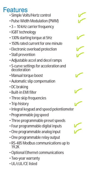

    I apologize for the "mis-quote" - I have re-read and I misunderstood what was being said and what was being clarified......DUH!!
    OK - Sensorless is out - "me" have wrong kind of motors for proper use of a sensorless VFD...........done deal!
    Do "you" see much difference in the GS1 & GS2 Series - "for my purposes"......I've looked at and cannot tell what the differences are - but I'm sure there are -
    Have all my other stuff - Just have to get the VFD's - and then the SimAxe Boards or whatever we're going to use, and that should "wrap-up" the expenditures for hardware.
    Thank you sir and I "stand corrected".
    Tom

    Tom ... If you're comfortable with this company and as you say that you can get good prices from them ... Then after reading the online manuals comparing for what we exactly need ... Yes ... That GS1-21P0 Is defiantly the perfect inverter for your platform without any/any kind of leaking in performance and additional fancy options like the removable key bad with memory on the GS2/GS3 series ... in fact combining it with the your Good/powerful motors gearbox you'll get exactly what you've been planing for in good ,smooth ,maintenance free , efficiency , ... so help you God ...
    I it has it all and more
    OOPS ... check on the automatic slip compensation too ... Edit :that is the "internal Rascal " how can I forget it ?:rolleyes:

    GREAT!!!!!!!!!!!!!!!!!!!!!!!!!!!!!!!!!!!!!!!!!!!!!!!!!!!
    Speedy, good ol' bud, EXACTLY what I wanted and "needed to hear""".......you're a blessing to this ol' guy.... THANK YOU!
    AND it's "perfect for my application" - Get's no better endorsement than that - AND I can save some money too....
    PS - You probably don't remember (probably do) way back, several months ago when I just started reading your VFD Thread - You had mentioned that a person only has to increase the frequency up to like 85 in
    order to make the "sim" faster - One of the members was saying something to the fact that a VFD had better be able to go to 400 hz, IF you wanted to simulate racing - and your rebuttal was up to 85 would
    get the job done...............that's what I was looking at - of course, both GS1 and GS2 will go up to 400% - no big deal since we'll never have to go that high. NOW, if I have said something "out of context" about this,
    then just blame it on my age and dementia.

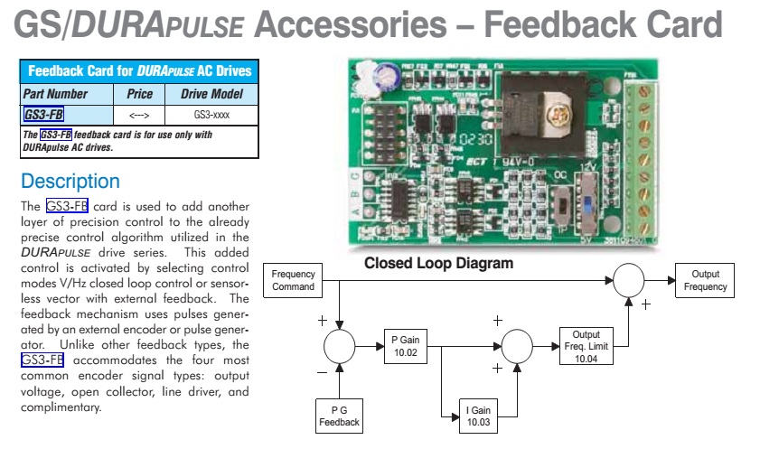

    OK ... Nice feeling indeed ... and to put every thing to bed and make it clear for every one ... I don't like loose ends at least without isolation ... it may cause fire .
    Dear @FarmBoy ... here they are talking about adding a feed back card GS3-FB ...
    quoted from the below manual file ...
    Between the lines , you may find it is obviously clear that these layers of control are talking about something in common ... which is the speed control algorithm .
    and clearly they want to sell ... they give you the photo of the Feedback card with the RPM meter model ... the type of encoder used is also a very good clue for speed detectors with this digital counter FB card ... they write a Feedback Card in bold ... but not for position control ... May be I see you convinced now .

    Wow - you and FarmBoy are talking WAY Past my conceptual understanding. These VFD "Rascals" are something else............
    "Me" thinks I'll leave it at "controlling" my platform and not trying to build a clock....I just had NO idea how complex a VFD was....

    Yes, I have bunches of questions, but I'm just tired Speedy. I'm going to Google the parameters you have checked off, and then ask pertinent questions, tomorrow.
    And YES, there is one thing I did understand on the check-off list - IT has a 2 Year Warranty!
    Talk with you tomorrow. Thanks friend.

    1. Sensorless VSD's are for speed control and not postitional control. That is without the feedback card mentioned in #90.
    2. The drive mentioned in #93 seems like a normal V/F drive. How much torque is actually required?
