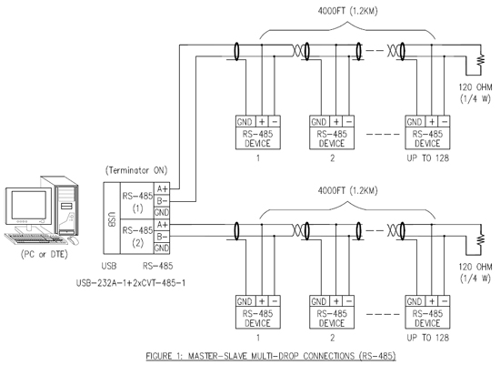

    AC motor
    Most VSD have RS485 communication available. It is therefore possible to terminate only the sensor you are using for positional feedback. Initiating the drive and sending it feedback from the PC and letting the drives do all the PID control technically the correct way of doing things.
    Everyone seems to be using an external controller to send analog feedback to the drives and I am wondering why that is so? Most drives make use of a protocol called modbus and it doesn't look like simtools generates a CRC checksum yet to make modbus available from the PC end, but the code is freely available and t will make Simtools very dynamic to be used with VSD's.
    Has anyone else thought about this?

  16. speedy
    speedy Well-Known Member
    Feb 1, 2012
    1,193
    Alexandria , Egypt
    7,918Coins
    +1,285 / 10 / -0
    Hi @FarmBoy Yes and Nice for simple ON/OFF and some simple command for industrial motors alarm monitoring ... but I guess very Old and very very slow for real time motion simulation ... it was an invention before the USB ... not all the VFDs now have it " kind of obsolete addition " or comes as separate ADD ON card .
    http://en.wikipedia.org/wiki/Modbus
    edit : But actually this is strange the USB-RS485 converters now can send up to 2Mbps like the SCN5 ... so help investigate this more ... and give @yobuddy what is needed .

    Thanks Tom for supporting the thread while me too have a " Flu " ... any important update will be posted accordingly ... but here are some first annoying results .:(
    First ... It seems that there are no stander language that VFDs internal FW are using to communicate with there special designed SW on the control computer ... plus each company is using there own control PLC devices ...
    Second ... Even the Modbus RTU of some VFDs seems promising in it's data speed ... they are using such PID control for " Open Loop speed control " without FB sensors ... OK where would the error in motion will be calculated ? ...
    Even If position error is not the issue ... Motion Simulators are using a "closed loop position control " with FB sensors ... Lot of data IN and OUT for each device which expected to be connected with other VFDs in a daisy chain connection to the USB-RS485 converter like this ... so there is a very good chance that data lagging in time will happen ...
    it seems like there are a lot of disadvantages to be found in this ... Sorry @FarmBoy .

    Is this the VSD you will be getting:
    http://www.automationdirect.com/adc...ts_(115_-z-_230_-z-_460_-z-_575_VAC)/GS2-11P0
    It is my understanding that vector-flux control is very important for our type of application. Now dont get me wrong, you will get motion from what you are about to do. You might want to consider getting braking resistors to get rid of the regenerative energy and help with startup torque.
    @abto_tohan
    You are right that modbus is an old protocol, but it survived until today because it is stable and that is why i am considering it.
    Regarding your error calculation, please take a look at the datasheet of the above VSD. Under parameter P7.02 one can select keypad or Serial communication, after selecting serial communication and setting up the rest of the drive - you will need to let the PC know what register to dump the setpoint in. Motor feedback is directly connected to the drive.
    The VSD above, in my opinion, was not designed for a simulator type op application. It is a good VSD to attach to your lathe or change the speed of your swimming pool pump, but because it only has one analog input and the way that they have setup the PID control into the drive - I dont think they really want the user to change the direction of the motor very frequently. Perhaps its because it doesn't have vector-flux control to know when it is safe to do so.
    I have experience with modbus and i am also still in two minds about it but only because i haven't tested it in an application like this. Here are my thoughts:
    Why should modbus be considered?
    1. Independent PID control for each motor.
    2. You get to supply a 16bit setpoint error from the PC. Great scope of movement.
    3. Allot less wiring and components. Fault finding and setting up will be quick because of serial software available to monitor serial ports.
    4. Modbus is easy to learn and understand. All the code for it is available for free online. CRC16 is typically used if you were wondering.
    5. Most, if not all VSD will use modbus. I think it is cheaper to implement than Profibus or some other protocols.
    6. The layout of modbus is similar for commands send. The only difference one might get is the write command and address of register, but the rest of the message stays the same. For example: 01 05 0C 00 00 02 4B 37 ; So 05 is the write command to this VSD but for other VSD's it might be 16 instead of 05. Also 0C 00 is the location of the register where we are dumping in our PID setpoint of 00 02, every make of VSD will allocate a different register for PID reference value. 4B 37 is the CRC16 checksum. Perhaps from the simtools one could say <01><05><0C><00><axis1>crc ; <2><5><C><0><axis2>crc;...
    One can give each drive their own address and it will detect its modbus string.
    7. High baud rates are typically available.
    Why should modbus not be considered?
    1. When a command is send to the VSD, how will it respond? Typically one will send a modbus command to a VSD or PLC and it will respond back to say that the message was received. We dont need to know if the message was received every time we send a command, we just want to dump PID onto the VSD. This will have to be tested and if it works then i will highly recommend using modbus.
    On final thought to Tom.
