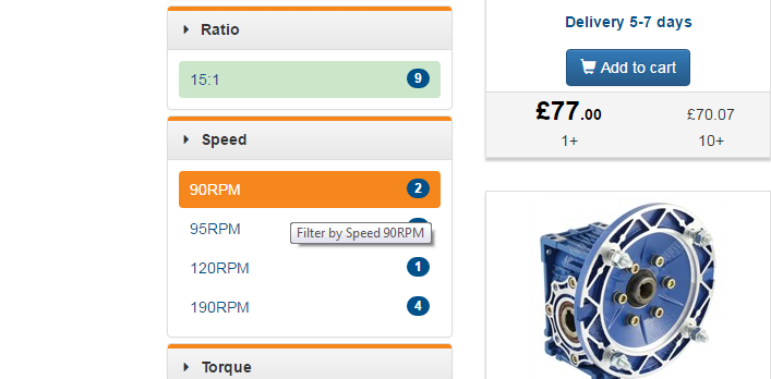

    Here is a gearbox:
    TEC FCNDK50- Right-angle Worm Gearbox for 4 Pole 80 Frame B14 Motor (motor is not included).
    Ratio: 15:1
    Output Speed: 91.3RPM for Input Speed at 1370RPM (50Hz)
    Max Output Torque: 69Nm
    Efficiency: 79%
    Max Input Power: 0.85kW for 4 pole motor.
    Output with 0.55kW 4 Pole Motor - 0.43kW x 91.3RPM at 50Hz - 45.4Nm at 1.5 Service Factor.
    Lubrication: Synthetic Oil, sealed for life and maintenance-free
    Input flange and shaft socket to suit IEC 80 Frame Motor. 19mm bore diameter, 120mm flange with 4 x M6 Tapped holes equispaced on 100mm PCD with 80mm register.
    Weight: 3.5kg
    There is another just like it, except for different mounts: Model FCNDK50
    Input flange and shaft socket to suit IEC 80 Frame Motor - 19mm bore diameter, 200mm flange with 4 x 11mm holes equispaced on 165mm PCD with 130mm register.

    But what speed?
  4. That Dude There
    That Dude There Member
    Feb 19, 2017
    57
    USA
    430Coins
    +27 / 1 / -0
    I would think, the lower speed is better, since we need to be about 25 rpm.
  5. That Dude There
    Feb 19, 2017
    57
    USA
    430Coins
    +27 / 1 / -0
    Wow you said 50:1. I don't know why I posted that 15:1 :confused:
    50:1

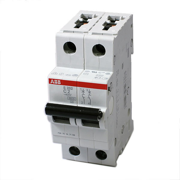

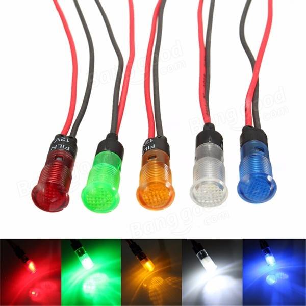

    Some Things that are necessary for any simulator ...
    Main Circuit Breaker ...

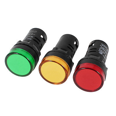

    Indicator light ... that are useful to see if you have a good power to your devices ... they comes with different voltage ratings for all operating voltages stages .
    3-Pcs-AD16-22D-S-Green-Yellow-Red-LED-Pilot-font-b-Light-b-font-font.jpg DSC00024.jpg c6cd03b8-1a6a-2cbf-9762-162fe35b4827.jpg

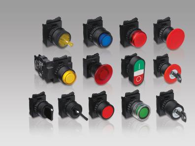

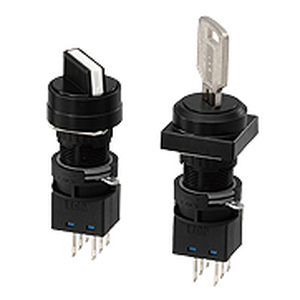

    A "Kill switch" or "Emergency switch" that a must be used with the power source of the motors or the motors driver ... some models come with indicator lamp and some of them comes with a KEY for the ON state ...
    577c05b2daffcbotões,comutadores e sinaleiros.jpg download.jpg 16475-9963801.jpg

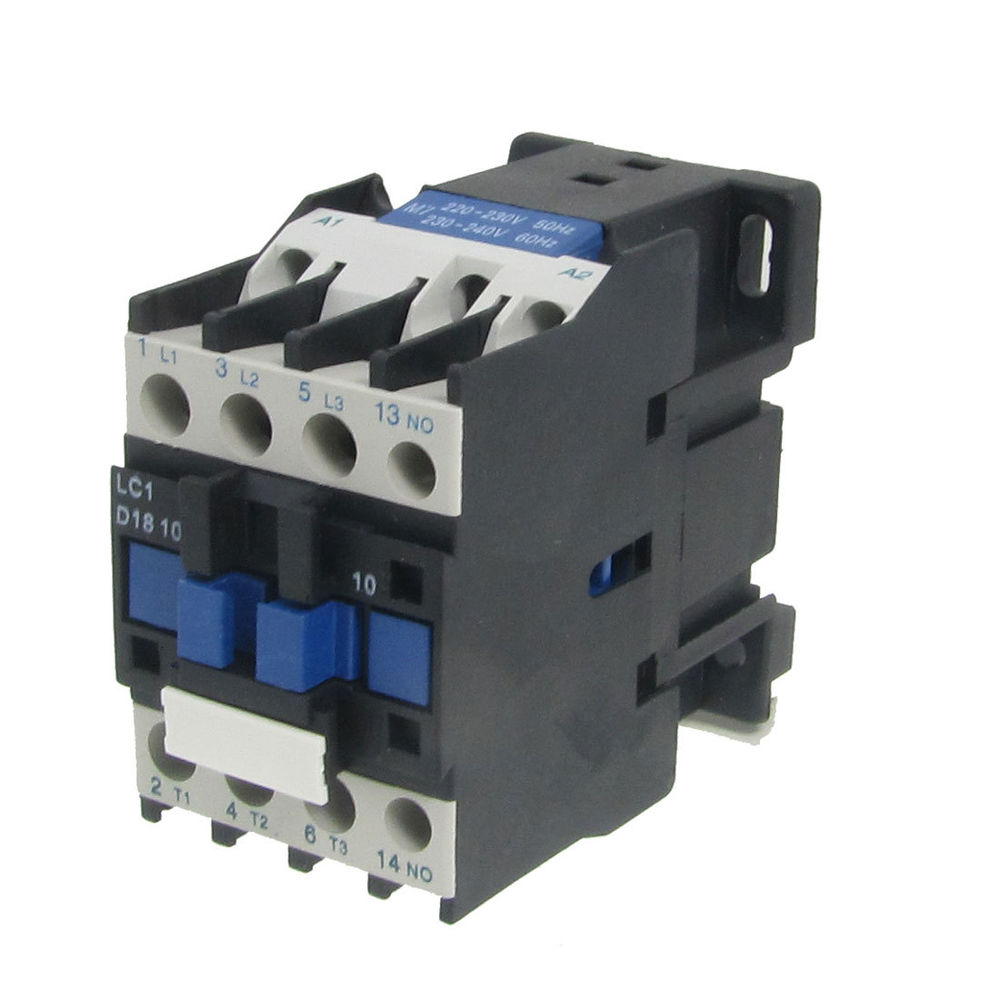

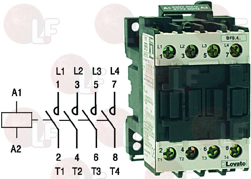

    These "Emergency switches" can provide about 3A max. for operating a CONTRACTOR like next pictures in case of using big Amps AC- voltage ... I suggest using a 220v coil [A1-A2] contactor type as it can be easily wired in parallel to the hot input without any external power supply and still gives you a full operation control .

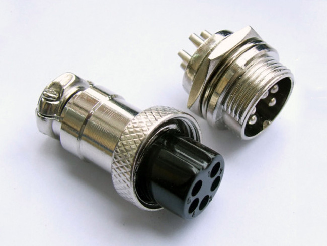

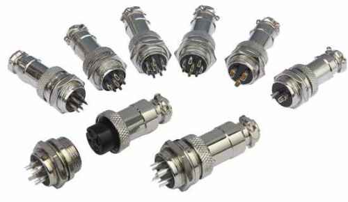

    Those Plugs are very useful and cheap ...
