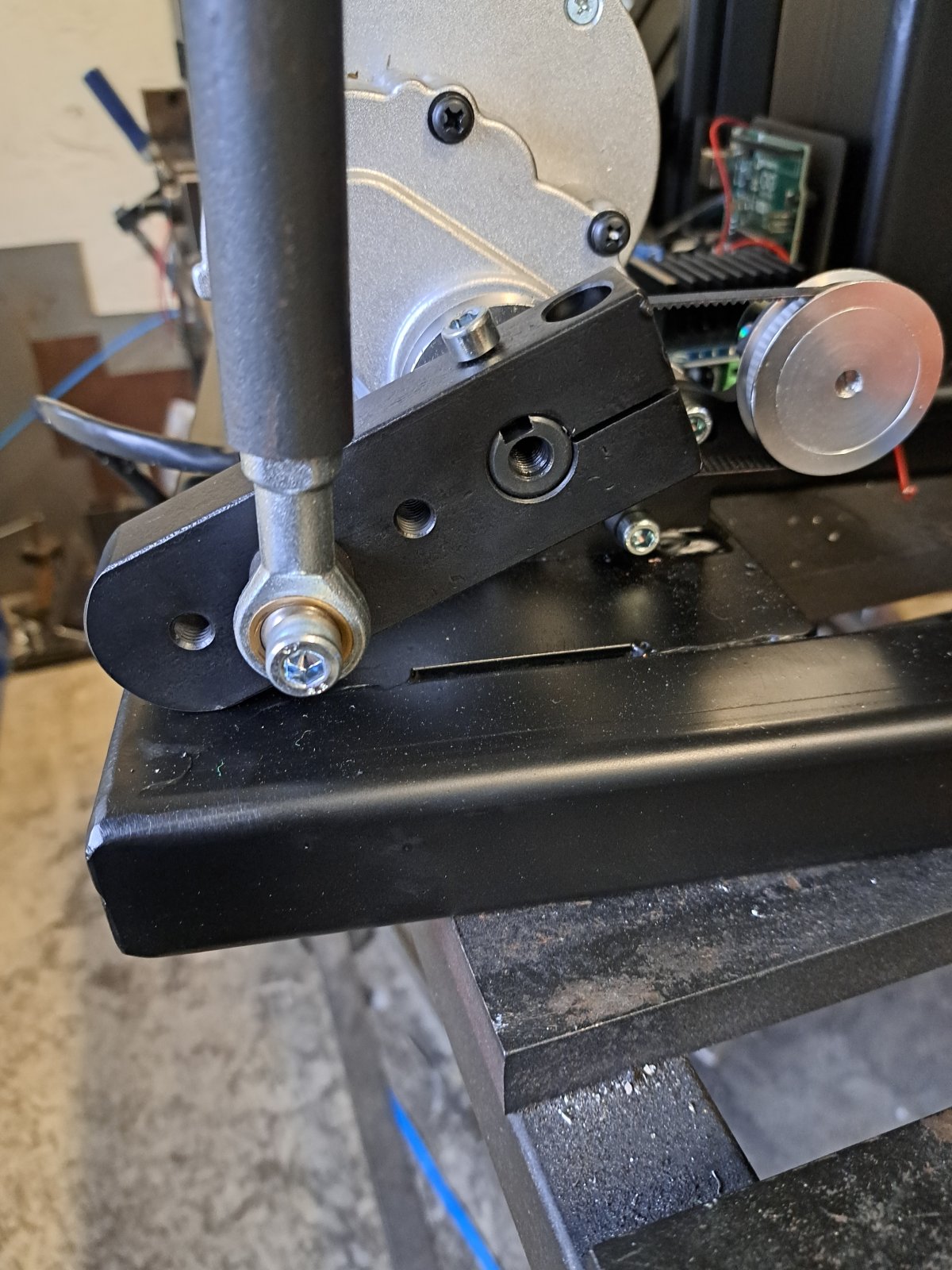

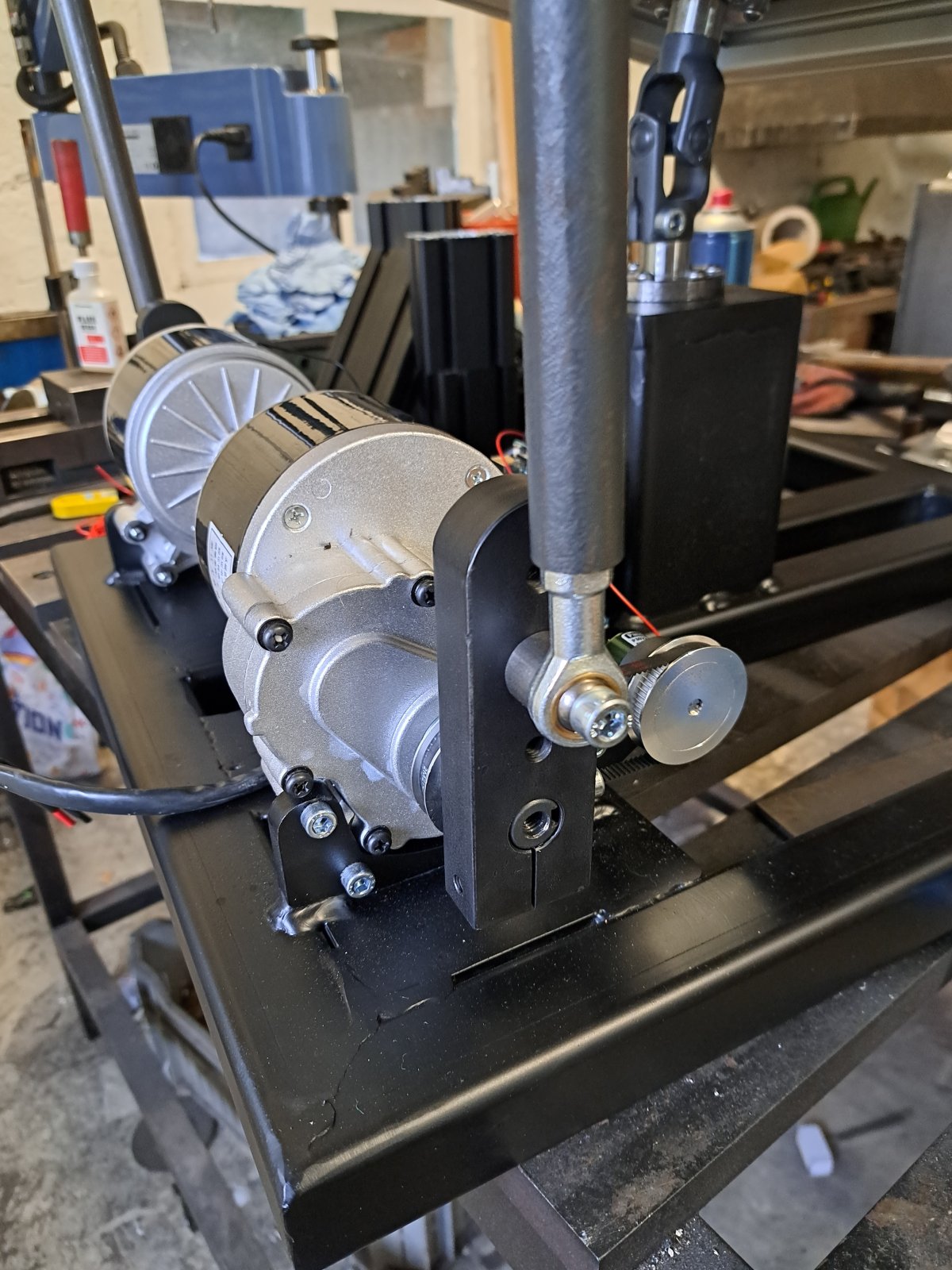

    Hi all!
    i'm currently building a 2 DOF motion sim based on the compact sim from noor beast, and also Scruck's sim. But i have encountered a "small" problem.
    My lever arms cant go down the much :sos
    Honestly i didn't even think about that when designing. Oops!
    So i'm wondering if it's okay to use the arms in a vertical "0" position? so that would be 90°
    i could also shorten them up some, but still wanna se if 90° would give problems
    i tried to look for other build to see if they do it, but it doesn't seem to be a common thing
    Looking forward to some advise!

    Physics dictates that anything over about 38-40 degrees up and down on a lever greatly reduces effective torque utilization.
    Think of it like pushing on a door, if you do so at 90 degrees on the face of the door it is pretty easy to move the door with your little finger.
    But if you try and push on the door frame it is very inefficient.
    Similarly, a vertical lever at 0 degrees is very inefficient and will place a great deal of unnecessary strain on the motors.
    Better to fix the design flaw by extending the levers past the frame.

    Yeah i was wondering that. that makes sense. Thanks!
    i think i will shorten the lever arm, should give me 50° instead of 20°

    Unfortunately, you need to improve the design, the arms for proper operation must be horizontal as the starting position and +/- 45 degrees up or down.
    I have another question, did you laser cut the motor mount ( marked with a red arrow ) ? do you have a file with a template ?
    Second question did you cut the motor arms from ordinary steel or some special alloy ?

    Yeah ur right, i messed up by making the motor mount to low, i sort of corrected it now. by cutting down the motor arm at an angle. Still not perfect but it seems to work.
    No it wasn't cut on a plasma or laser, i have a small cnc mill at home. i used that to make it. i dont know how to share the file but i would love to, wasn't that easy to get right and if it can help someone i would love to share it.
    It should work well with a laser cutter to, plasma im not sure because of the 8.5 mil hole
    i used just ordinary mild steel, that being said it is 40x20 mil so quite beefy.
