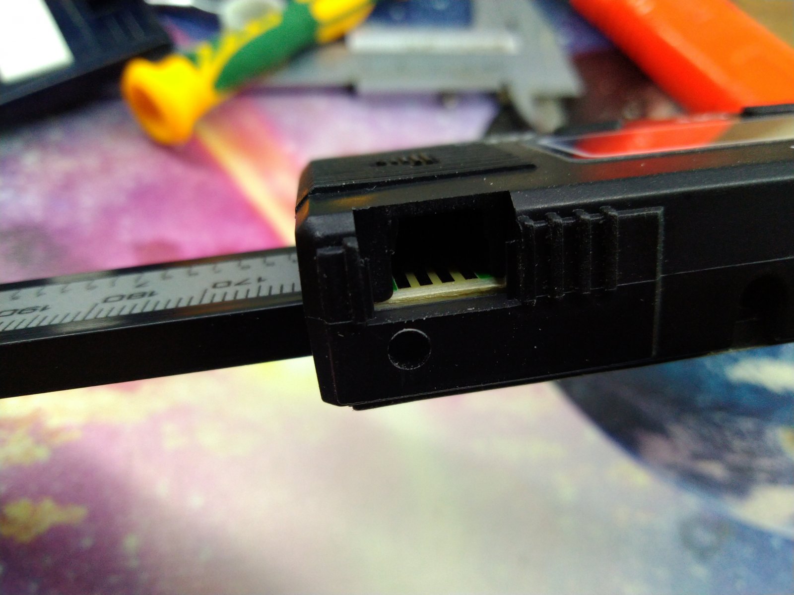

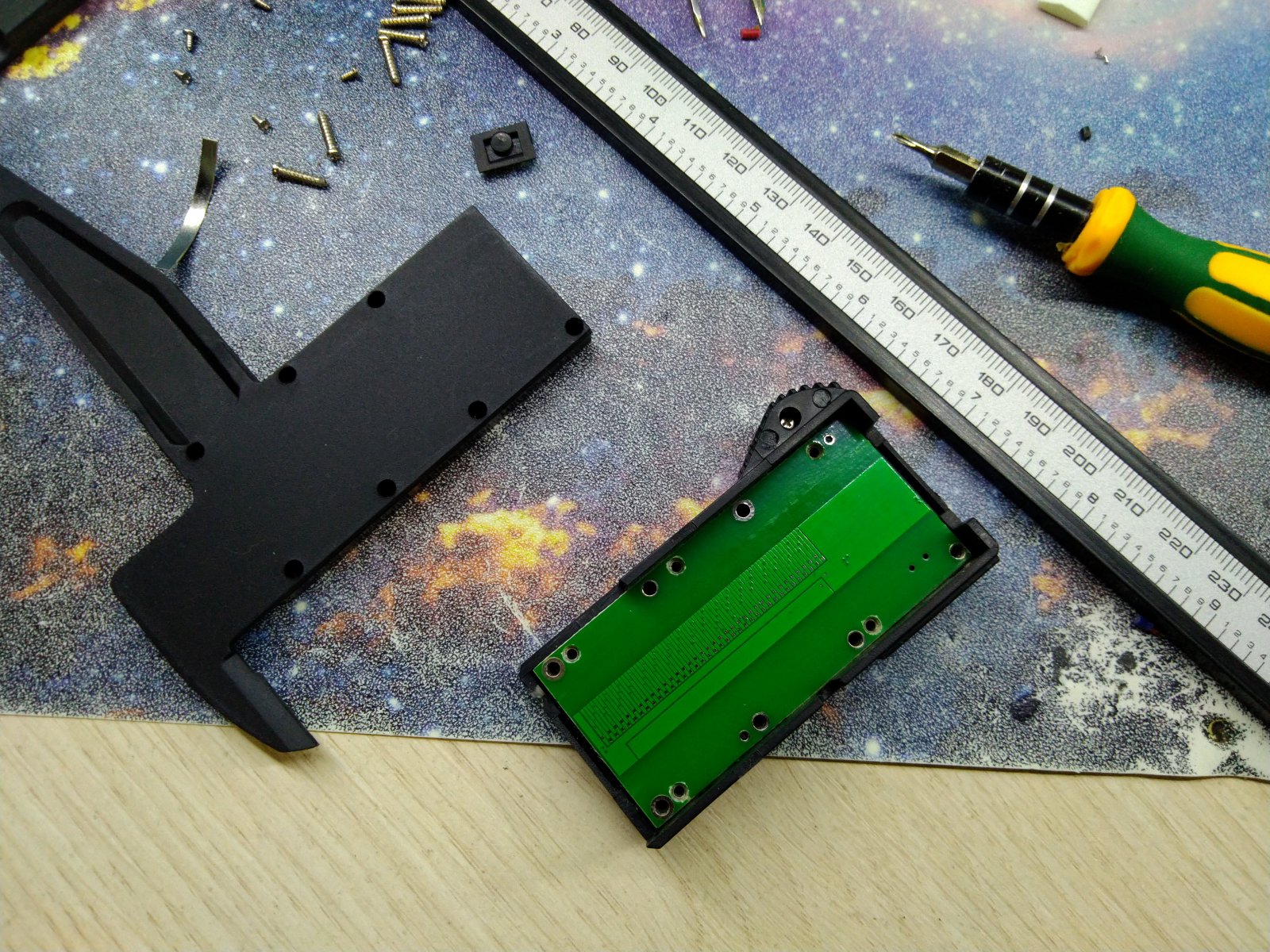

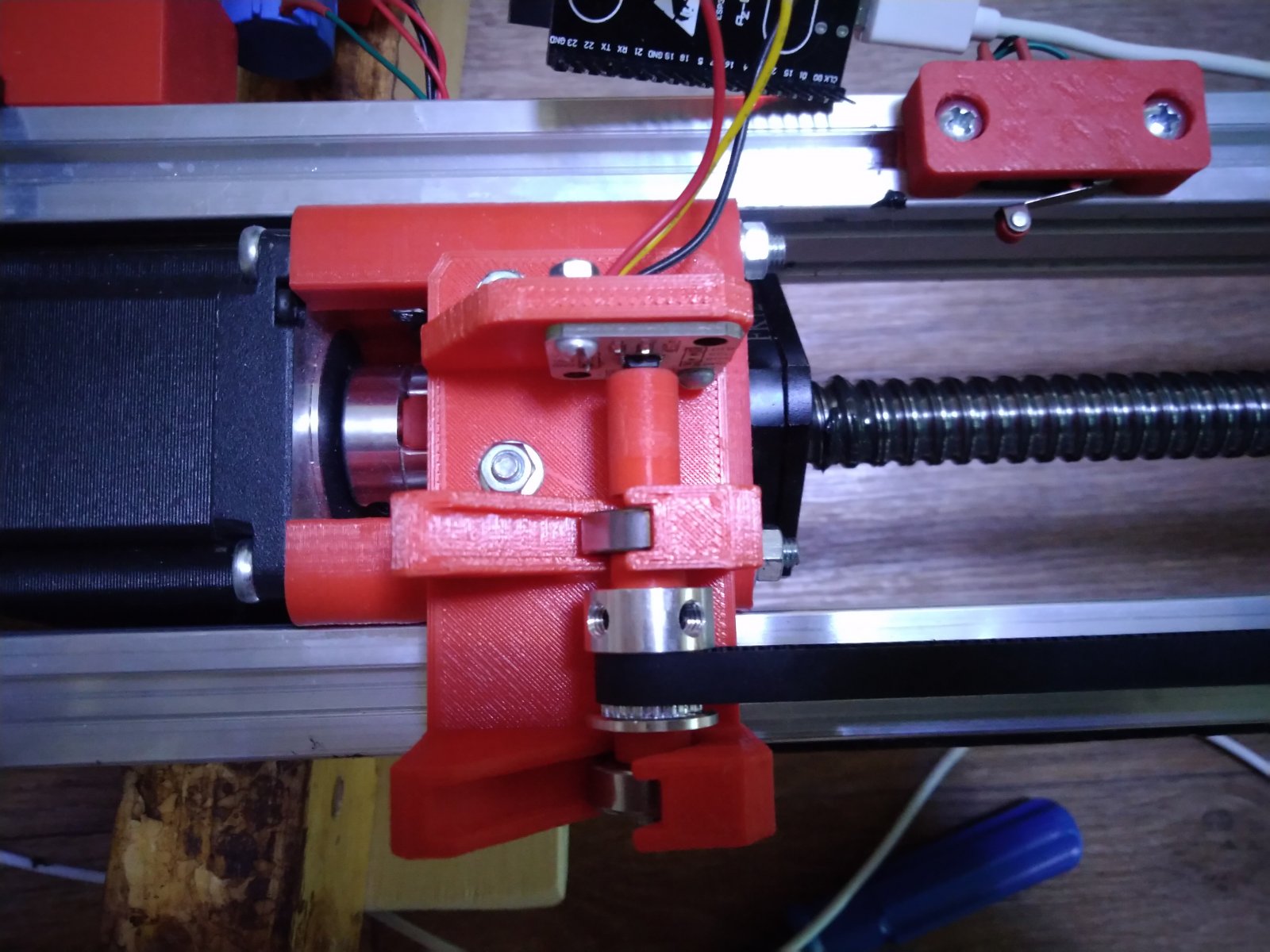

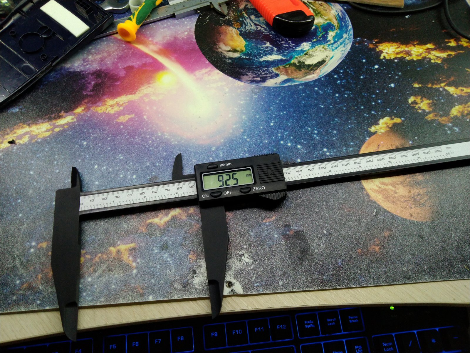

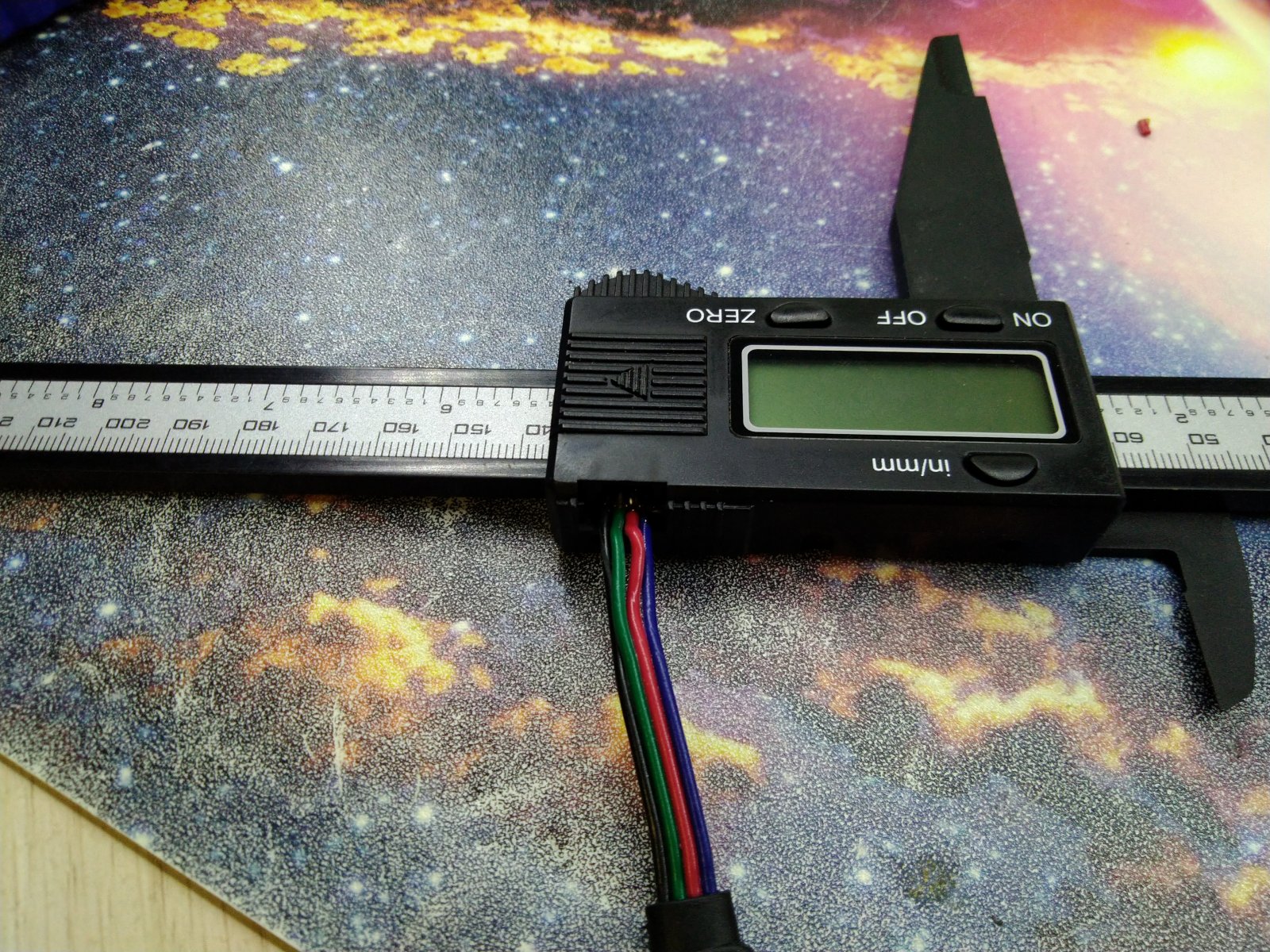

    There is such a cheap 300 mm caliper, about 12-14 euros. It has a connector for connecting to a controller (you can use an arduino). I keep thinking of using it on a linear actuator as feedback instead of a belt and a potentiometer. Maybe someone knows and tried to connect it. What is the measurement speed of it? According to the idea, you need at least 250mm / s. Or is the game not worth the candle?

    reminds me of DRO "digital read out" on cnc an lathe, there are several different dro's out there to buy

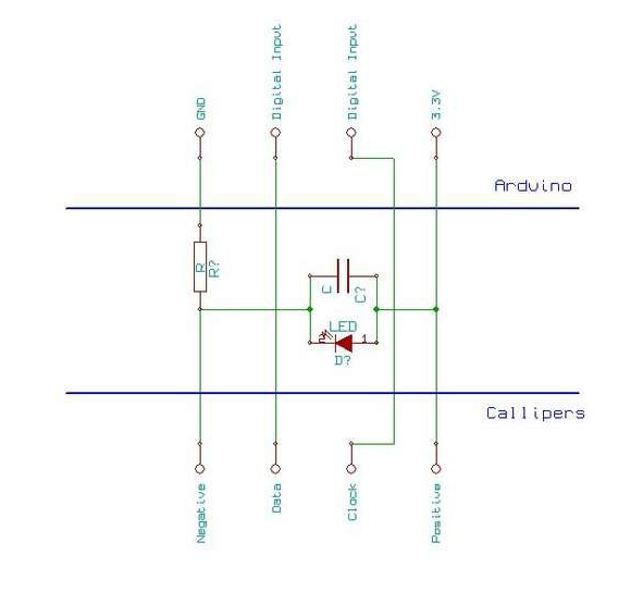

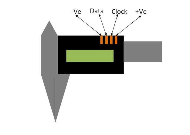

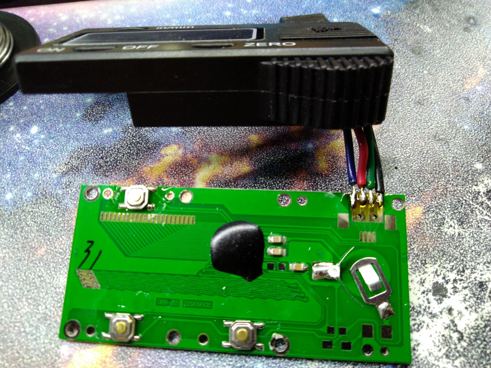

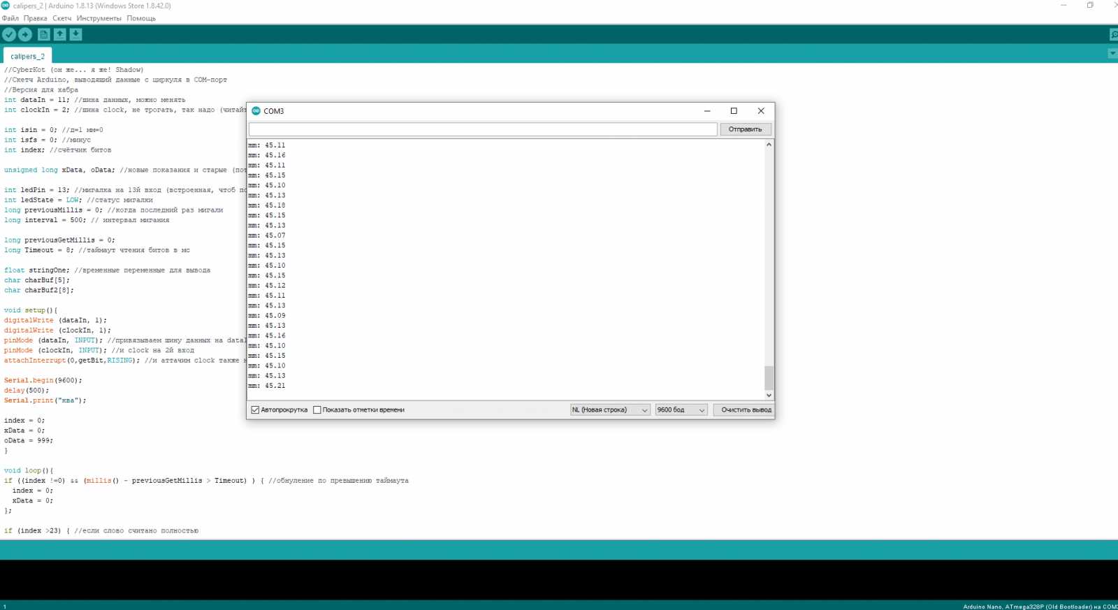

    I found on the Internet a diagram for connecting a caliper to an arduino.
    It doesn't work badly, but the data is refreshed at 3Hz (300ms), which is very little for a linear drive.

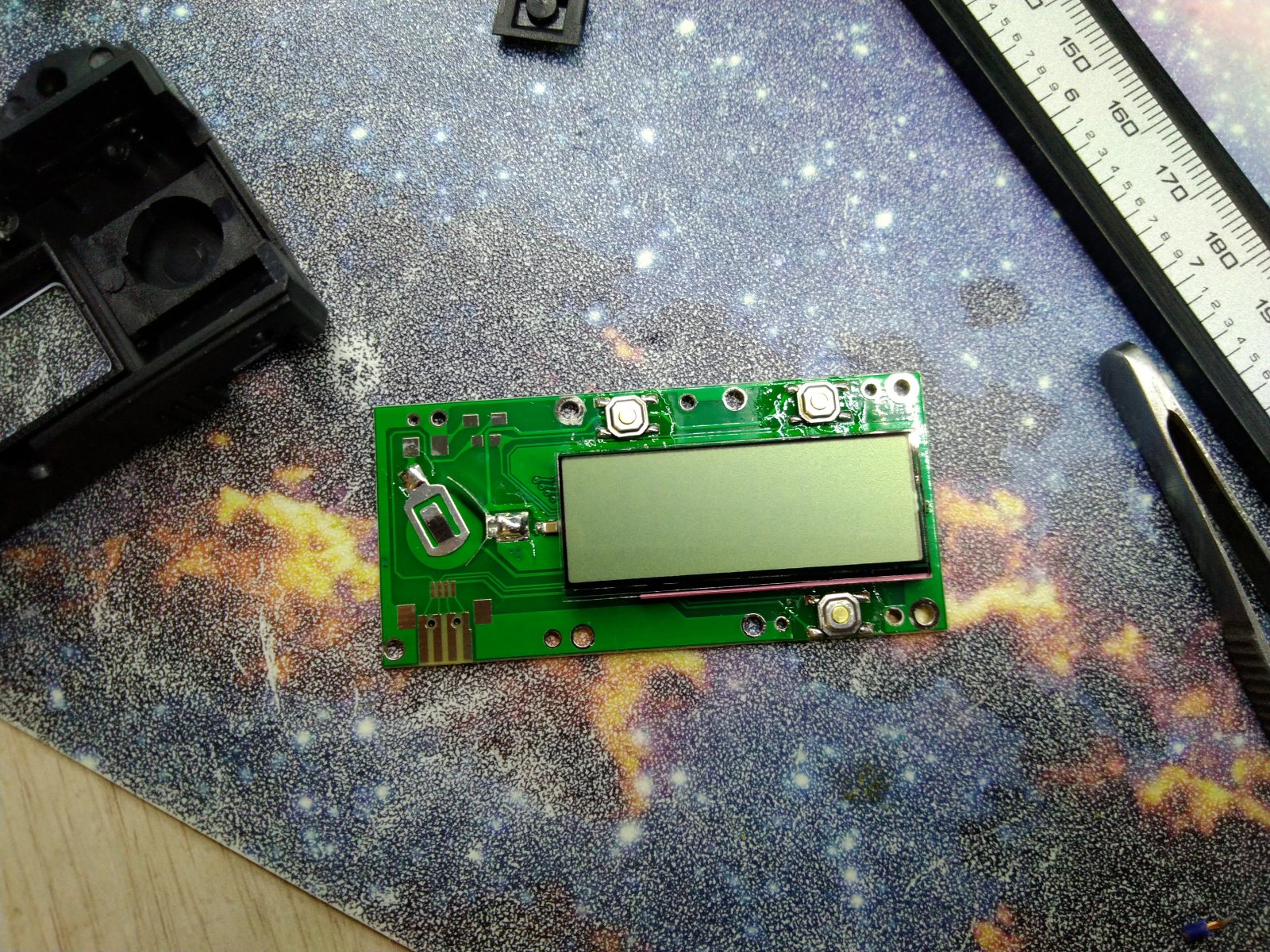

    IMG_20210116_142408.jpg IMG_20210116_142501.jpg IMG_20210120_193948.jpg IMG_20210120_194018.jpg IMG_20210120_194616.jpg IMG_20210120_195421.jpg 11.png
    http://www.shumatech.com/support/chinese_scales.htm#Chinese Scale Protocol
    There is a way to switch to fast reading 20ms (50Hz) in this description, but it didn't work for me. Apparently such a caliper.

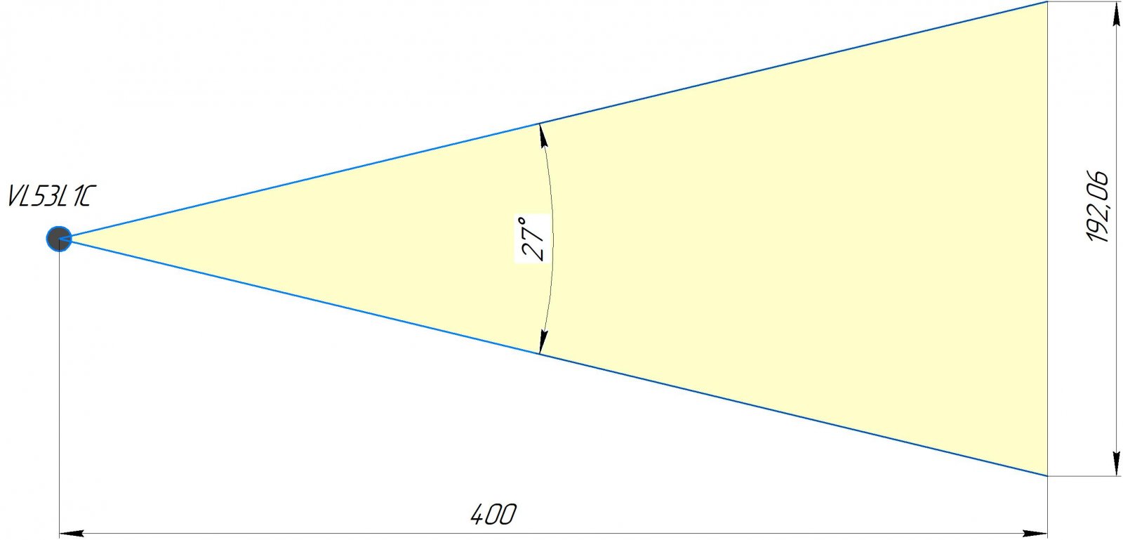

    I have one similar VL53L1X sensor and I am using it with arduino in another project. It has the disadvantage that it is not really a laser. It measures not with a point, but with infrared radiation with a viewing angle of about 25-27 degrees. At a distance of, for example, 400mm, it will cover an area of 192mm. A foreign object can fall into such a large area and knock off all measurements, which will lead to not very good consequences. VL53L1C FOV27.jpg

    Put it in a tube ;)

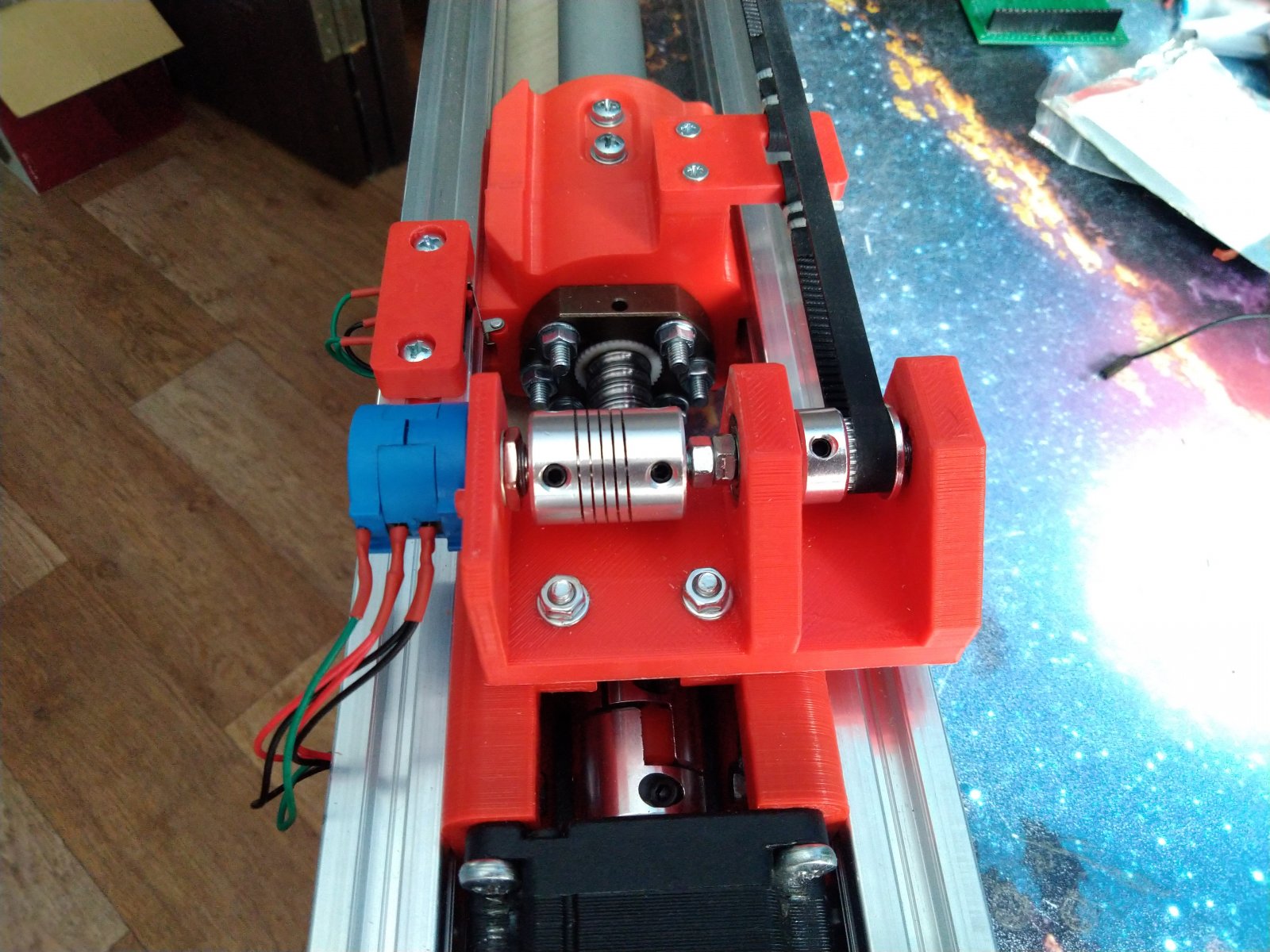

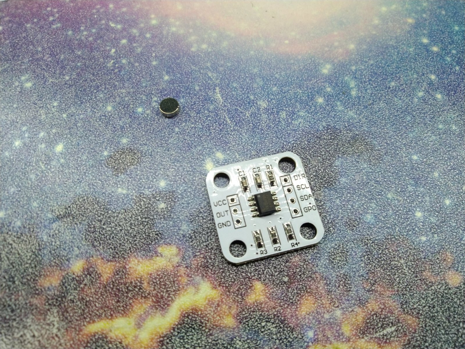

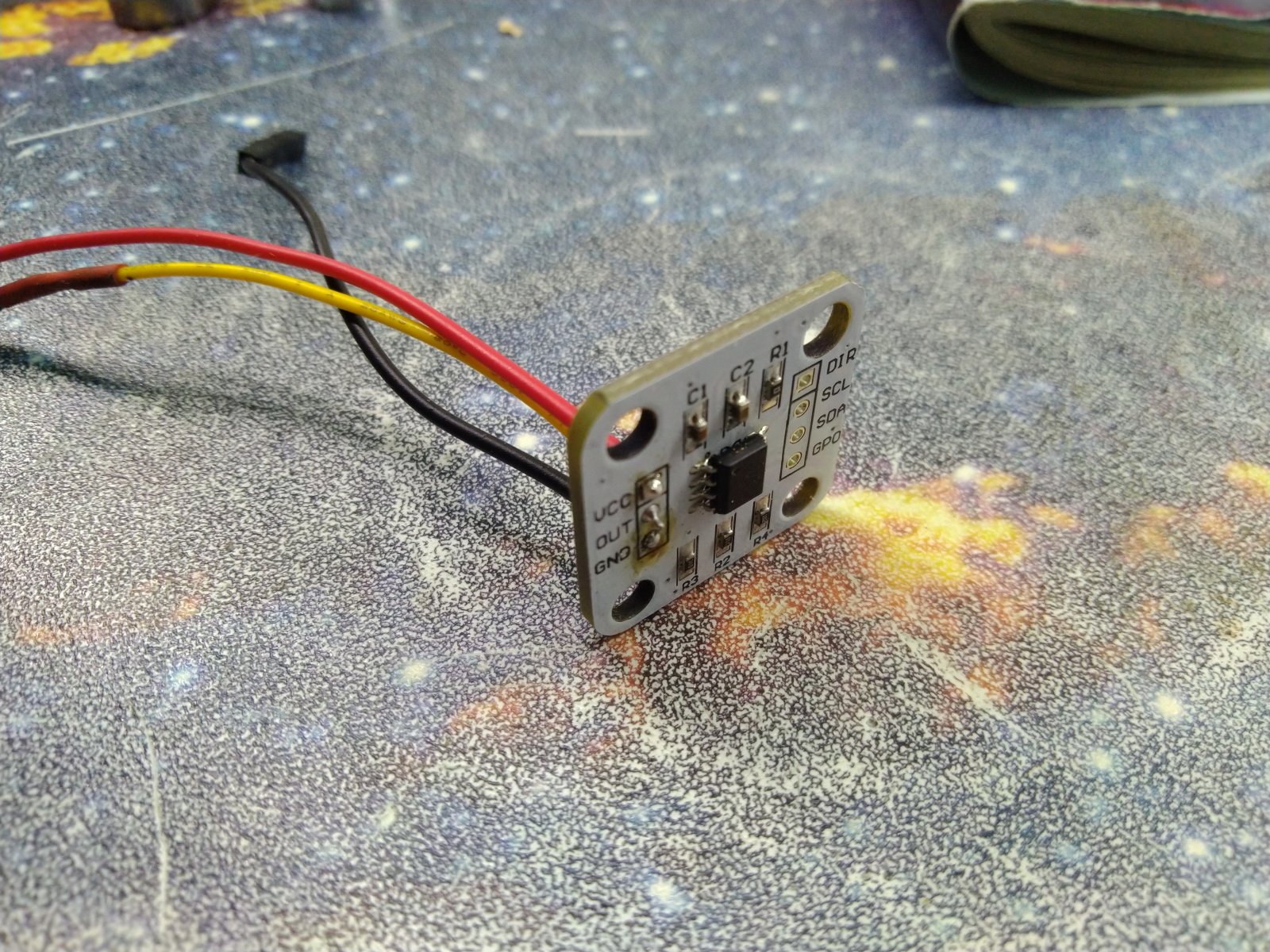

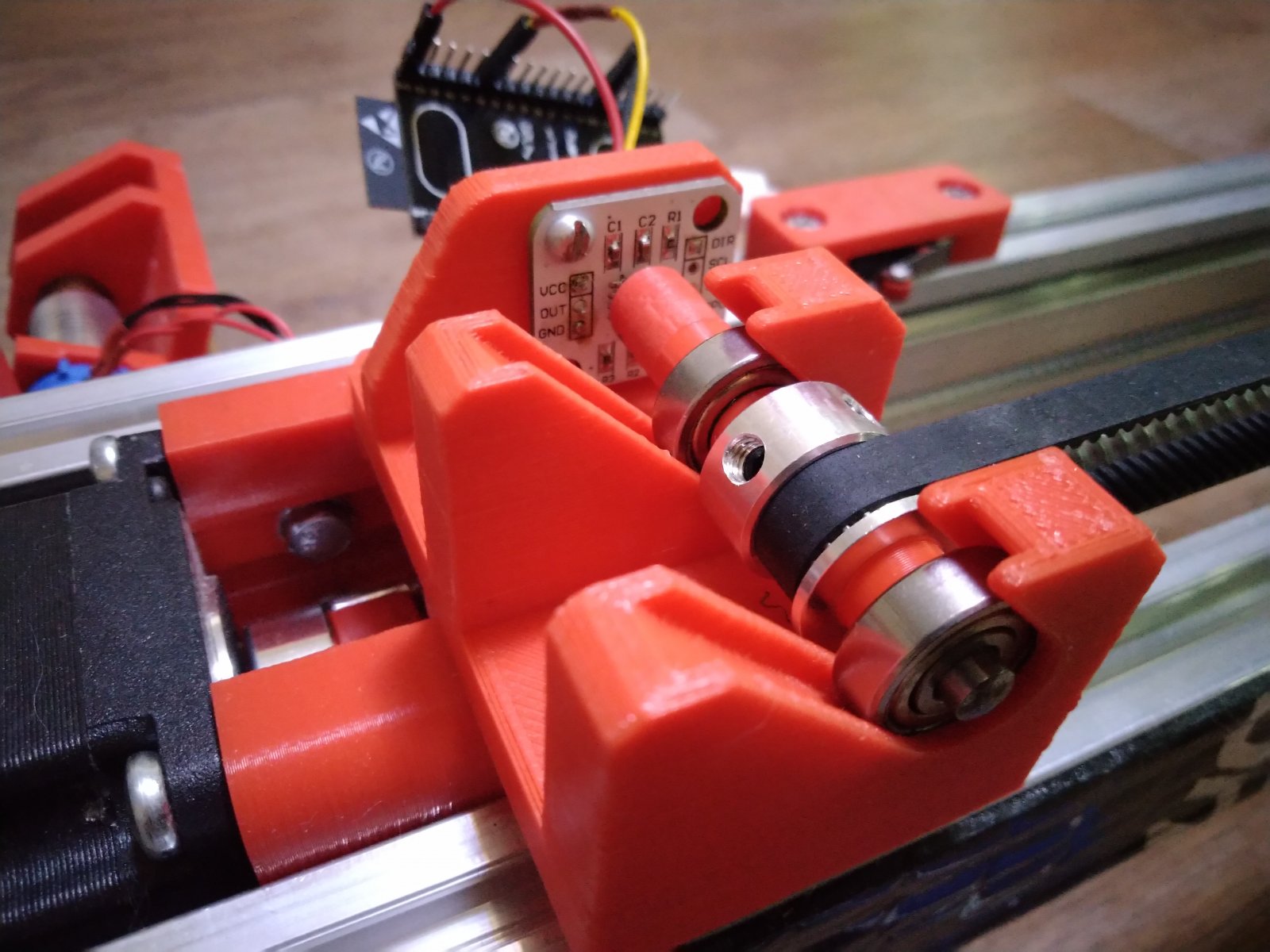

    I took a magnetic encoder AS5600 for the experiment for 1.5 euros. I'll try to make a cheap encoder

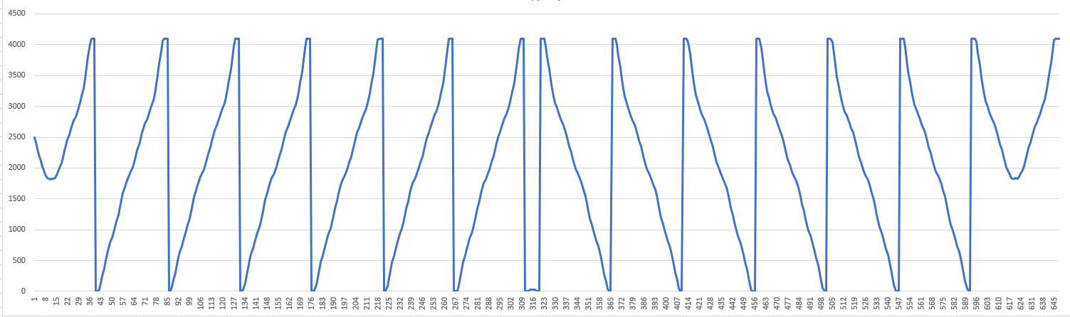

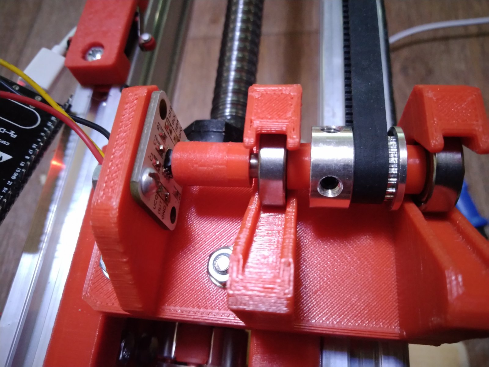

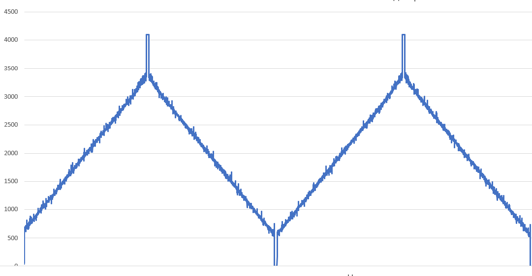

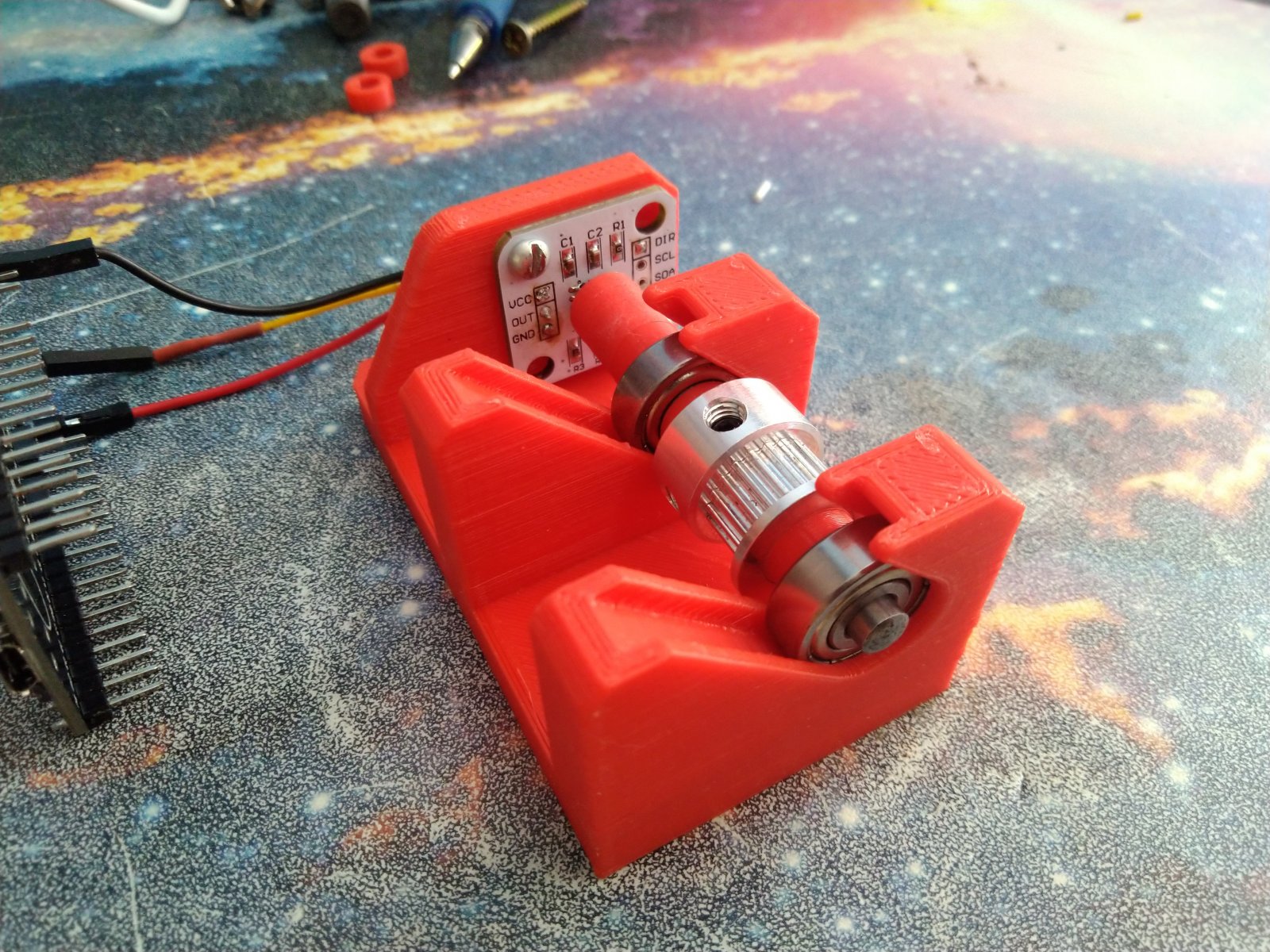

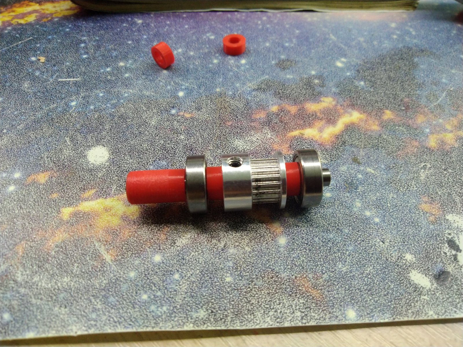

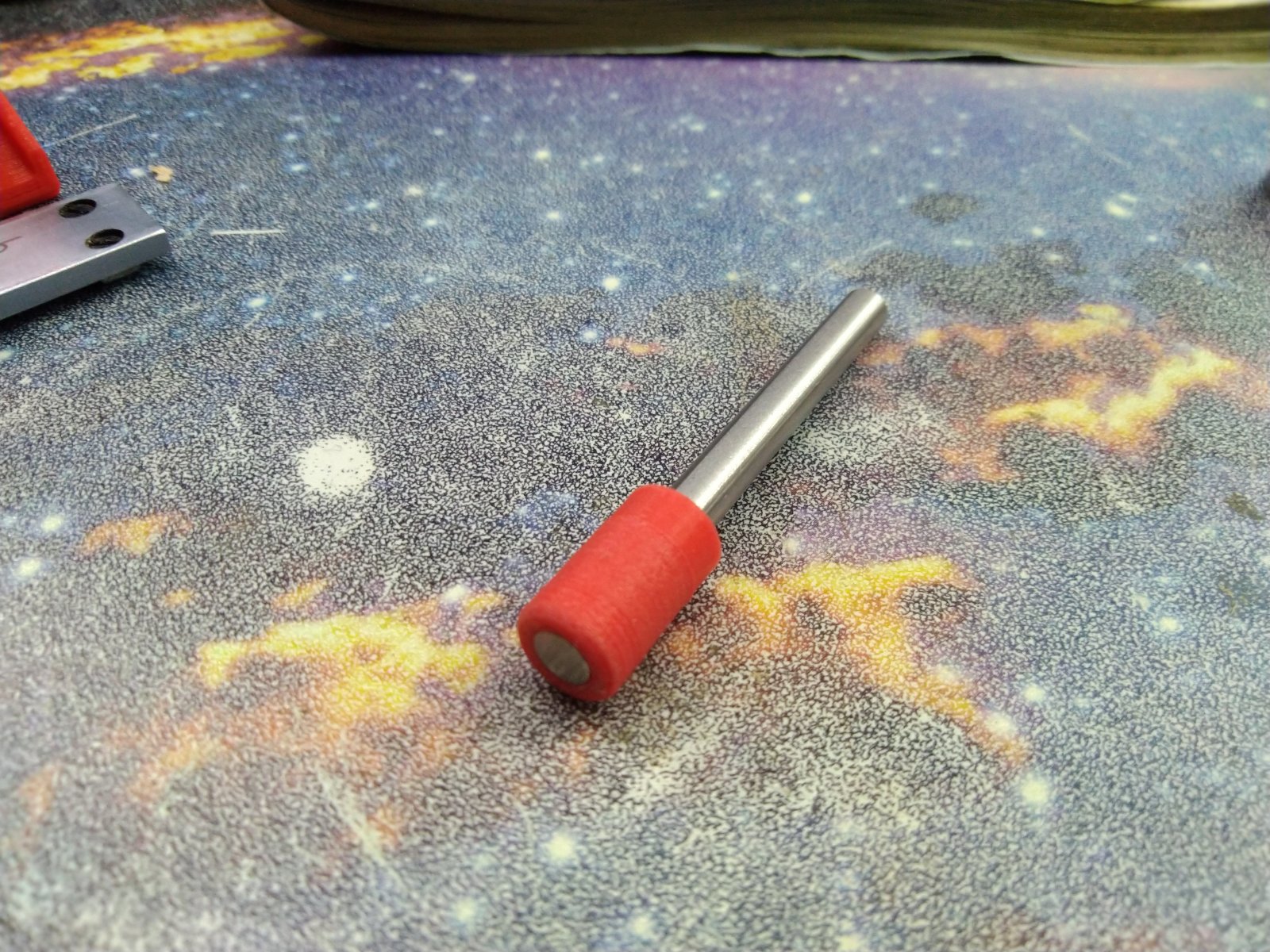

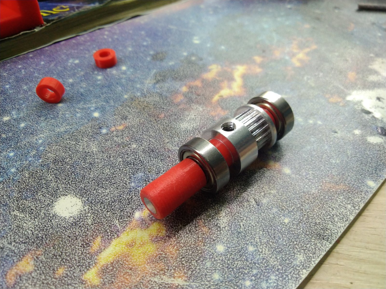

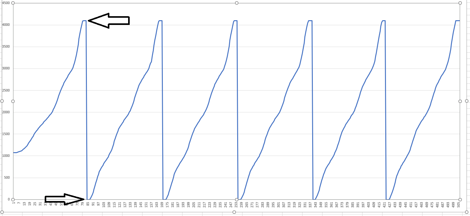

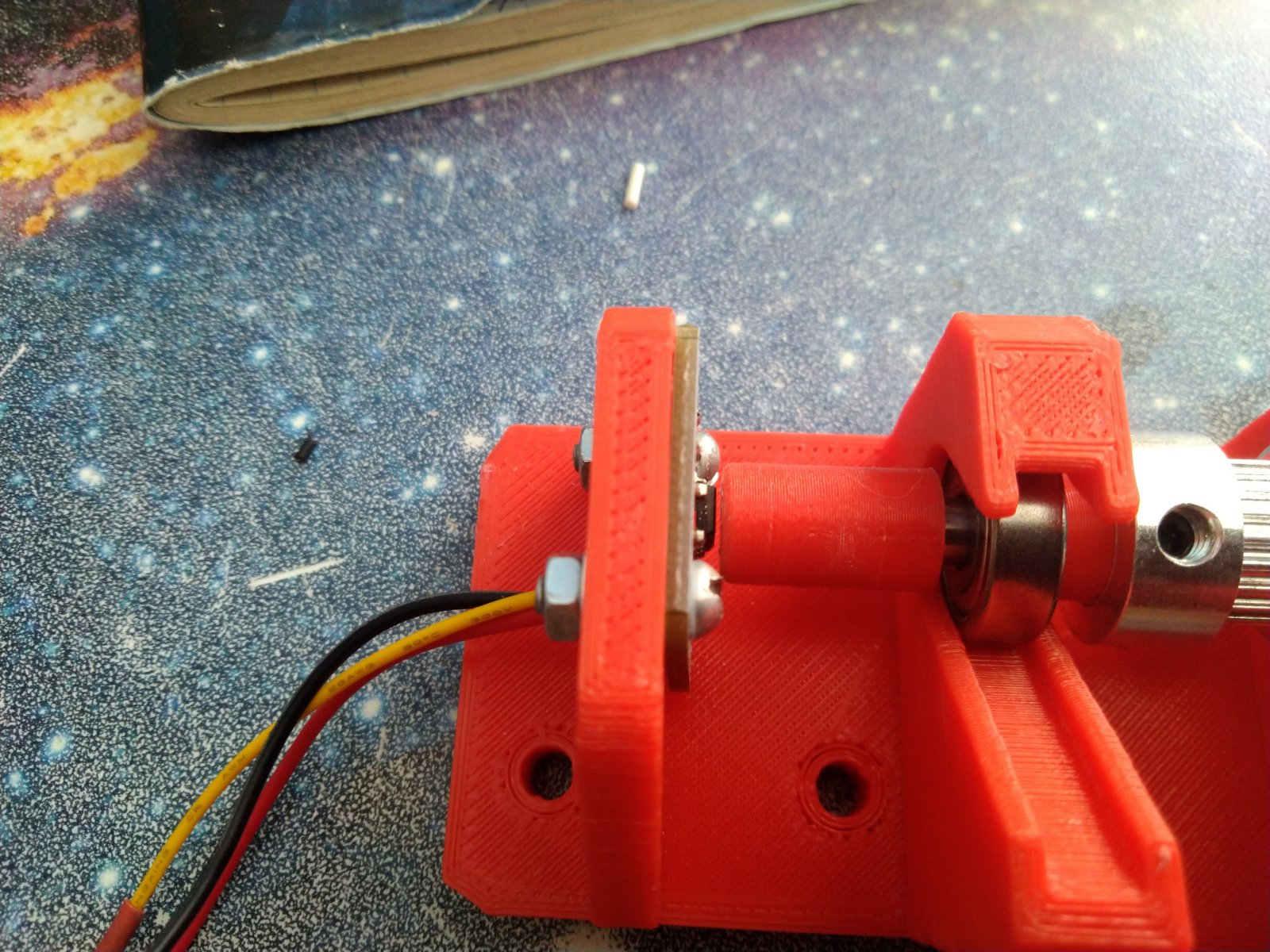

    I finally got to the magnetic sensor. The magnet was fixed on the rotating axis, and the sensor itself was screwed. The sensor can be moved slightly in two axes within the screw gap to position it exactly in the middle of the magnet. The magnet on the axle can be moved a little, thereby adjusting the gap between the magnet and the sensor.
    IMG_20210612_115822.jpg IMG_20210612_123732.jpg IMG_20210612_123950.jpg IMG_20210612_123954.jpg IMG_20210612_163322.jpg IMG_20210612_163333.jpg
    As a result, I got the following graph. The graph shows a dead zone when going from 360 to 0 degrees. I don’t know what to do with it and how it will affect the movements. In general, the readings turned out to be the same at several revolutions, without bursts. The price of the issue is 1.5 euros.
  13. RandyT
    RandyT Enginerd
    Feb 18, 2021
    7
    62Coins
    The graph seems also to be showing some very repeatable linearity issues. I would suspect some eccentricity in the rotation of the magnet. The magnet needs not only be centered on the sensor, but must also be centered exactly on the axis of the shaft rotation. A 3D printed coupler may not have enough accuracy to do this adequately.

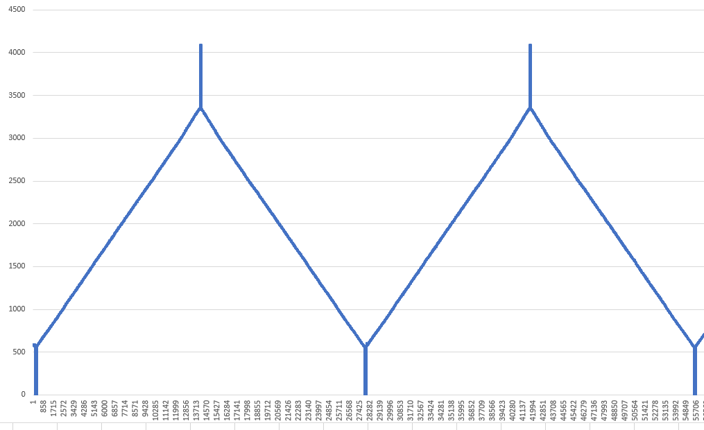

    A small summary of the comparison of cheap feedback methods
    1. Potentiometer 10Kohm. The software filter was used: arithmetic mean over 10 values
    We see good linearity, but there is a lot of noise in the form of bursts
    2. Potentiometer 10Kohm. Software filter used: median filter by 9 values
    We see good linearity. The program used a median filter - 9 values were read and one mean was selected. Thus, sharply different values were discarded and did not take part in the calculation.
    3. Hall sensor chip AS5600 of Chinese origin. The filter was not used.
    Non-linearity depends on the exact centering of the magnet, which is difficult to do on your own.
    How will such a deviation from linearity affect the actual movement on the installation? Who has any thoughts?
