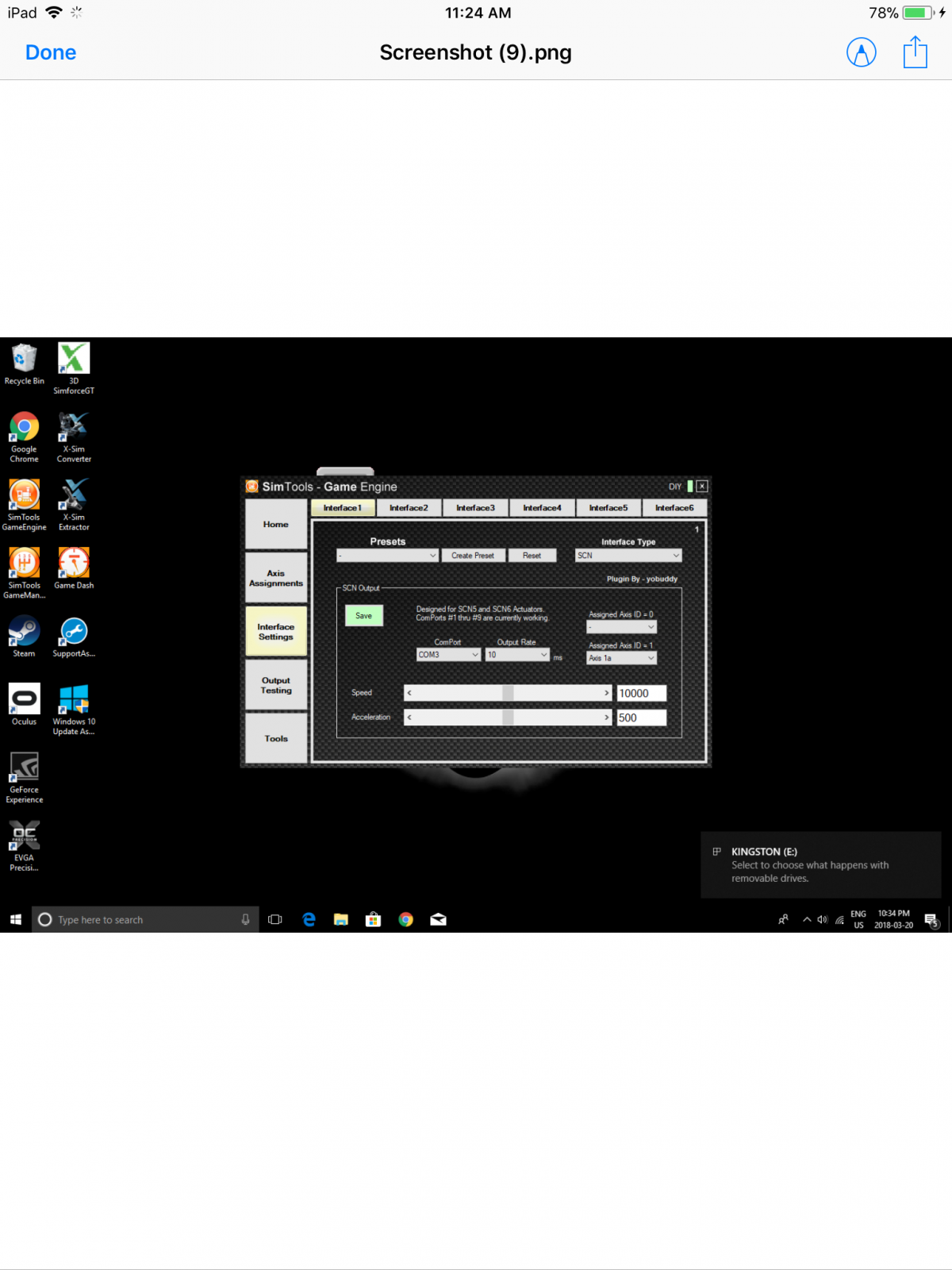

    1. Reset all interfaces blank. Restart Game Engine. Output Testing, “Turn On”... countdown starts. Works as designed.
    2. Set interfaces #1 and #2. Save. Exit Game Engine. Restart Game Engine. Output Testing, “Turn On”... no go; error message: “One of your interfaces requires Game Engine to be restarted. Please restart Game Engine”.
    I keep resetting and attempting again with no success.
    Help please.

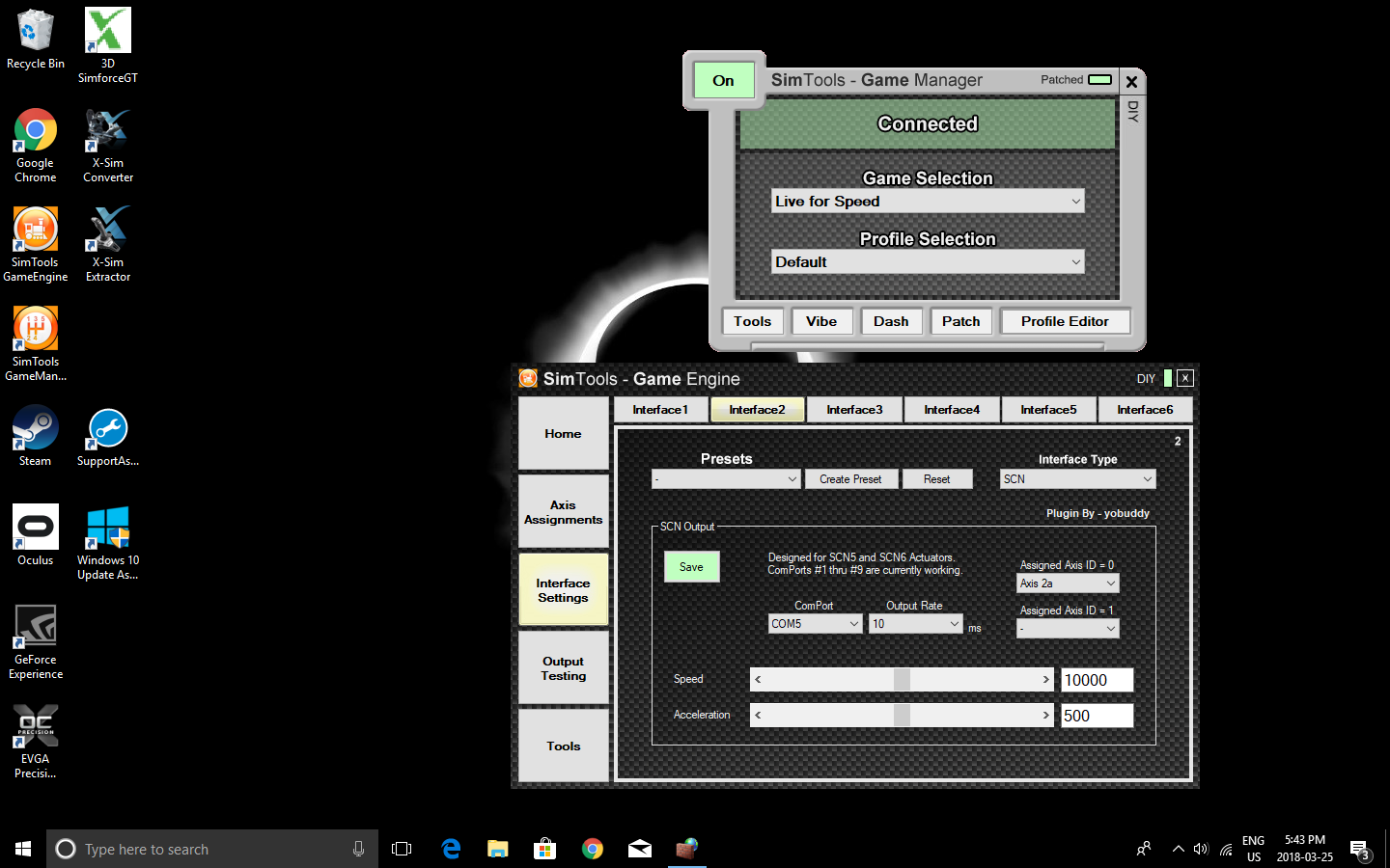

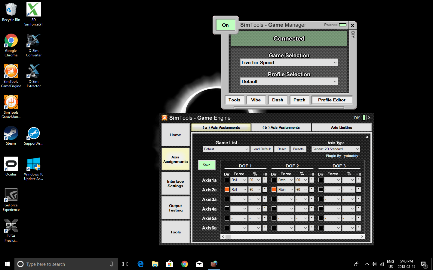

    Please post screenshots of you Interface and Axis Assignment settings.
    Could I also have a shot of your scn setup also buddy.

  4. yobuddy
    5,383
    50,374Coins
    +5,153 / 18 / -0
    I can't really see the screen shots as they are so small.
    But I can tell you are using ID = 1 and you should be using the one above it.
    Set the one that says ID = 0 and you should be good to go.
    Take care,

    ... still no success. I’m considering a complete reinstall. As an idea, can you provide me all the proper axis and interface settings and I’ll simply input your; as opposed to you trying to verify my inputs???

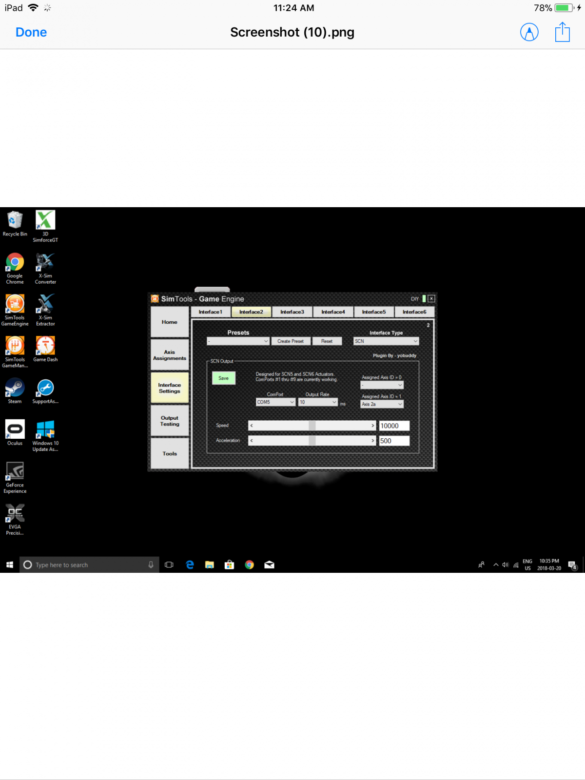

    Please post new screenshots with the changes i suggested buddy.

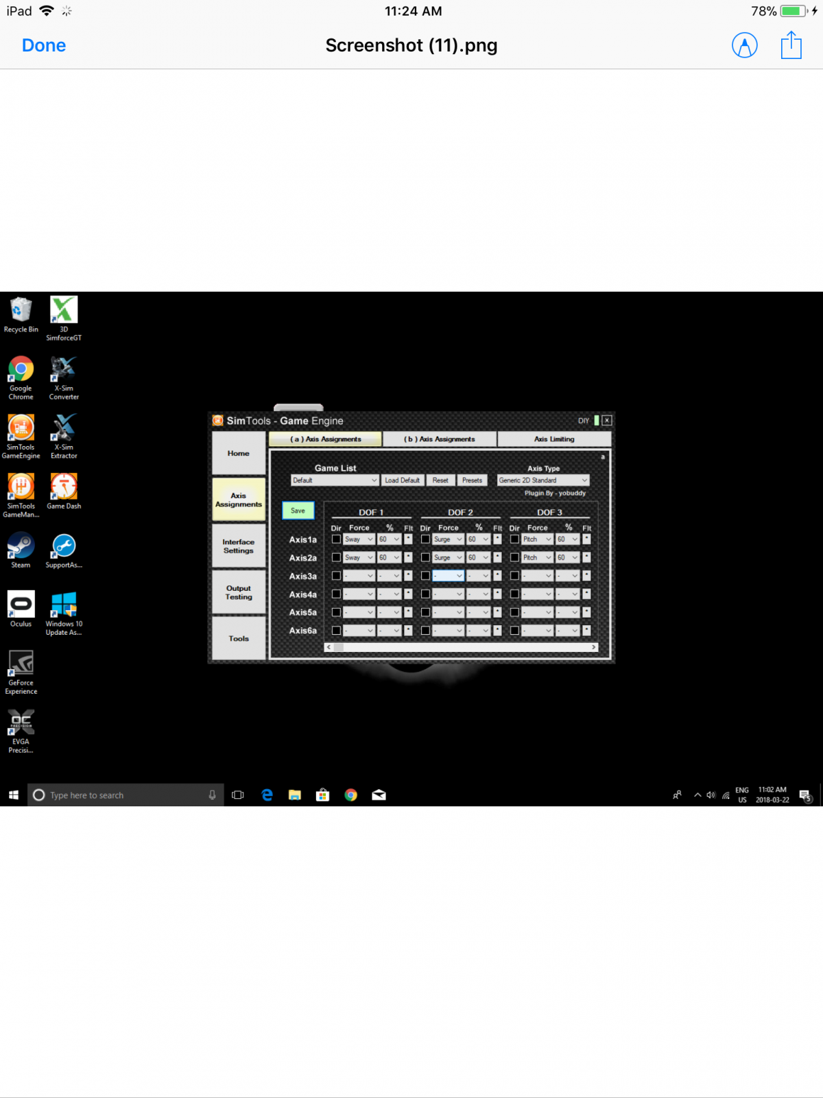

  8. yobuddy
    5,383
    50,374Coins
    +5,153 / 18 / -0
    Uncheck the 'DIR' setting from Pitch for Axis 2a.
    Also, instead of Roll I think you want Sway.
    And instead of Pitch you want Surge.
    What type of SCN actuators do you have?

    Changes made. Still no success.

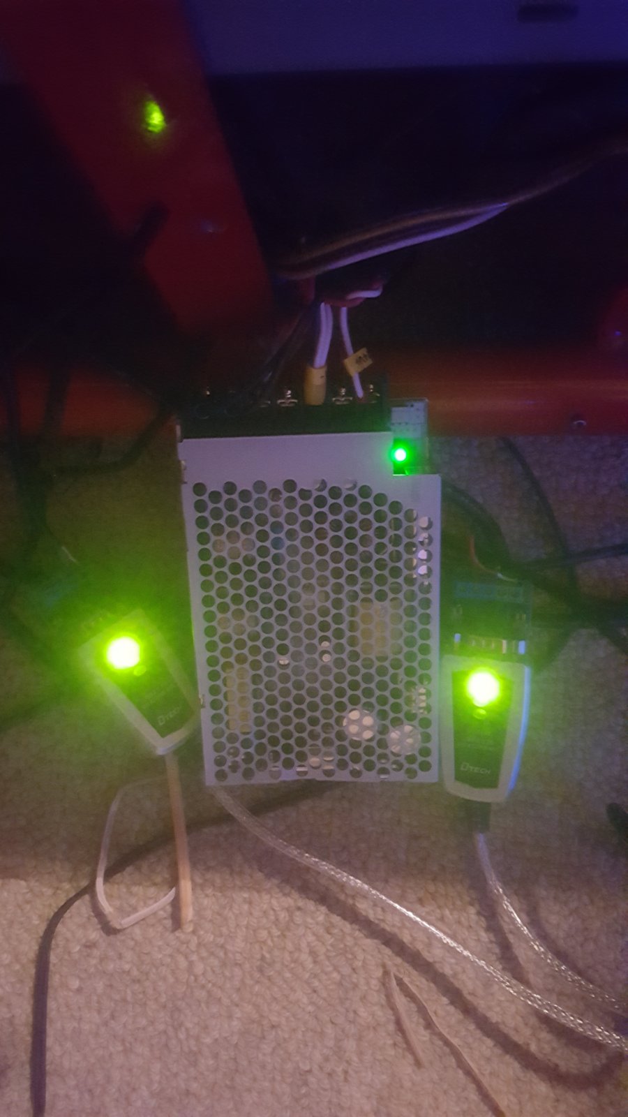

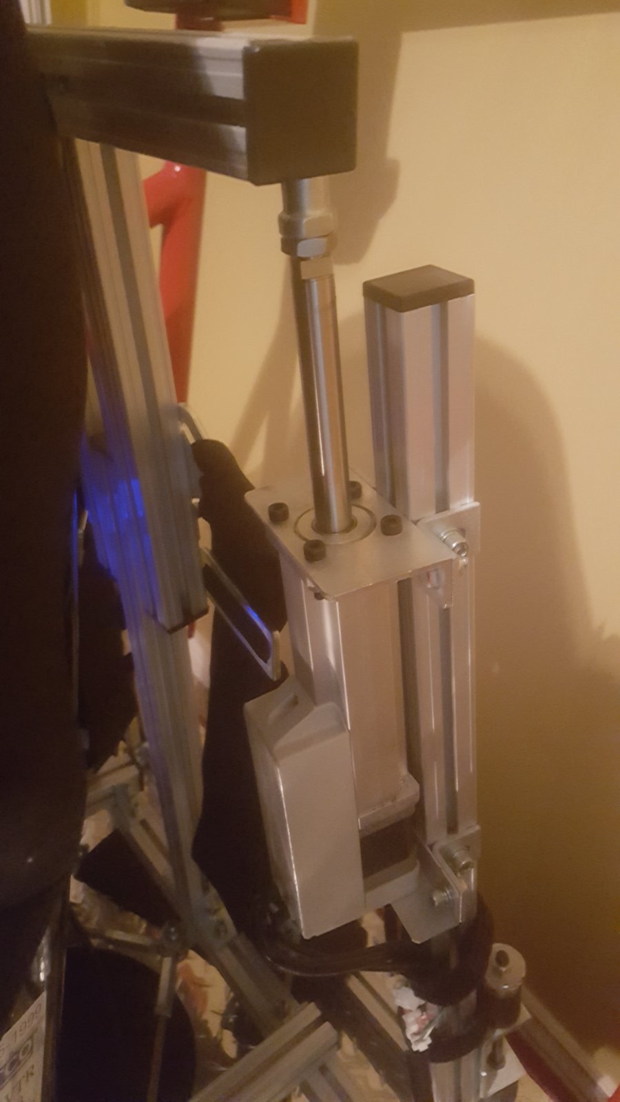

    424E8BB5-F505-41C3-947A-F0A29D508124.jpeg 2D7EC739-9BF8-40D2-90DE-86DE76860BAB.jpeg
    Actuators used to center in Sim Tools v2.0, but not since going to v2.2.5
    I had not changed original ip addressing until today after a friend’s suggestion; Game Manager/Game Engine now have same IP. Still getting same “restart Game Engine” error.
    2 pics attached: SCN actuator and Frex controller unit with USB converters.
