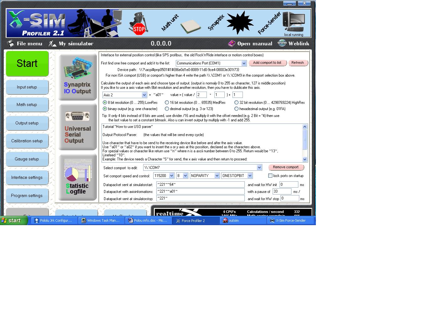

    i have 2 jrk12v with 2 wipermotors conected via usb i move the motors with force sender but i dont know the uso parameters

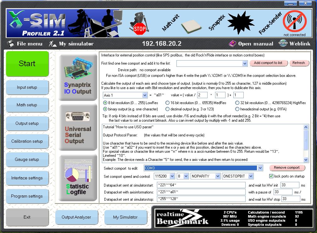

    I would suggest using the search in the future.
    remember you need one for axis 1 and one for axis 2 and so on depending on the number of actuators. IN the bottom you will need to change a01 to a02 for the second axis.

    with that uso when i push the stop my motor dont stop where i want and every time that i click start and after stop my motors stop random.
    i want to give the program the command to start to stop and to come back where the motor it was first without looping over and over maybe is something wrong with my feedback or my pot?
    i am sorry for my english i hope that u understand me and thank u for your answer.

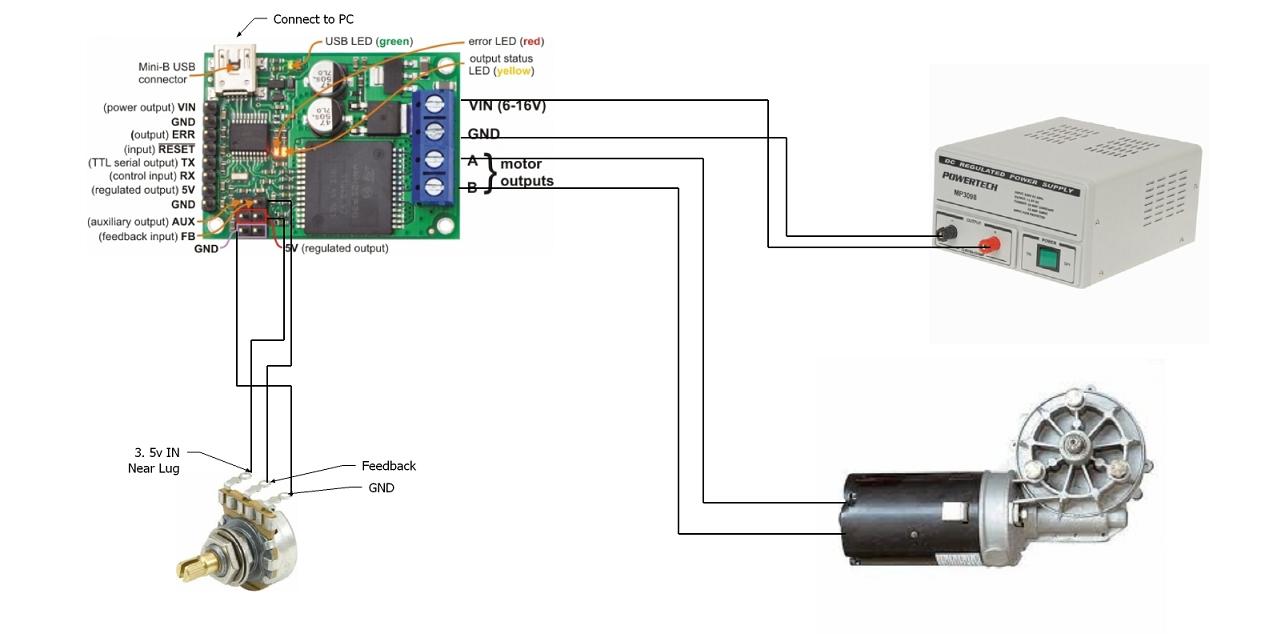

  4. bsft
    Check how you have wired the potentiometer for feedback, refer to attached picture. The pot can be a single turn pot. It only needs to move 90-180 degrees in movement. Where have you mounted the potentiometer?
    Have you set up the jrk utility correctly? You need to set the feedback position on the feedback tab . To do this click learn, then follow on screen instructions,as well and click apply settings to device on the bottom right hand corner. Then go to the input tab and on the bottom right is a box you need to tick labelled automatically set target, then click run motor' then use the manually set target slider tab to check if the motor moves back and forth. If your motor can move from one position to another, then you are on track to setting it up.

  7. bsft
    For the pot, 100k is a bit high, but may work. You could also add a resistor soldered across the 1 and 3 terminals, hence reducing the overall ohms. This would take some experimenting on your side though. The suggested is between 4.7k and 10k and single turn. From what I can see, you have the Pot set correctly, just make sure it reads correctly before powering up the 12v.

  14. bsft
    in the jrk utility, you do not really have a stop point. This is to make sure the motor works, which it does. In the x-sim USO settings is where the motor learns the stop point.
    Find in the device manager as to what comport your device is in. Put that comport in find one free comport and select comport to edit. You will need to do this with both motors.
    Try the rest of the setting I have in the pic. So when you hit start the motors should go to a middle point of stop before they await the force feedback commands in the math setting.
    You can also try datapacket at stop setting of ~255~ instead of ~221~. These settings work for me, you may have to modify the stop number and try the value =(value / setting of 2,1,0.
