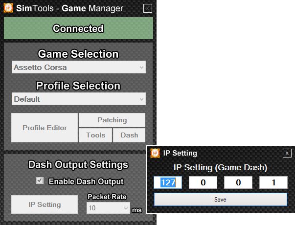

    If you just have the DashApp on a 2nd computer you don't need to install SimTools on that PC. The DashApp is enough.

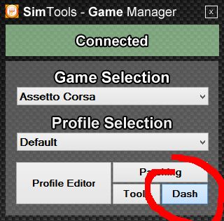

    In GameManager running on the same coputer as the game, click Dash
    Then click on IP Settings
    and enter the IP address of the PC that runs the DashApp.
    (Check the IP address by running ipconfig.exe on the PC where the DashApp runs.)
    Make sure you also check Enable Dash Output and select a Packet Rate (e.g. 20 ms)

    Keep in mind that you could also run the dash app on the game manager pc and then feed the outgoing data to the laptop. (If you use udp output)
