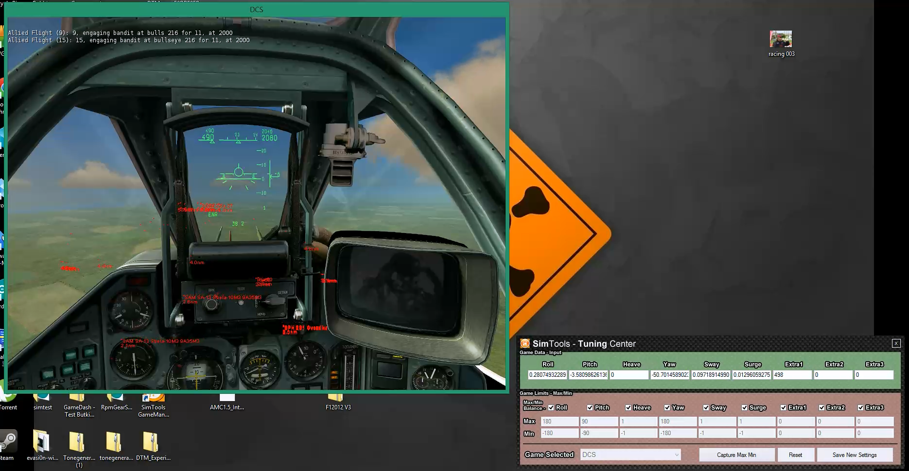

    Not sure I need to look at plugin again and do a little video , as it worked for me , on my system,
    Does the ard code work in the Ardunio IDE, I did test it, did I comment the first debug line out of it, plus if you are not sending all 5 axis in the game engine to the 5 servo code wont react properly. I was testing with DCS World.

  8. eaorobbie
    20,506Coins
    +1,687 / 23 / -2
    Well I got it running on mine , not sure why yours doesnt work, still checking.
  9. hugso
    hugso Active Member
    Sep 17, 2013
    140
    Glos UK
    611Coins
    +52 / 1 / -0
    Arduino, Motion platform, 4DOF
    Just tried the DCS plugin again, but still no go. As I said, the first DCS plugin works, but the one with airspeed has no outputs in Virtual Axis. I have unpatched, installed plugin and repatched game. On a more positive note, prilad has added airspeed and shake levels to IL2 Sturmovic. This is great news for me. He has put airspeed on Extra 2. Would it be possible to have airspeed on Extra 2 on all flight sims which have it so we don't have to swap plugs between games? When I am feeling brave I will attempt to add Extra 2 and Extra 3 to the Ard.
