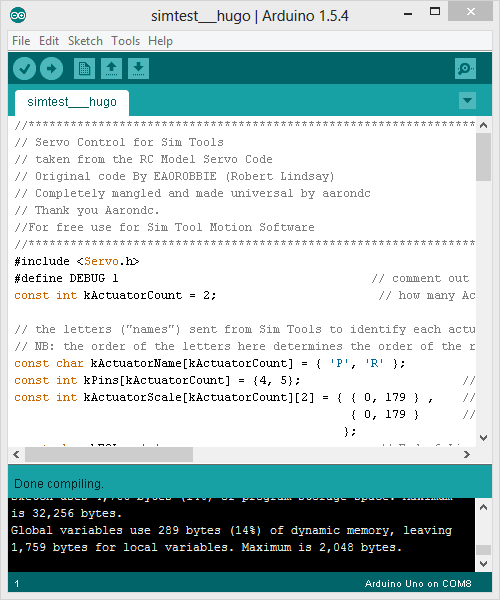

    Weird indeed proof that it compiles, just fine.
  2. Hypo

    Cheers, eaorobbie. The code you sent in the zip file does the business :)
    Sorry to send a forum question about this. I know it is a quick and dirty way to get an answer. Not sure why the code I cut and paste from the thread wouldn't compile. No matter, the main thing it now works!
    Many Thanks :)

    Right back to the actual topic, so you can now control the g seat with the above code, have you been able to add the third axis ok.
    Its pretty easy to adapt the above code, even to 6DOF as a fellow simmer has achieved,please don't forget to thank the other guy Aarondc without his contribution to my first code, this would not be achievable.

    I got the Pitch servo working last night. It was great to see the servo move when I sent Pxxx~ commands :)
    Absolutely a huge thanks to Aarondc and all of the SimTools crew. Hugso and I have achieved more in a couple of days, with your help, than we have in months. The XSimulator community has been outstanding. Thank you to all of you.
    The next step is to help get Hugso's setup up and running. I will talk it through, with Hugso, what I did to get up and running and get the Pitch and Roll axis working with him. I am sure Hugso will be able to video gSeat moving when commands are sent to the Arduino.
    When we have got gSeat moving on the two axis I will look at adapting the program to add a third axis. Hugso and I are doing things one step at a time :)

    Thanks eaorobbie for the zip. I too now have the pitch and roll servos controlled by the Arduiono. This is all very exciting for me as Hypo and I have been struggling for ages to get my cockpit moving with other sims. The next step I guess is to get Sim Tools and then the plugins for DCS World and Cliffs of Dover? When I last looked at the plugins download page they were greyed out and unavailable. Is there something I have do, like buy all you clever guys a beer or three? Please let me know if there is anything I can do to for you all to show my appreciation for your hard work an very helpful information.

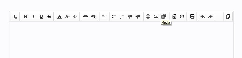

    I have just tried to post the video clips, but they wont drag and drop. Do I have to do something different for vids?

    Use the Media button for importing videos.
