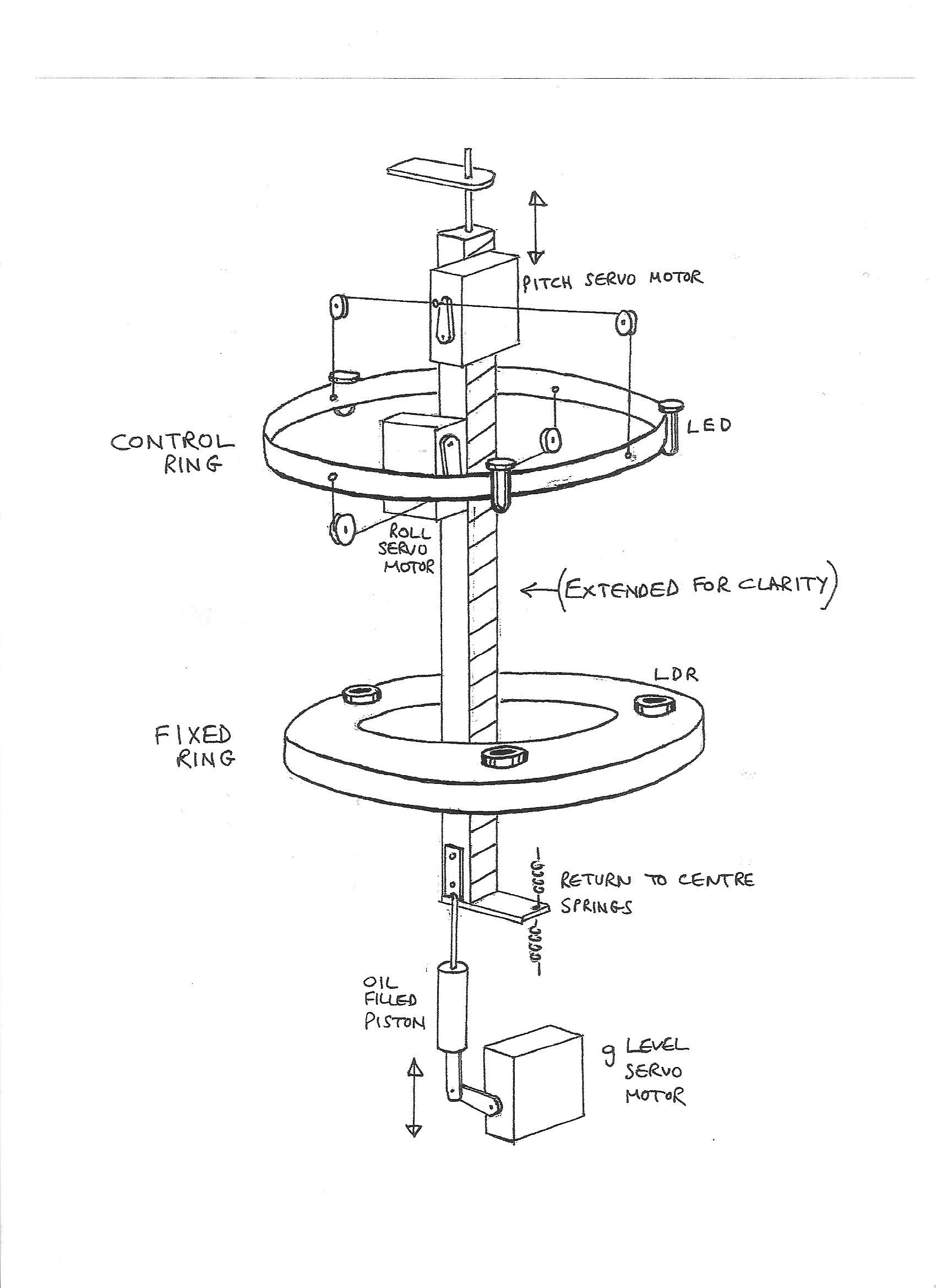

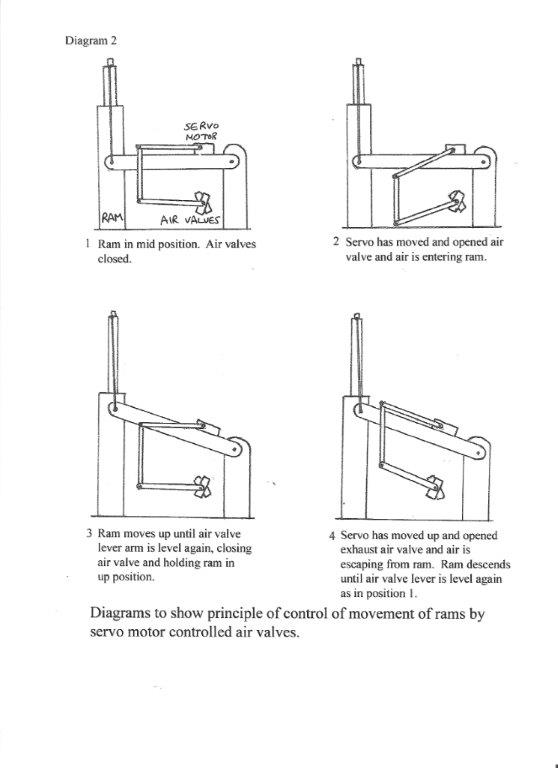

    Here are two schematics. The three pneumatic rams which support my cockpit are each controlled by a servo motor which operates the air valve. This air valve is simply two simple cheap shut-off valves mounted back to back and a longer lever attached. Moving the lever down opens the air valve and moves the ram upwards. Moving the lever upwards opens the exhaust valve and the ram descends. Because the servo motor is linked to the top of the ram with a stiff wire it moves with the ram so that the ram moves to a given position and stays there. These servo motors are not driven directly from the sim, but via the mechanical integrator. As I hope you can see from the diagram, the pitch and roll servos driven from the sim are connected at 90 degrees to each other by nylon fishing line to a ring. This ring will tilt in both axes and also move bodily up and down driven by the heave (g) servo. On the ring are mounted 3 LEDs which shine onto 3 light dependent resistors on a fixed surface. These 3 resistors control 3 servo drivers which move the servos on the rams. As the ring move up away from the LDRs their resistance changes and the servos on the rams operate the air valves and the ram moves up and vice versa. Same with pitch and roll. The heave servo is linked to the moving ring by an oil-filled piston which allows the ring to wash-out back to the centre position with sustained high g. In other words the movement of the seat mimics the movement of the ring of LEDs. For sway motion the whole seat carried on the rams is mounted on heavy duty drawer runners and a horizontal ram and servo moves it a couple of inches either way. This is driven directly from the sway servo from in game.
    I hope this is of interest.

    Looking at your above pictures I can see that roll and pitch should work for you , I hope but the g level one is that to control the vertical position of the rig if right I can easily include this in the above code, and control this with heave.
    Let me know you could probably do this your self the code is quite versatile to add another axis too, ie set the extra pin and the starting position and a Letter 'H' for heave and the scaling value you require, Aarondc made it very adaptable, hope for opening this code for 6dof use.
