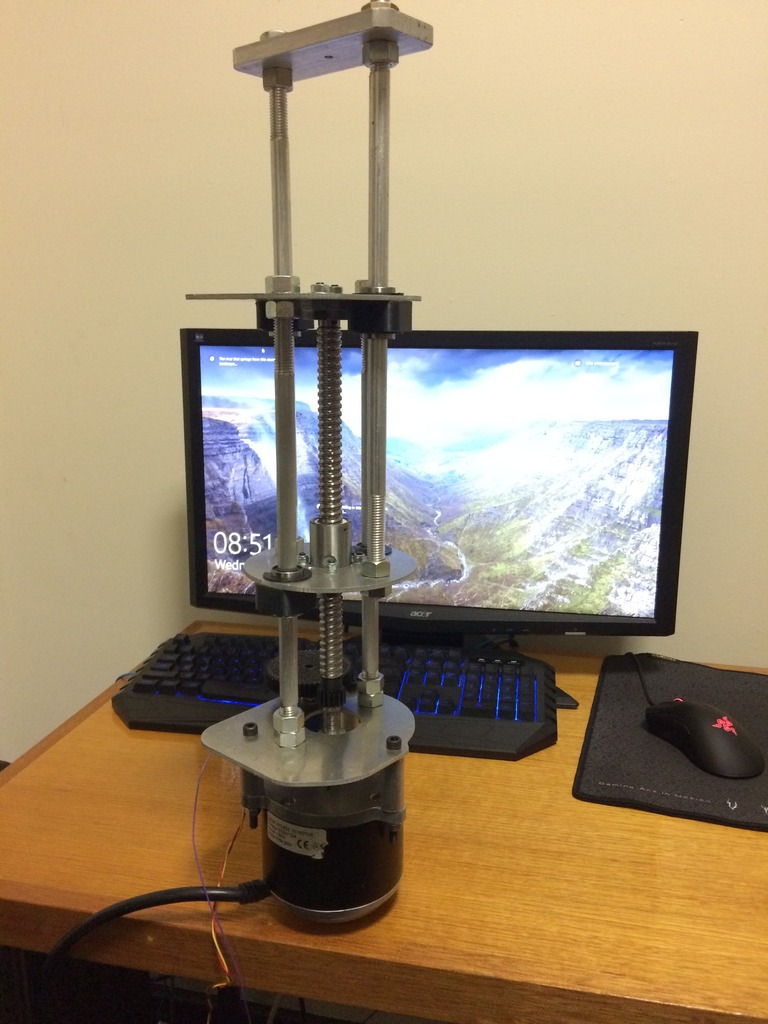

    Hello all!
    To make a long story short I will start with this, I am never happy with anything I build....
    I have decided to build a simulator using 4 linear actuators to provide pitch, roll and heave.

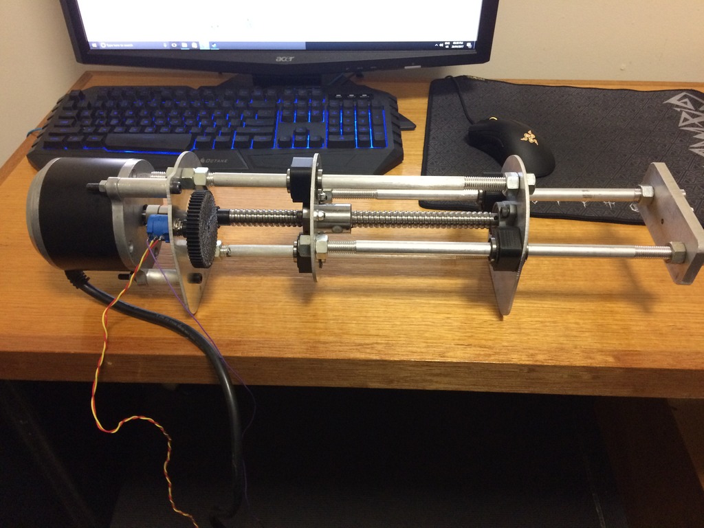

    What has this got to do with rotary encoders you may ask? Well as I have been building and testing my actuator I have come across a really annoying problem. The problem is accurately reading the position of the actuator and also mounting a potentiometer along with the gear reduction etc. I found this to be really annoying and to top it off my 10 turn pots ended up being unreliable as they would partially loose contact with the track at some points and just generally poor performance all round. Sometimes they would work and sometimes they would misbehave. So I looked into the usual things such as stupidly expensive pots, string pots but they all had this annoying part mounting them accurately and adjusting travel distances with gears etc.
    My actuator:
    The easiest answer in my mind is using a rotary encoder as they turn forever and you don't have to worry about gearing them down. That is where I remember reading a few people asking "why can't we use rotary encoders?" and the answer was always "because they take up too much headroom in the processor". So why not just give the reading of the encoder to a separate processor then?

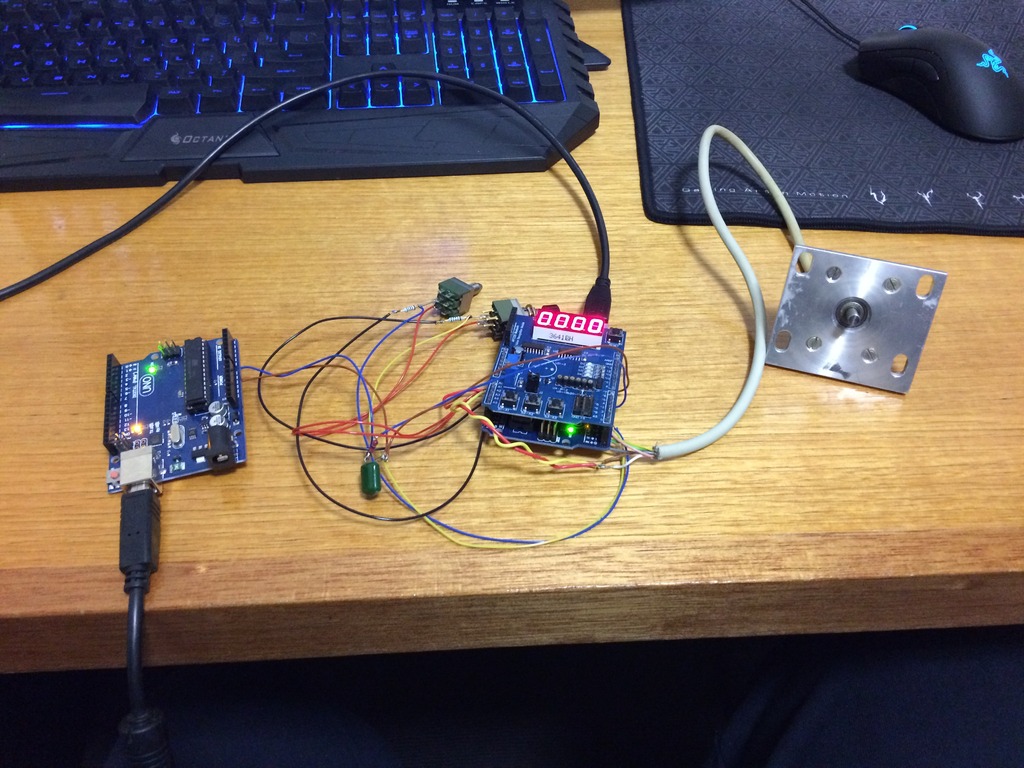

    A picture of my somewhat messy setup:

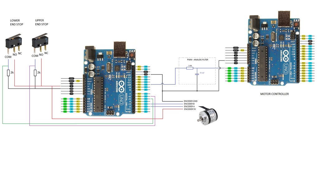

    So, lets get into the setup.
    At this very early stage the setup requires a separate arduino to read the encoder and output it to the arduino that runs the SMC3 code. At the moment I am using an arduino UNO but a nano could be used in its place as they are a cheaper board. I have a nano and I will test the code when I get around to fishing it out of its hiding place.... somewhere....
    The encoder is a 100 cpr unit that I salvaged from an old antenna rotator that was being thrown out. Having a low cpr is actually quite useful for an actuator because the arduino can easily keep up with the counts + rpm and is still very accurate. There is only 255 positions in the whole range of motion, the encoder counts are mapped to 0 - 255. So having a 1000 cpr encoder is only just putting strain on the processor.
    lastly there is two limit switches which are activated on the lowest and highest part of desired travel range.
    These can be activated by hand or setup up to be activated by a pre-determined point on the actuator/lever arm.
    How the code works:
    The encoder is read via a hardware interrupt routine which makes it very fast and accurate. The two encoder channels A and B are connected to pins 2 & 3. Every time the encoder outputs a pulse the code determines the direction of the encoder and will either add to the encoder count or decrease the encoder count. The count can go negative, which is undesirable but wont really hurt anything
    To have a live update of where the encoder count is I have used an arduino multi function shield with a seven segment display. I write the encoder count directly to the display. (as seen in the video)
    I have written a part in the code so that negative numbers are not displayed because negative numbers do not display correctly on the shield. Only 0000 is displayed when the count is negative.
    Now I will get into the calibration. There are variables stored for the maximum and minimum count numbers. To set these limits there are the two limits switches. When the motion range of the actuator/lever arm is at its lowest point you can press the lower limit switch and this will ZERO the encoder count. meaning it resets the encoder count from wherever it was to 0000. This sets the lowest point that your actuator/lever arm will sit.
    Then the upper limit switch can be activated at the highest point of travel of the actuator/lever arm. It doesn't even have to be set an min/max as you can set the range to be wherever you want (but still within the mechanical limit of motion range). At this stage the encoder count will be however many pulses have been read by the arduino, there is no set count number. I used 1000 and 2000 just for ease of demonstration in my video.
    To give a real world figure, my actuator has 32 turns in the desired travel range. This will theoretically give me 3200 encoder counts over the range.
    Now to getting to the output stage.
    To turn these counts into a 0 - 5v signal we must convert the counts to a PWM value. Why PWM?
    When PWM is read with an analogue meter you will actually read a 0 - 5v ouput with a 0 - 100% PWM
    A PWM signal is sent in arduino by using the analogWrite() function. This has a range of 0 to 255 (0 - 100%).
    So how does an encoder count of 3200 squeeze into 255? We can map the value! The map function will divide out the encoder count into a desired range (0 - 255). Example: I can have a 1 to 1 ratio where the encoder is set to a max count of 255. So every encoder count is a direct change to the PWM. Or I can have a 2 to 1 ratio where I set the encoder max count to 510 where every second encoder count changes the PWM.
    The code also has a constrain function where it will enforce an output of 0 - 255. Just in case of the cheeky code doing weird things.
    Unfortunately just outputting a PWM signal is not enough to get that analogue signal to mimic a potentiometer. When connected to the arduino running SMC3 you can see that the feedback pot actually picks up the PWM pulses and thus just goes from min to max rapidly. The get the signal we want a filter must be used. It could also be called a DAC. A simple RC filter is used as shown in the diagram. BUT! this is still not enough... Along with the DAC comes noise which makes the feedback line oscillate a small amount. not a huge amount but enough to make a motion simulator vibrate rapidly. To eliminate this we have to use a software filter function called smoothing.
    The function has to be inserted into the SMC3 code itself. This function is inserted at the point where the feedback pot is read. it averages the reading of the input and then inserts it back into the feedback pot value.
    This creates what looks like a smooth response as seen in the video. It's hard to tell if there is any oscillation left in the feedback.
    This is as far as I have gotten so far. I will post the code and the amended SMC3 code so that anyone curious can test it out for themselves. unfortunately I forgot my damn USB that has the code so I will do that tomorrow.

    I like your style, but two things come immediately to mind...
    1. Why go to all the extra trouble of trying to mimic a potentiometer when the first UNO which is directly connected to the encoder already knows the positional value of the encoder? Why not just communicate this to the second UNO using I2C? I've not got any experience in doing this but it would seem like a more logical approach.
    2. If you power the second UNO with a battery backup then you could retain the encoder position and not need to initialise on startup.
    Just a couple of ideas which I hope will prove useful.

    I can answer your first question with ease, because I am a coding newb.
    My code consists of a mash of different arduino examples and things I have pillaged from the internet.
    Reading through I2c, I can't see why it would be advantageous for me to use it at this stage. Maybe at a later stage where I could modify the SMC3 code to use the encoder count as positional control but at this stage it is set up for reading a potentiometer.
    Come to think about it.... I could map the encoder count to a 0 - 1023 (same as the range of reading a pot with analogRead).... Which could be handled by the arduino running SMC3...
    You've got me thinking now.....
    With the battery setup I was thinking of using something like a nicad battery so that every time the power supplies are turned on they can recharge the battery. This could eliminate the need to re calibrate every time the arduino is turned on.
    As promised, attached is the arduino code.
    Line changes in the SMC3 code is as follows:
    94, 96 and 97 = setup
    smooth function is added to line 214 and ends at line 231.
    The insertion of the smoothing function happens from line 1659 and ends in line 1661.
