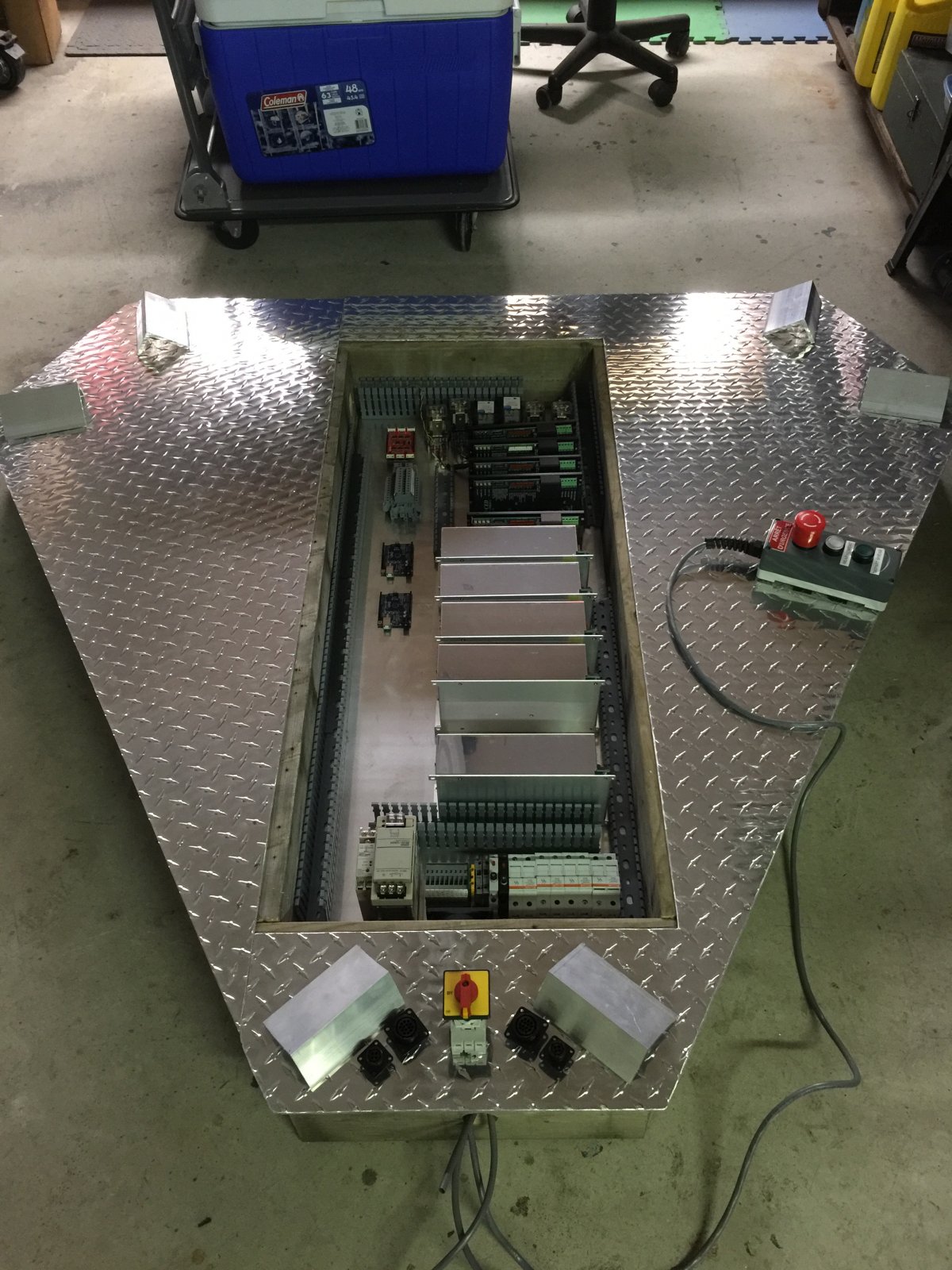

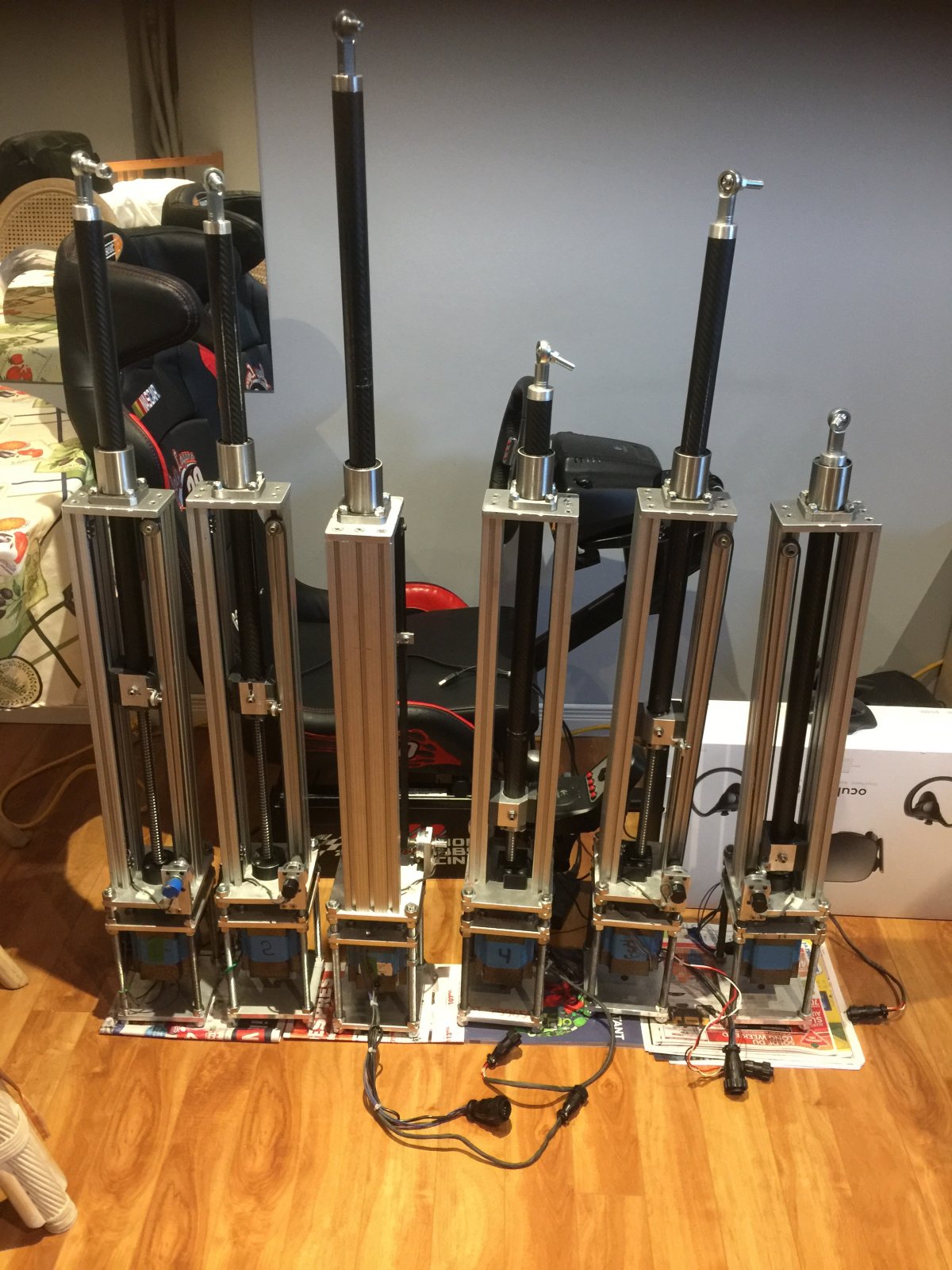

    DC motor, 6DOF
    photo frame.jpg up date platform and set up
  3. Flymen
    May 19, 2018
    355
    Montreal, Canada
    2,503Coins
    +196 / 2 / -0

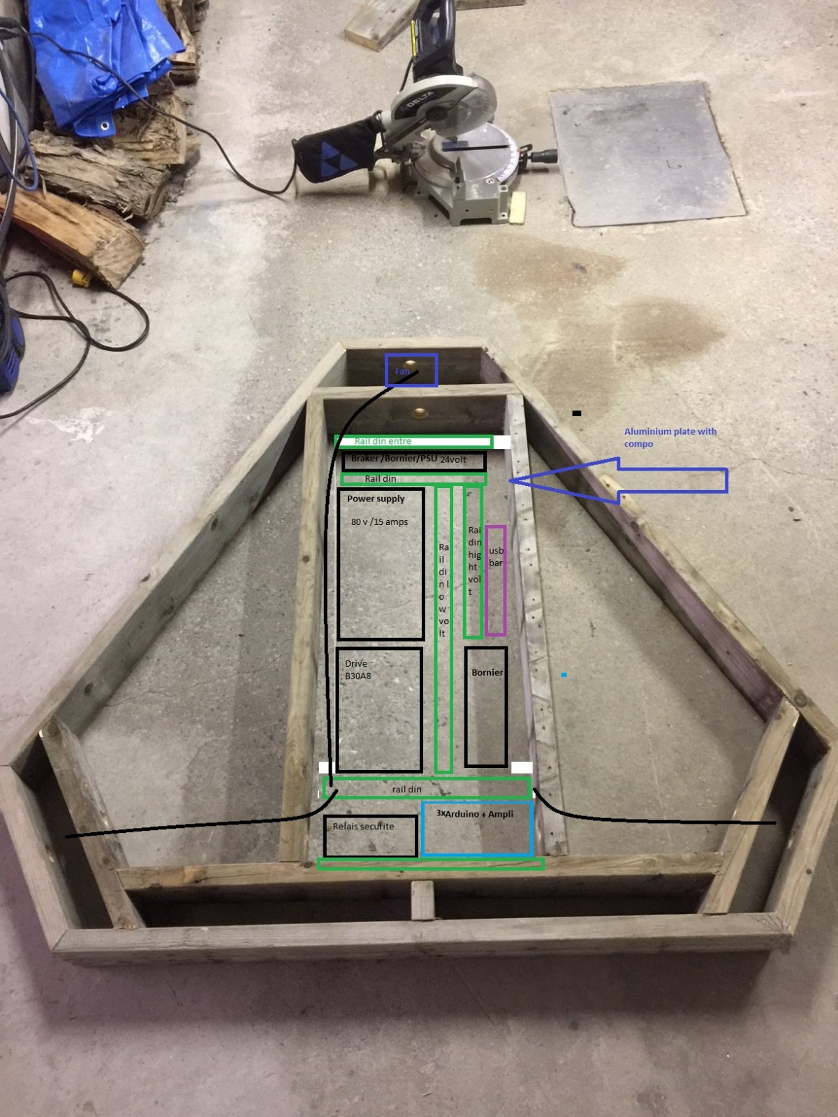

    DC motor, 6DOF
    Need your suggestion before to hold everything , thanks !!! SilentChill, pmvcda, Pierre Lalancette, sixdegreeofflight,seattime, and all of us !!!!

  5. Thanos
    Jul 6, 2017
    1,381
    Electronics Engineer
    United States
    2,931Coins
    +1,080 / 10 / -0
    Can you make a list of the parts you have to see compatibility?
    Motor drives model?
    Encoder model?

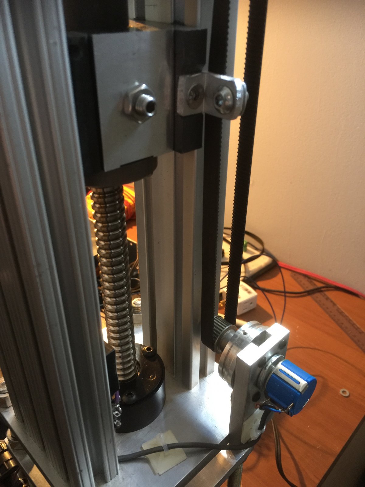

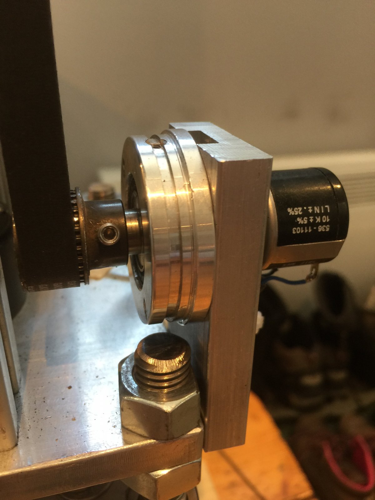

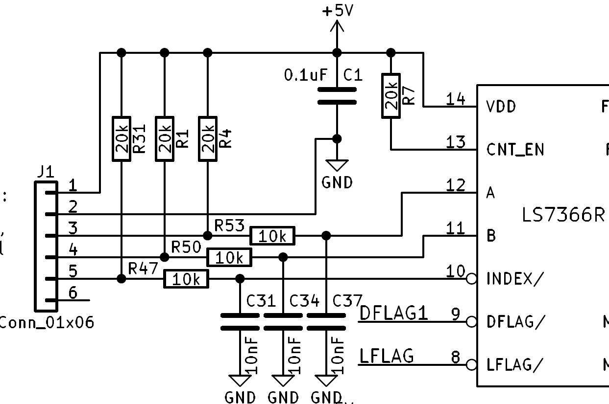

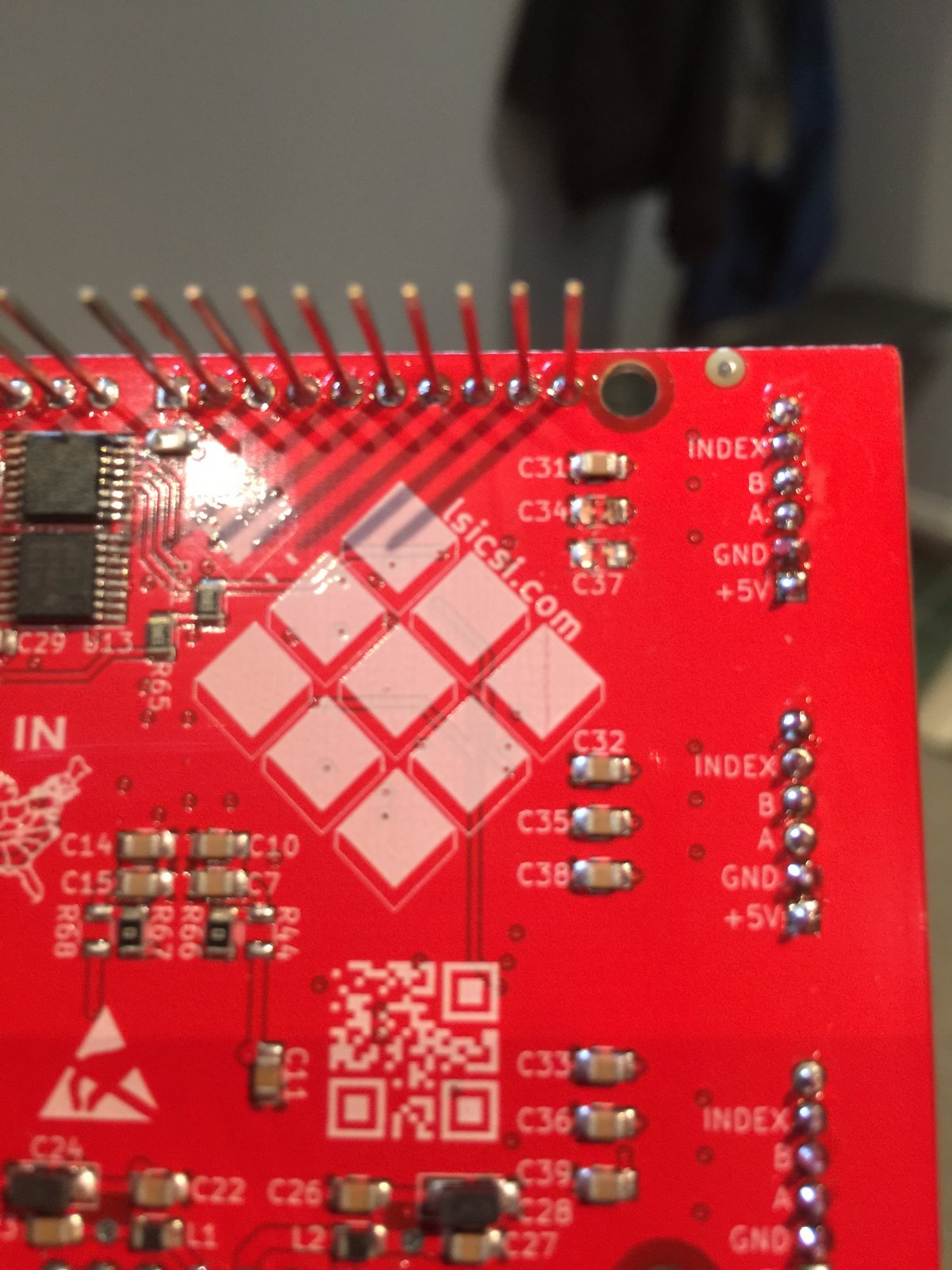

    Some good news and up date !!!!:)
    A - Encoder rotary with LS7366Rsh problem with 200 ppm (RHS15)
    1. Speed ( 1700 rpm) with signal A and B 2v/div , 20us/div . Arduino monitor serie counter work good ( 0 – 1700 rpm ) . https://www.youtube.com/watch?v=gh4fTqsVAyk
    2. Speed ( 3900 rpm ) ) with signal A and B 2v/div , 20us/div . . Arduino monitor serie counter stop 1800- 3900 rpm ). https://www.youtube.com/watch?v=3yd8UW7-7aQ
    3. Speed 0-3900 rpm both sides and stop . https://www.youtube.com/watch?v=gcnw1yKj_hU
    The problem is each capacitors of each chanel A and B . The board has low pass filters at the inputs terminals. Exemple : We must remove C37 and C34 capacitors (for channel 1).
    After this remove everything work well ! :grin Card and connectors 70$us with shipping . Thanks Ben Mignano ( conceptor )

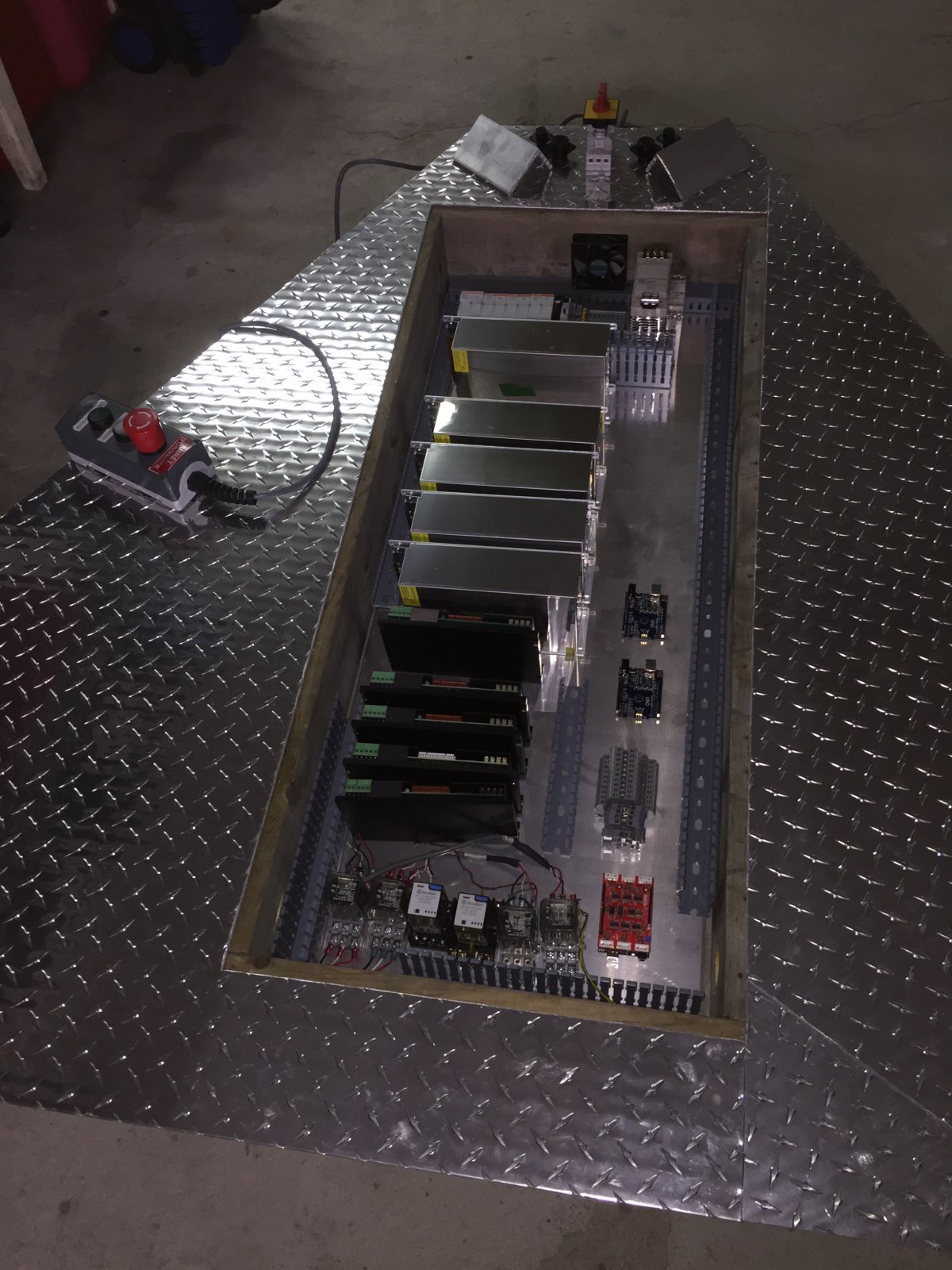

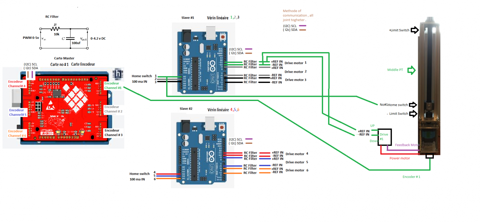

    Others solution( B) to control the drive B30A8 with Arduino 0-5 v PWM signal :
    A) (uni-directionnel PWM)with ampli 0-10 v with signal +10 /-10 volt from the drive but.. , one of my drive ( and i don't know why… may be after a couple test with ampli ) have +10v/-14 v . for this raison i will forget it because I don't want to see this incident with another drives .
    B)( Bi -directionnel PWM)This solution need two Arduino uno to control 6 drives ( one for control encoders with LS7366Rsh , and two others for control 6 drives ) .
    Each output PWM of the Arduino will have RC filter with R=10k and C=100uF = 0-4.2 v/DC to control REF IN ( drive ). Normaly this input is 0-10 volt but i have a pot ( REF Gain )in my drive to control this input at 0-5 volt or less . thanks for your code pmvcda. https://www.xsimulator.net/community/members/pmvcda.4322/
    With this drive , I have 3 Pots to control the motor ( current limit , Ref Gain and Off set ) this will help me to control of each side and power of actuator that I need when I will testing this with me on the racing chair !:think

    Hi everyone ,@pmvcda,silentchill,@wannabeaflyer,@noorbeast ,
    I would like to know if someone have this set up ?
    I have the code arduino for encoders ( card 1) but only this !
    The code is like a spaghetti for me ... and how mix those cards together !
    Thanks for your help ! :)

    1-Communication Arduino :
    SPI Communication ( Master and slaves ) :https://arduino.stackexchange.com/questions/16348/how-do-you-use-spi-on-an-arduino
    I2C comm : https://electronics.stackexchange.c...-devices-into-a-single-pin-a4-sda-and-a5?rq=1
    2- Program code idea:
    section : void setup()
    a) go at home switch( reset at zero encoder) and back at middle PT and wait there .
    This is the code for Card Master ( Encoder lineaire) .

  10. Thanos
    Jul 6, 2017
    1,381
    United States
    2,931Coins
    +1,080 / 10 / -0
    I see all the parts you are using. I can guarantee you the wiring will be a real spaghetti. I tried that approach with my AMC1280USB and encoder2position modules and signal conditioners etc. I end up using so many wires that I kept having noise issues and loose connections and wrong wiring sometimes. It frustrated me so much that I build the wiring into PCB with only absolute needed wires going to the servo drives and the limit sensors:
    The AMC-HS controller, is compatible with the servo drive on the link:
    "Differential Reference Input (±10 V Operating Range)"
    "INHIBIT IN - TTL level (+5 V) inhibit/enable input. Leave open to enable drive. Pull to ground to inhibit drive. Inhibit turns off all power devices"
  11. Flymen

    There are just crazy people who don"t change their ideas ( Il n’y a que les fous qui ne changent pas d’idées )!
    Finaly , it will be a *pot* because with encoders it too complicated . With LS7366Rsh card I could receive all pulses but transfert it with code Arduino card was too complicated for me , and I saw the coupling slide a bit from motor shaft with 50 lbs pound !! I must change the coupling for bigger and more grip ! I'm waiting for 5 others pots and couplings to set up all others actuators !

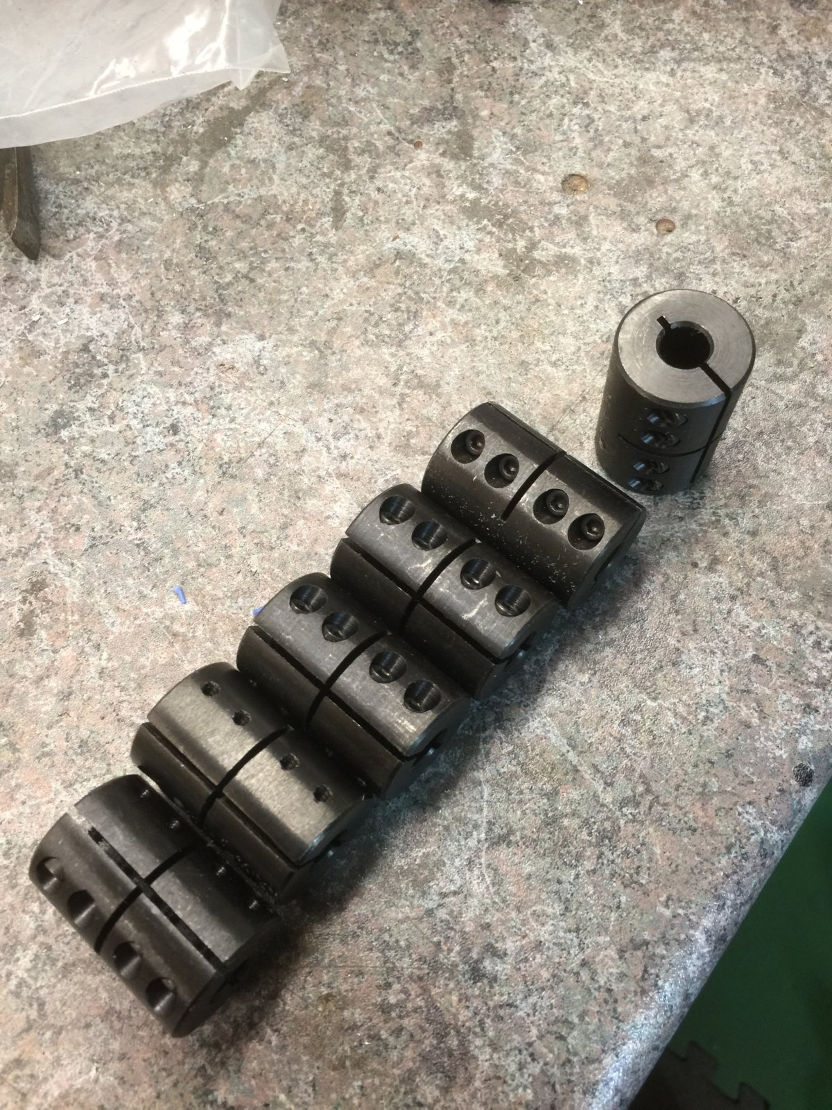

  12. Flymen
    May 19, 2018
    355
    Montreal, Canada
    2,503Coins
    +196 / 2 / -0
    DC motor, 6DOF
    This morning i received all coupling to set up actuators !:thumbs
    they are really stronger and more powerful grip !!!
    with Dirt rally, anything will slip on shaft with it !:thumbs

    DC motor, 6DOF
    Hi everybody ,
    the six actuator are finished and running on SMC3, but a few are diferent than others .. like the problems with the cheap chinese…. lead screw ( curve , mark or spot on them and, noise and vibration) potentiometer destroyed by my fault or parasite in the signal, dimention of carbon tubes in the insert (two are diferent and more resistant and leaves some printer mark ). I will make some video …. the test will be with 60 pounds each with her drives to try to put them identical or similar ( speed and torque )
  14. Gadget999
    2,028
    12,365Coins
    +498 / 11 / -0
    how many turns do your pots have ?
  15. Flymen
    May 19, 2018
    355
    Montreal, Canada
    2,503Coins
    +196 / 2 / -0
    DC motor, 6DOF
    Vishay 10 turns , 10 k ohms
    The pots( cable) are very sensible to noise . exemple: wire extern , this cable must be alone or shielded with ground at both sides.,and the pot must rotate free with no pressure !!!
    It why I maded it with bearing système !!see pics

    It's no easy to set up this and find a good tuning !! I need of yours ideas !!SilentChill, pmvcda, Pierre Lalancette, sixdegreeofflight and otherss
    60 LBS charge x 6 = 360 lbs total charge ! why : 200 lbs= Body , 120 lbs= Racing chair and more , and extra 40 lbs

    It looks like a good powerful actuator :)
    Does the pot signal in the smc program bounce when the actuator is bouncing ?
    I suggest you try a few exoeriments with the pid
    Double the I number and see what happens
    Double the d number and observe
    And again same for P
    If it gets worse cut the numbers in half
    P is how hard it pushes
    I is how quickly it responds
    D is how smooth it stabilises
    What motors are you running ?
