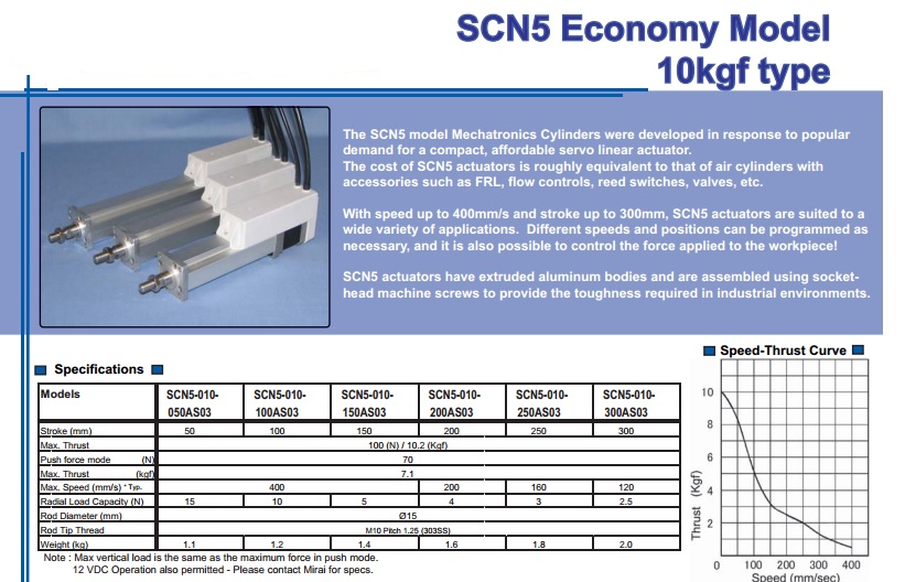

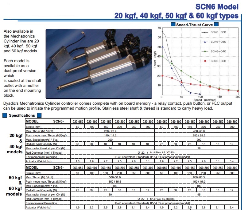

  13. SeatTime
    2,573
    If it is anything like the SCN5 or SCN6 then at max load they are basically not moving at all and their stated max load is not for a vertical lift. Vertical lift is called 'Push force Mode' or 'Push Mode Max' which can be quite a bit less. See specs below: Have not seen specs for the above 100 KG model.

    My rig is being custom made by TopSpeed. They assured me that SCN6 will be more than fine to move 500 lbs.
    I can’t find anyone here who has actually done the calculus. But these actuators are used by several firms with good results.
    It’s not easy to work this out mathematically. The actuators are not purely vertical, and you have a front pivot in a full motion rig like the TopSpeed. So you can’t judge based on the spec sheet.
