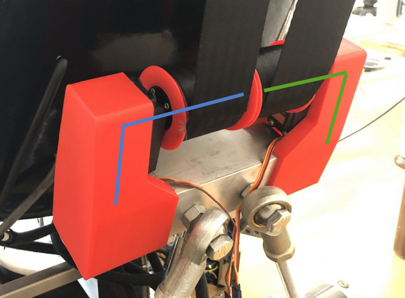

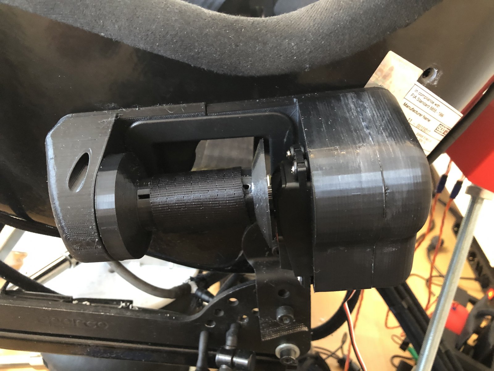

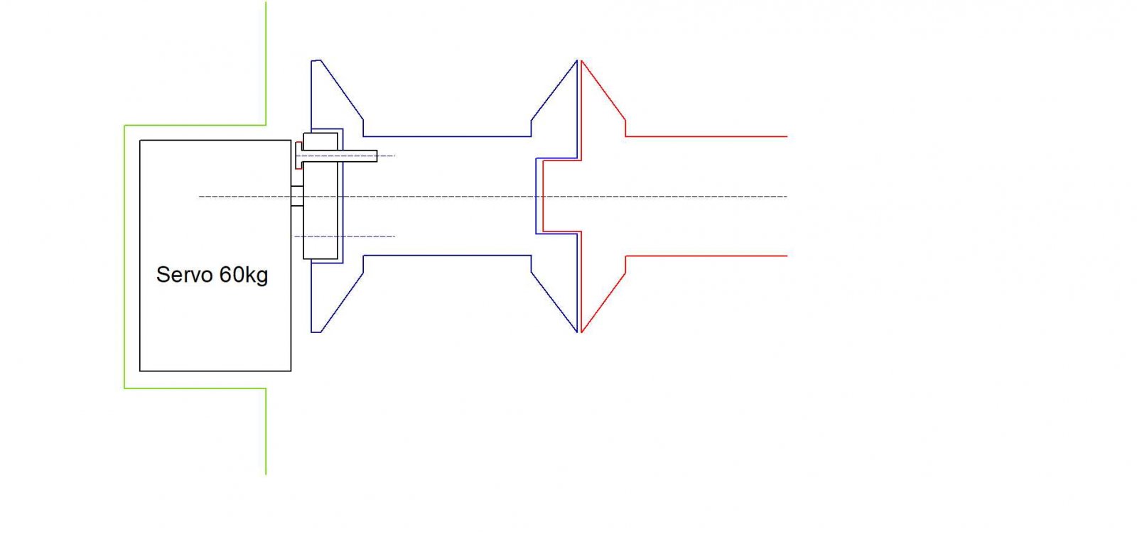

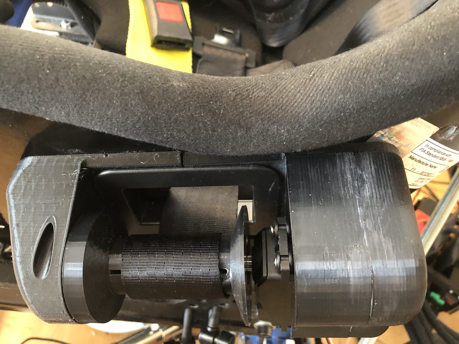

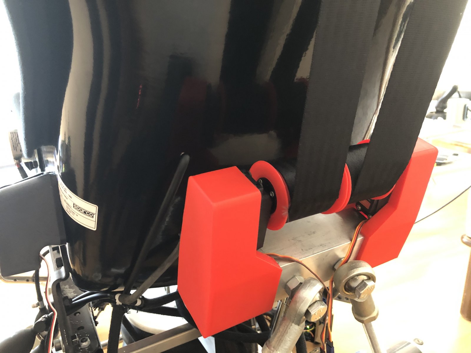

  8. RacingMat
    2,237
    21,049Coins
    @xxpelle : very nice harness tensionning system!
    Please, I have some questions for you :)
    How is connected the servo to the roller?
    Are the roller cantilevered at the end of the servo? I'd be have been afraid that they bent...

  12. JimboJet
    JimboJet New Member
    Jun 6, 2021
    30Coins
    3DOF, Motion platform
    Hi Torsten, Firstly congratulations on a fantastic yet simple kit to provide pneumatic G-Seat capability. I have downloaded and am in progress printing the 3D parts on my Ender3. (im also trying to source the additional parts).
    Can I ask two things please:
    1. Was everything included in your download zip for the servos/pneumatic bags as the picture you have here has some round clips and also a rectangular cutout which were not in the download, not sure if I need them?
    2. Is your 'current' Arduino code the same as you uploaded in 2018 or has anything changed, i.e do I need a refresh of the code?
