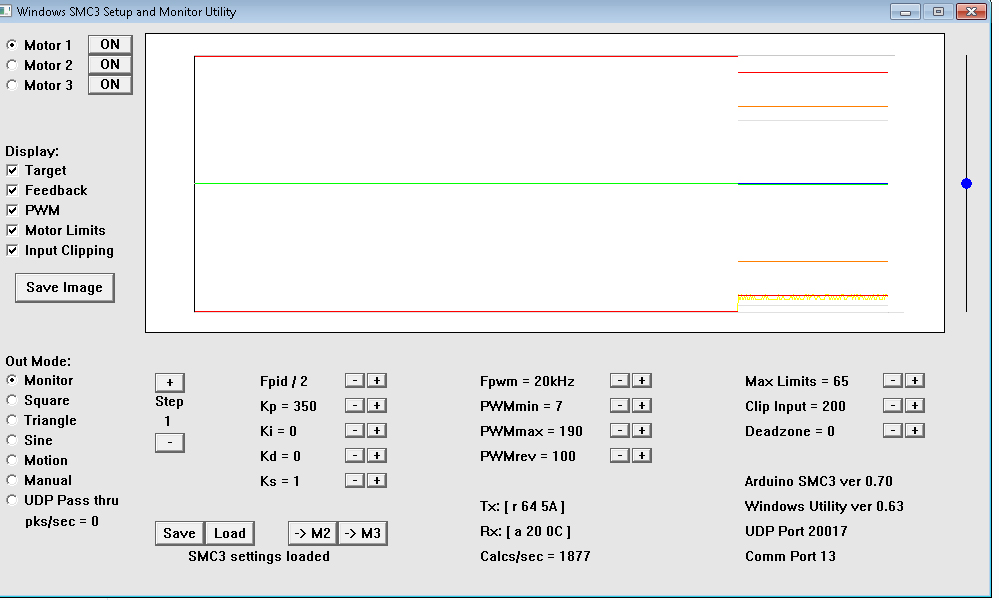

    @tombo would you mind sharing your SMC3Utils configuration?
  17. tombo
    tombo Active Member
    Oct 5, 2013
    269
    2,443Coins
    +246 / 2 / -0
    DC motor, Arduino
    Here they are,
    I don't know if they are good because I still mess up with my motor settings too.
