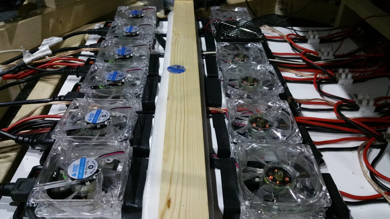

    Hi @Vef445 I have all my PSU's in parrarell like robbie said and custom fan cooling it's very easy to do.
    Hope this helps a little :)

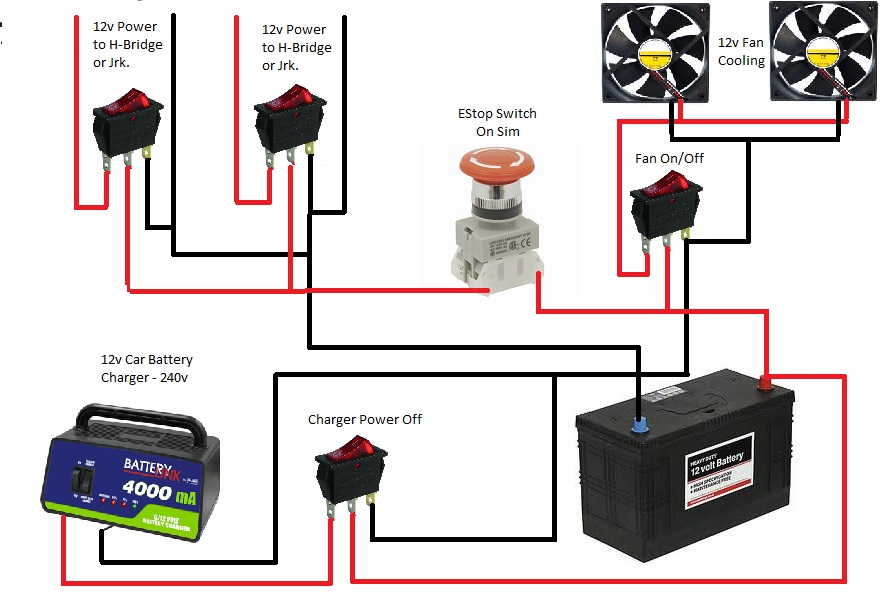

  11. eaorobbie
    20,503Coins
    +1,687 / 23 / -2
    My power setup, poor man PSU and Battery is in protected with fan filter air case too.

    Nice mounting @SilentChill , very impressive. It might help later, for now I have a battery car plugged on it and it's still bot good :(
