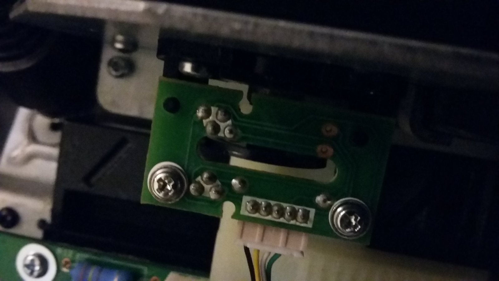

  13. OZHEAT
    OZHEAT Active Member
    Oct 26, 2015
    208
    Australia
    2,458Coins
    +106 / 6 / -0
    3DOF, DC motor
    @Pedro Pablo
    Is the encoder loose on the shaft?
    I would say it is slipping. Turn your wheel while looking at the encoder, does it spin. If spin try gently putting finger on encoder, does it slip or spin.
    l would say it is slipping freely now.

  15. OZHEAT
    Oct 26, 2015
    208
    Australia
    2,458Coins
    +106 / 6 / -0
    3DOF, DC motor
    @Pedro Pablo
    Are there broken spokes on encoder? if not just apply the fix for slipping encoder wheel.
    Don't try to remove but get some nail polish and put less than a drop between shaft and encoder, let dry then try.

  17. Pedro Pablo
    Pedro Pablo Active Member
    Dec 7, 2015
    119
    Software Developer
    Valparaiso, Chile
    599Coins
    +47 / 0 / -0

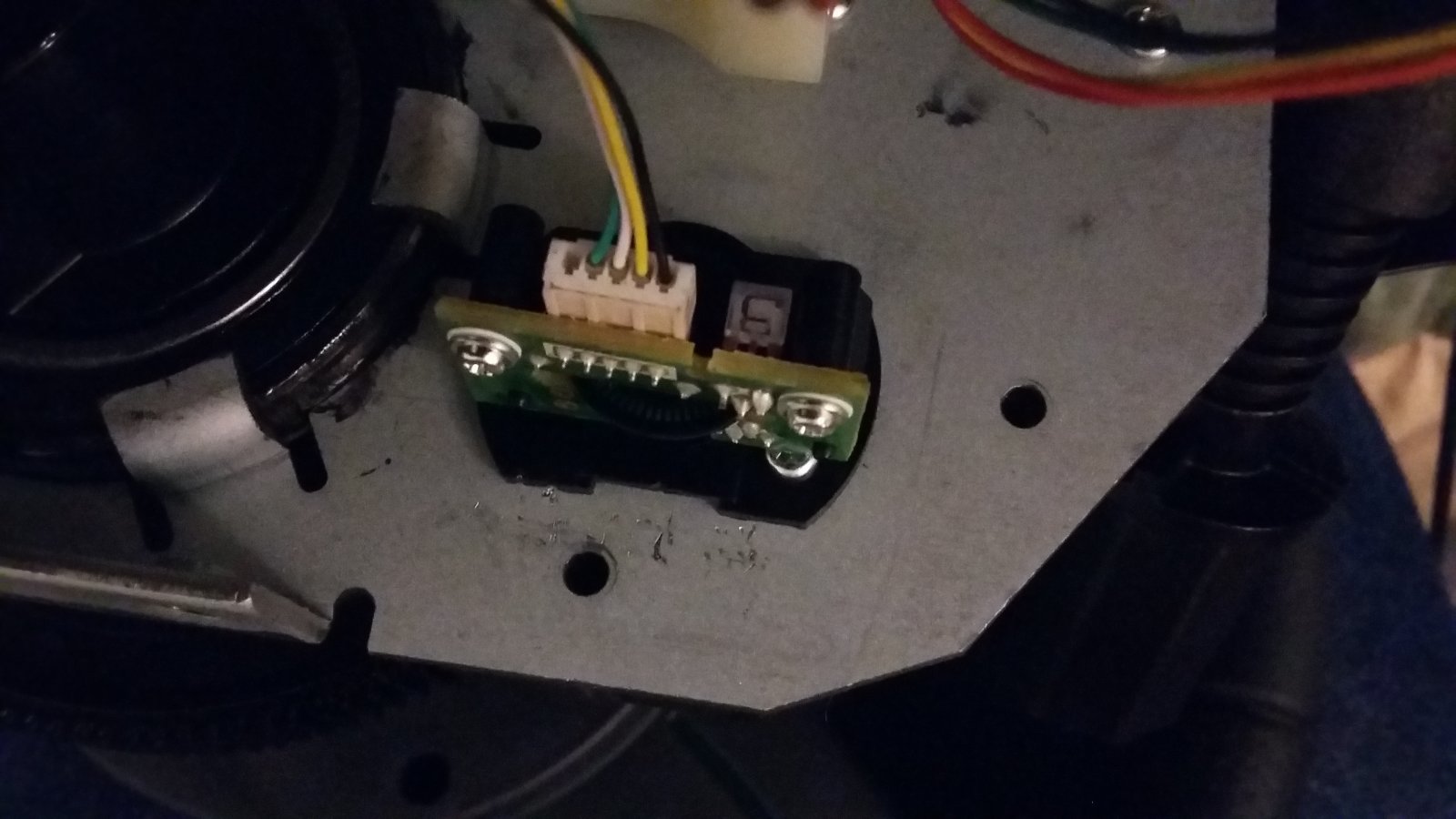

  19. Pedro Pablo
    Dec 7, 2015
    119
    Software Developer
    Valparaiso, Chile
    599Coins
    +47 / 0 / -0
    First to all, happy new year for everyone!
    Second, on the next day of the last post i've connected the wheel and guest what. IT WORKS AGAIN! But now it's make a cranky sound when it turns. but nothing seious. I'm thinking to lubricate it with grease on the gears soon, but IDK what kind of grease. Also, i've checked that the encoder wheel is not 100% straight or parallel with the electronic board, but IDK that will be a problem.
    Now the encoder looks like this (noise included)
    And if you ask me if the vibration still present, yes, it still present, but for now im not going to touch the wheel again, well, only for play and to bring it to some conventions (hoping that the users will be careful)
