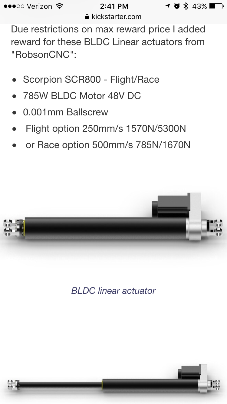

  8. Hoddem
    Hoddem Well-Known Member
    Sep 27, 2016
    404
    Engineer
    Minnesota, USA
    3,343Coins
    +717 / 2 / -0
  9. RobsonSwiss
    RobsonSwiss Active Member
    Jun 12, 2017
    114
    Preotria, South Africa
    35Coins
    +198 / 2 / -0
    Yes for actuations, there was a stage where the campaign appeared to stall a bit and I offered to provide some actuators at a good price if it would help the chances of success(which in the end certainly wasn't necessary) but I have committed fully to the belt drive style now, screws are easy and cheaper to design and make and they are great for high loads, but for low mass simulators that doesn't have that much weight to push around and 3000RPM rotation they just aren't a great choice... Efficiency goes down, inertia goes up etc. The original idea was to give the plans out for free with actuator sales but there is a lot of machining required so it ended up making more sense to offer a DIY kit rather than plans.
    The site wasn't meant to be "findable" though and isn't meant to be used at this point while some ideas and layouts are still being tested, but eventually for kickstarter backers, when I have some videos up and are ready, we'll offer a discount coupon for a short period on the actuators, which will be a further 10% reduction over the initial 10% reduction offering planned.
