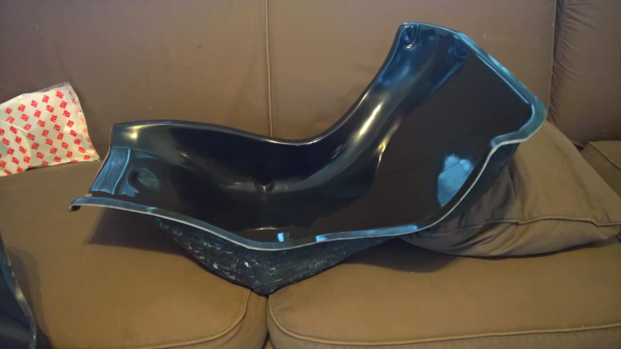

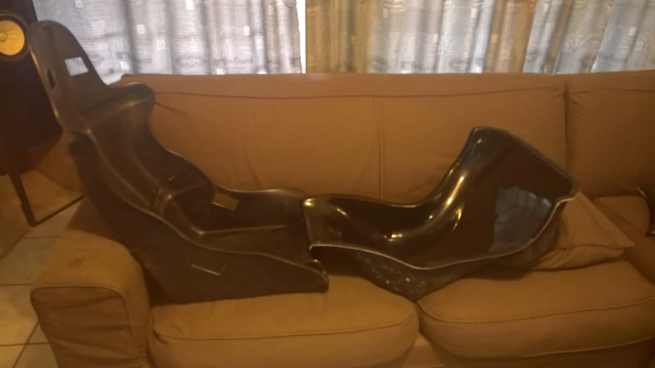

    Speaking of F1, the seat came out great, sits great too!
  8. SeatTime
    2,573
    Love the seat :thumbs and your profile seems to be heading in the right direction. Have you actually ridden in the rig yet? It always surprises me how violent it often looks from the outside when I throw someone else into my rig - feels right though when I'm sitting in it with the VR headset on. As you may know, I got around all of Simtools and 'small' simulators in general shortcomings by fitting a Gravity system.
