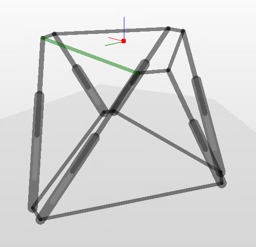

    1. The Hardware COR
    Let's assume we have a 6-DOF hexapod with linear actuators (of course the following applies to any other type of rig accordingly):
    With all actuators extended at 50% (i.e. the platform is in its "neutral" position), the COR of the platform is at the point marked with a red dot in the above image. If there is only movement around the pitch, roll or yaw axis, this point will not move relative to the ground. The actual location of this point is defined by the physical measurements of the rig (L1, L2, L3, L4, Middle and Range) and needs no further parameters. I'll call it the "Hardware COR" or "H-COR".

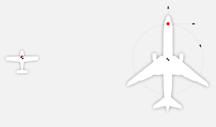

    2. The Vehicle COR
    As described on FlyPT Mover's page Center of rotation, a simulated vehicle (be it a car, aircraft or whatever) has a "Center of gravity" (CG), and the rotational motion data (pitch, roll, yaw) is given relative to that CG (which makes it the "Vehicle COR" or "V-COR"):
    While FlyPT Mover has three places in which this offset can be defined, the only one that really makes sense is the one in the source module:
    There is no documentation regarding the sign of these three values, so I can only guess that "forward", "right" and "up" are the positive directions. The above page says that these numbers "define the position of the pilot". However, it doesn't say which part of the pilot. Is it the head, the center of gravity, the seat, the floor? Of course the (center of the) head would make the most sense, since motion simulation is all about stimulating the vestibular organs of the inner ears.

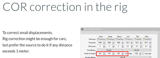

    #4 Correction in the rig
    So the rig is making rotations. We can say around wich point it makes those rotations.
    In hexapods, we can set the point anywhere, and by default, it's the center of the moving platform, but in rigs with feet, the rotation is made on the floor plane. You can change sway and surge positions with effect in pitch and roll, but not in heave.
    To correct in heave the feets would need to slide on the floor. Those limitations apply to other rigs in diferent ways.
    Sometimes I say we can make the correction we do in the source inside the rig module but only for short distances (maybe 50 cm maximum). That's what happens with cars, where, for example the COG is in the middle of the car, and you sit on the left or right.

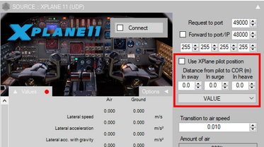

    OK. Now there's a checkbox "Use XPlane pilot position" in the "SOURCE::XPLANE 11" window. Obviously XPLANE 11 knows nothing about the actual construction of the simulation platform in use, so what are they referencing?

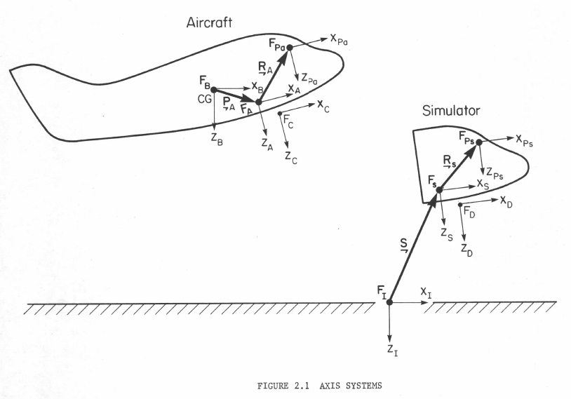

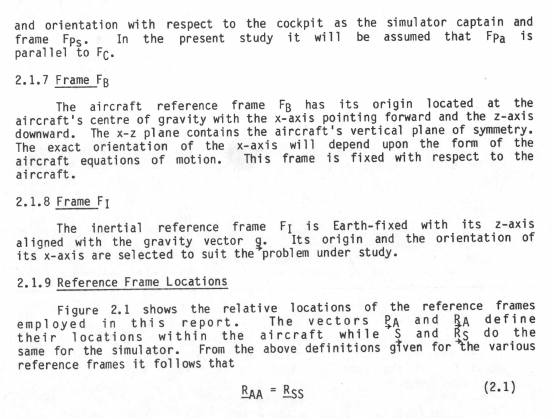

    @pmvcda I don't know if you know this document:
    https://repository.tudelft.nl/islandora/object/uuid:45b071c0-0568-4e8f-948f-dfa52d350665
    It appears to be a pretty fundamental paper on motion simulation. While I don't claim to understand even a fraction of it, I find the information in chapter 2 quite interesting:
    The most interesting parts here are the vectors Ra and Rs (A and S are indices, but since I can't write indices here I made them lowercase). Let's, for simplicity, assume that Fa=Fc and Fs=Fd, then it becomes clear that FlyPT Mover is lacking the value for Rs (the offset of the pilot's head from the COR of the motion platform).
    This sounds to me like you would just hand this data over to OXRMC, but not include it in your own calculations. From the above definitions I believe that Rs always needs to be taken into account when generating motion cues. Not only for Motion Compensation in VR, but also if there is no VR, but rather an enclosed cockpit with monitors or projectors.
    With all this in mind, I'd like to make the following suggestions:
    • Rename the "Center of rotation" entry fields in the RIG module to "Pilot's head position" (or words to that effect), which is the distance between the COR of the motion platform and the center of the pilot's head.
    • Have any COR correction done in the SOURCE module, where it belongs (COR corrections in the POSE module may be left untouched).
    • Take the "Pilot's head position" into account when processing motion cues, regardless of whether the simulator uses VR or monitors.
    • Make the "Pilot's head position" available to the motion compensation software, so we don't have to enter it twice (apparently already planned for the next release).
    What do you think about this?

    In XPlane11, I don't remember now, but I think the values they give us are for the floor of the cabin.

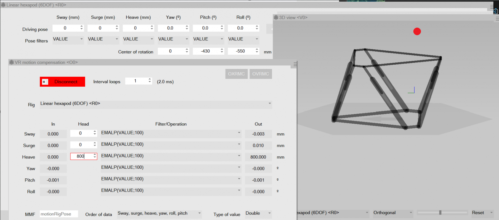

    I am setting COR in Mover 3.7,
    is this the correct way to set COR? See pic, red dot is head location.
    In motion compensation head location I put measure from COR to real head location?
    With these in OXRMC config I put zero to COR?
    I have rig where seat is below the top joints of rig.
