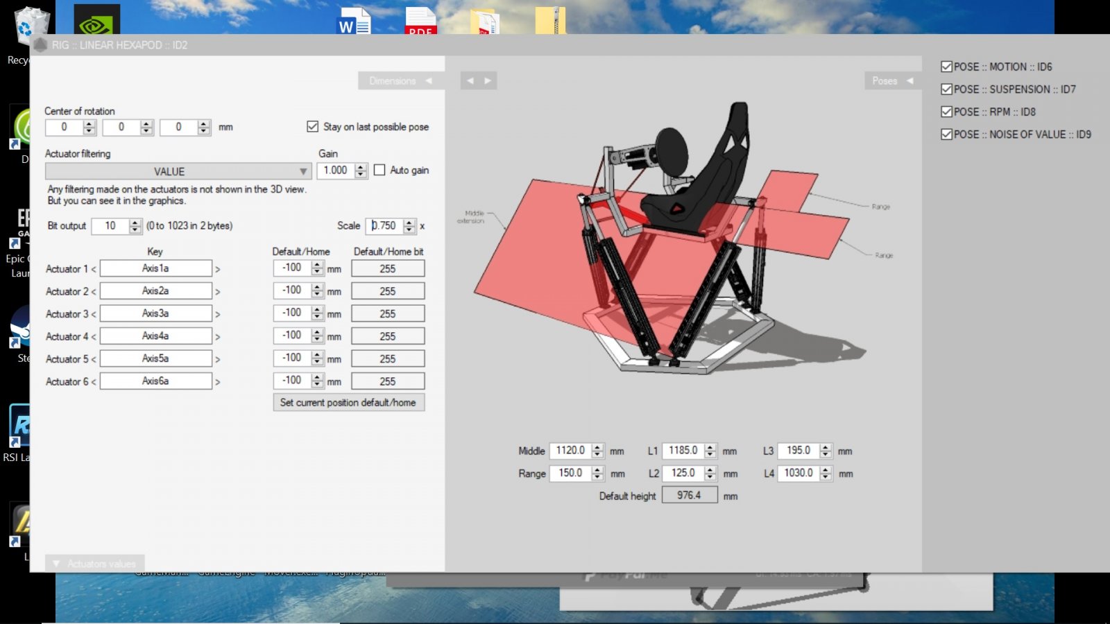

    i like to refresh my understanding for setting up a mover profile.
    i believe the RIGS module is the where the important parameters have to be entered,
    please correct me if i am wrong, but this is my understanding for the rig paramters
    Middle - total physical length of actuator at half of its full stroke plus the actuator itself
    Range - half length of the actuator stroke range
    L1, L2, L3, L4 - as depicted in mover
    RIGS Center of Gravity (CoG)
    i am not sure about this one. can it be the following?
    a) point at where the base of the chair is located relative to the center of the hexapod?
    b) point at where your butt is placed on the chair, relative to the center of the hexapod?
    c) the center of the hexapod?
    Singularity Angle
    I leave it at 10 degrees, though i dont think my 6Dof will ever reach this angle, it would be nice to know how to figure out the best value.

    I may have a few of the answers:
    Middle and Range are well depicted in that picture:
    If I am not mistaken, the Center Of Gravity is where the rig will turn. Its pivot. So, if you want to simulate a real car, you put it a bit aside and behind you so the rotation of the rig simulates the rotation of the car. I always put that to my hips in the rig, because putting it somewhere else may limit the movement your rig will be able to do.

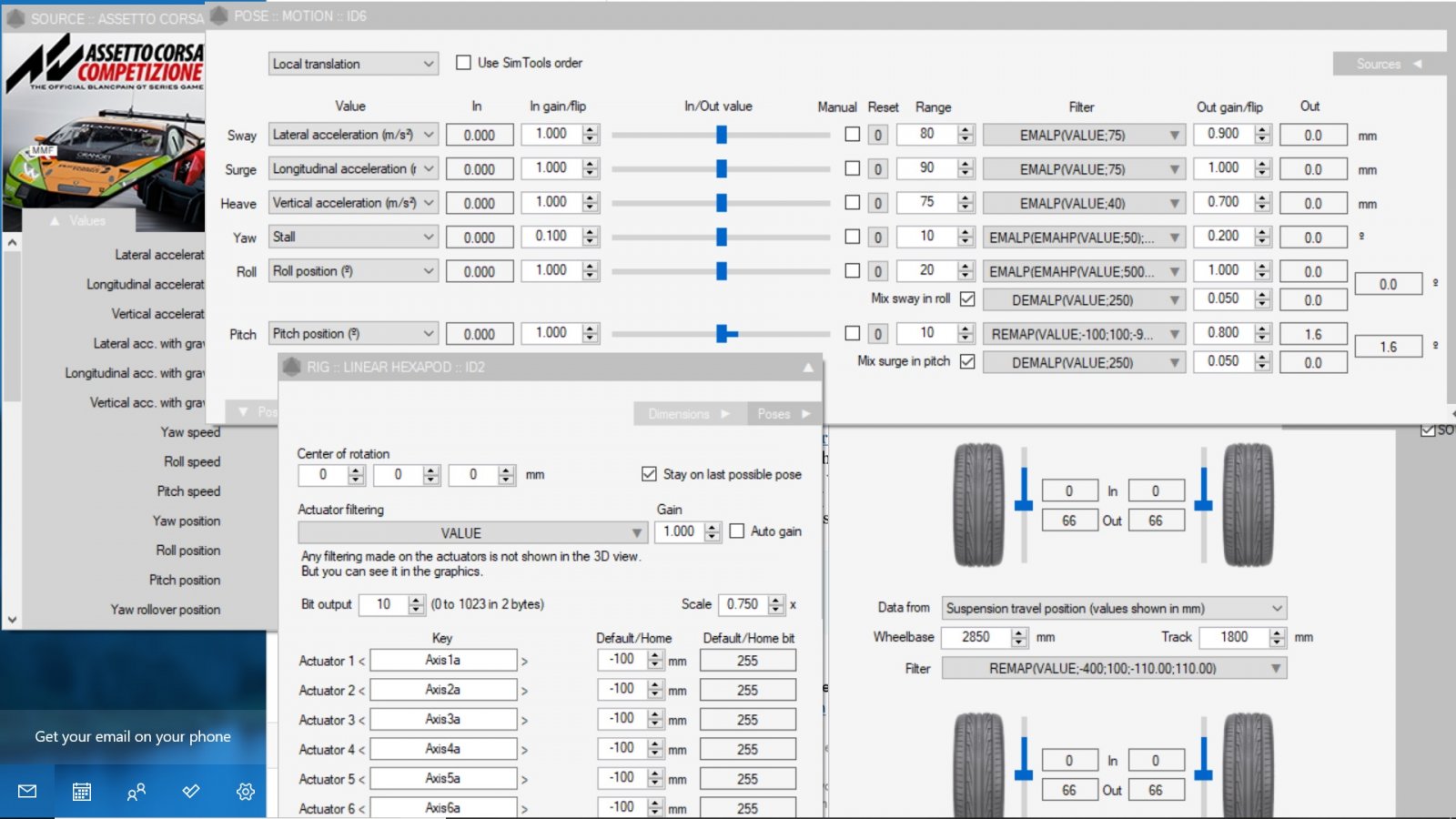

    if the game sends telemetry of 45 degrees of roll
    and let say if you want to have the 6Dof respond with only 15 degrees of roll, is it better to adjust the IN gain (pre filtering) or better to adjust the OUT gain (post filtering) for the final result?

    It depends if you want to treat the signal with filters (out) or if you want to make sure that the signal never reaches higher than a certain level (in).

    The center is where you want it. It is the center of the vehicle you are using: car, plane.
