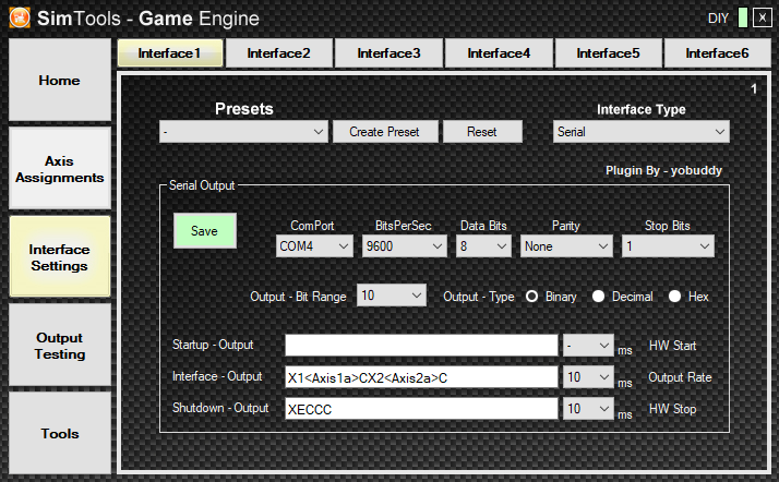

    As to your problem please post pictures of all of your settings, particularly Interface Settings and Axis Assignments.

    Sorry I didn't speak English and I thank you to answer me anyway. When I test with the menu ' ouput testing ' the simulator responds correctly.
    Here are my settings

    If games other than Ultrawings work, then it's probably an issue with this plugin. This is a memory hook plugin, which means that it can sometimes break when the game is updated. There have been several updates to Ultrawings since I last worked on this plugin, including an update just two days ago.

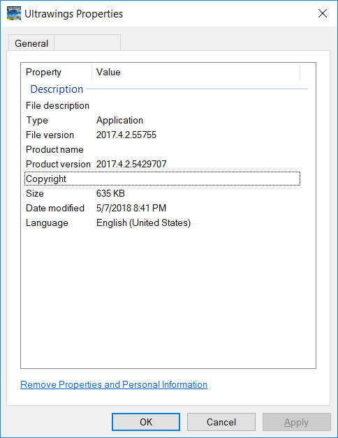

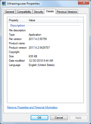

    Yeah,I tried going into steam to find a older copy of the game,any chance you could take a screenshot of Properties of Ultrawings 2018-12-29.png

    The properties of my version looks the same as yours:
    If it doesn't work for you, it's probably because of another difference between our systems. Memory hook plugins tend to be unreliable in that way, and Ultrawings has been particularly challenging. It's unfortunate, because there seems to be high demand for motion simulation with this game. Our best bet is to encourage the developer to add an actual telemetry API, which would prevent the plugin from breaking on game updates and remove inconsistency between systems. I tried contacting the developer a few months ago but never got a response.
