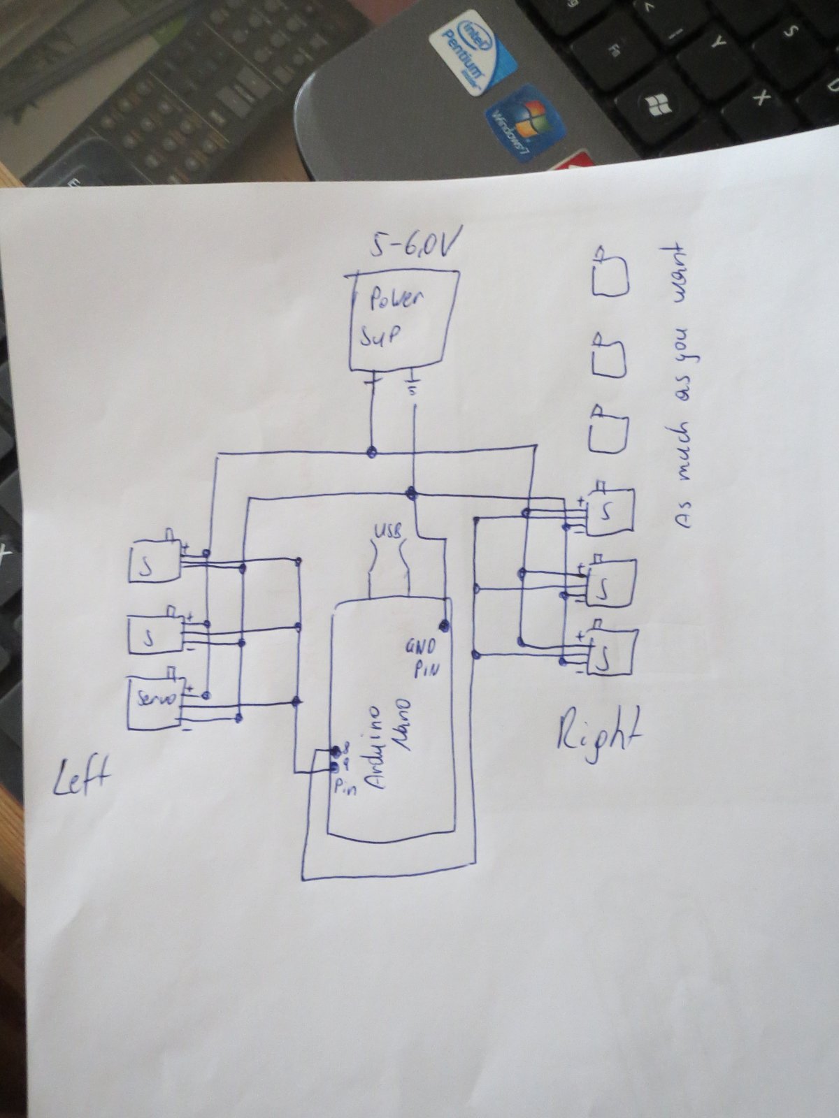

    @Roadster2
    i hope you mean a schematic like this:

    @Roadster2
    please note:
    if you want to install the servos paired like the original (face to face), you must open 1 servo and change the direction of rotation.
    if you make it like me, you dont have to change anything in/on the servos.

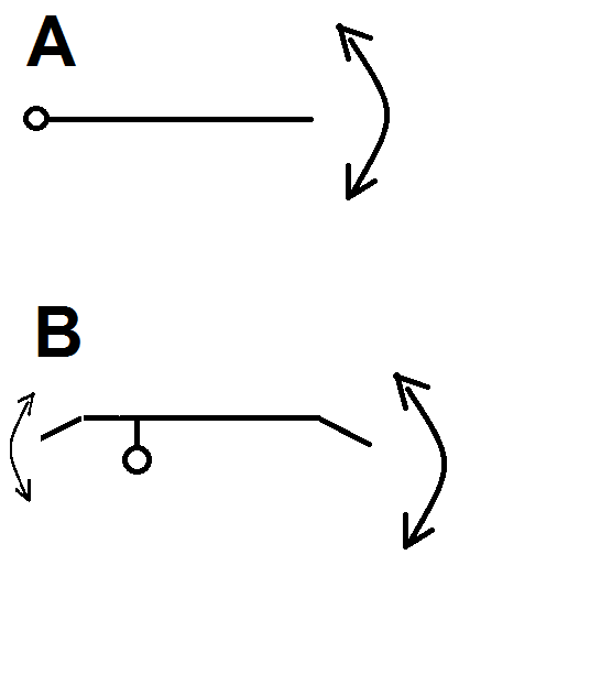

    @Schluzu : can you tell us where is your pivot point?
    Due to the shape of official gSeat plates and patent principles, I suppose that it should be B rather than A: but I'm wondering what you did and how this feels... ;-)

    @RacingMat
    if you make the Pivotpoint like A you have much more load on the Servos.
    and on the Baseplate i have the Pivotpoint under the Seatbone (Ischium)to get the maximum load to there.

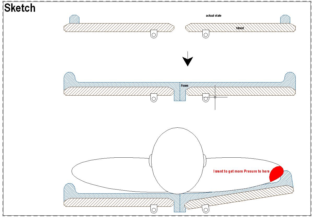

    I think one of these
    sitz.JPG Sketches feels even better.

    Yes, I agree with you: load is reduced.
    Plus it pushes in the middle of your back: while braking, you're pushed forward.
    If pivot is like A, this effect is lacking.
    For bottom plate, it pushes you upward: it simulates heave effect.

    Hi Martin. So what exactly is needed for control of the servos - 2 x Arduino Nano boards and 2 x expansion boards for ease of connections. Is anything required for programming the boards or is this done simply via the onboard USB connection. From your schematic the servos are driven directly from the Arduino boards i.e. no additional driver boards or circuits required. If I have this right it sounds relatively straight forward.
