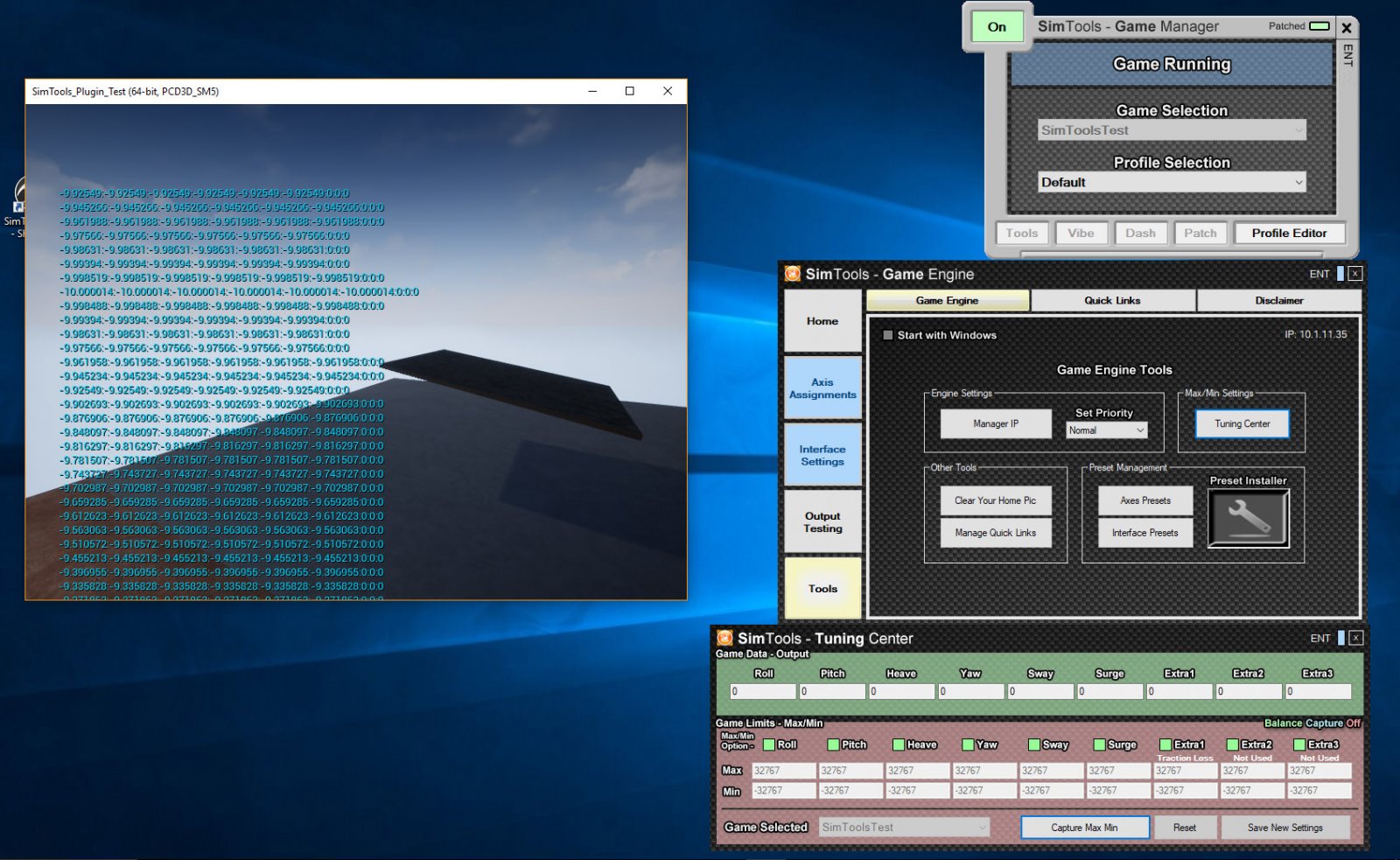

  10. Tim Armstrong
    Tim Armstrong New Member
    Aug 2, 2017
    19
    USA
    295Coins
    2DOF, 3DOF, Arduino
    Here is a pic of what I have going so far.
    I have the same value going into Roll, Pitch, Yaw, Surge, Heave, and Sway (just for testing purposes).
    The game manager seems to show it is connected to the game but no values in tuning window. :(
    21,595
    151,233Coins
    You are definitely getting there :thumbs
    What are your Interface Settings?
  12. Tim Armstrong
    Aug 2, 2017
    19
    USA
    295Coins
    2DOF, 3DOF, Arduino
    @noorbeast
    Hi noorbeast ,
    My Interface Settings have the com ports set and 10ms Output Rate with 15000 speed and 750 acceleration for axis 1a and 2a.
    However i don't think that is my issue. I can run Live For Speed without the simulator even connected and still get values being output in the Tuning Center...but i can't for my application.
    I know I am outputing proper udp packets, I checked them out in a couple of different apps and all showed the correct string being sent...I am a bit at a loss for what i am doing wrong.
  13. Tim Armstrong
    Aug 2, 2017
    19
    USA
    295Coins
    2DOF, 3DOF, Arduino
    Ok, I think I have it working now! :)
    I added a beginning and ending check character to my udp string and that seemed to do the trick!
    Once I get all the bugs ironed out I will post all my steps for anyone else who wants to make a ue4 game with simtools.
    Thanks to yobuddy for the help!!
