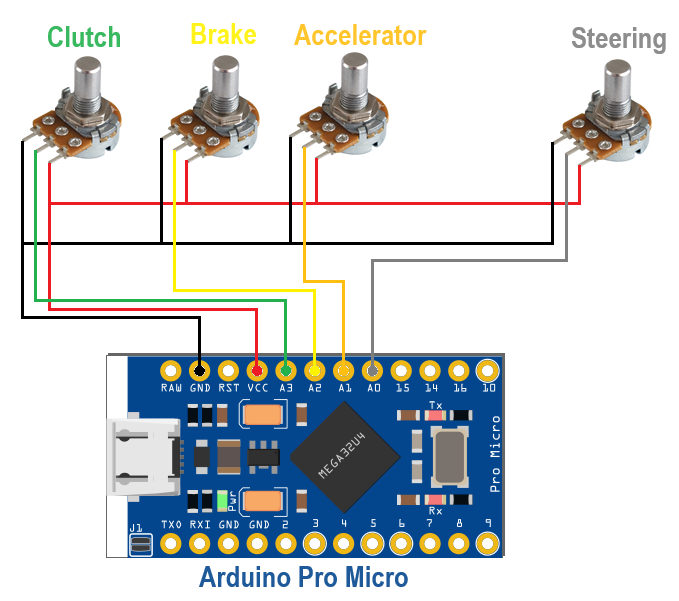

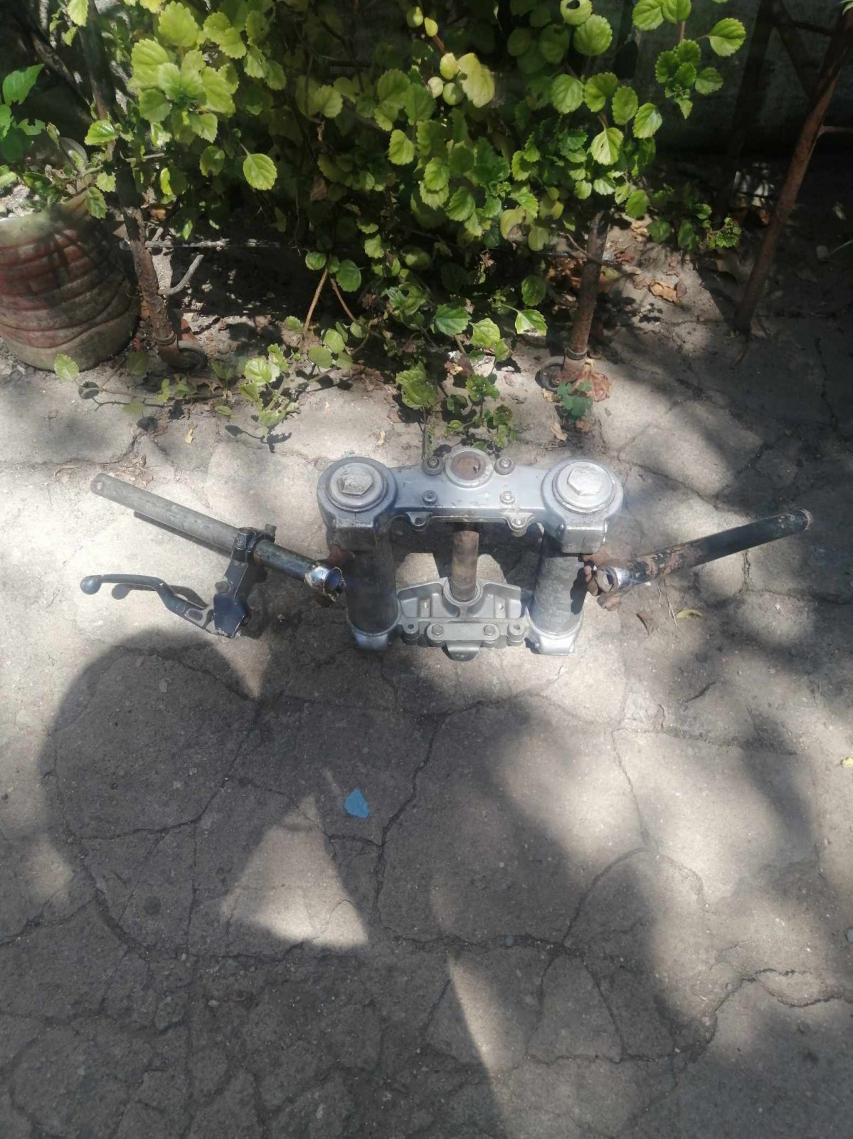

    I am making a 2dof simulator for GP-Bikes
    I share the abances with arduino
    using the following components:
    x1: Arduino Pro Micro
    x4: 1K Potentiometers

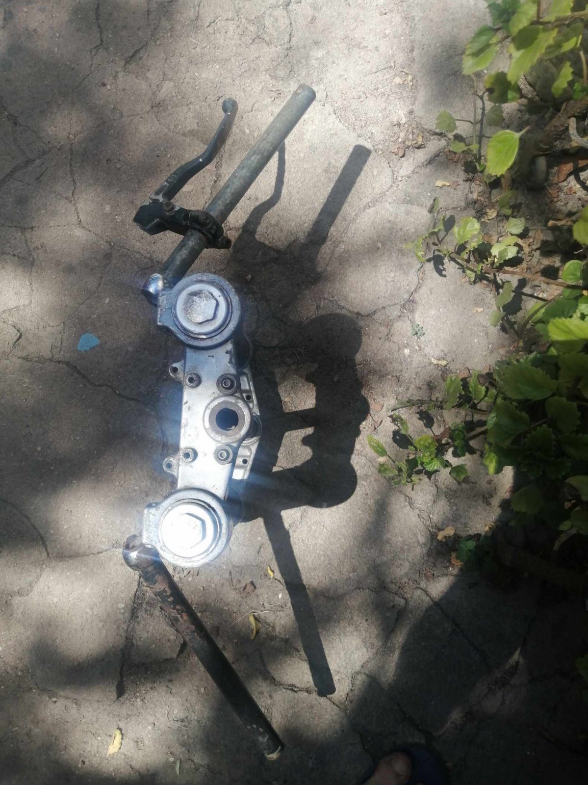

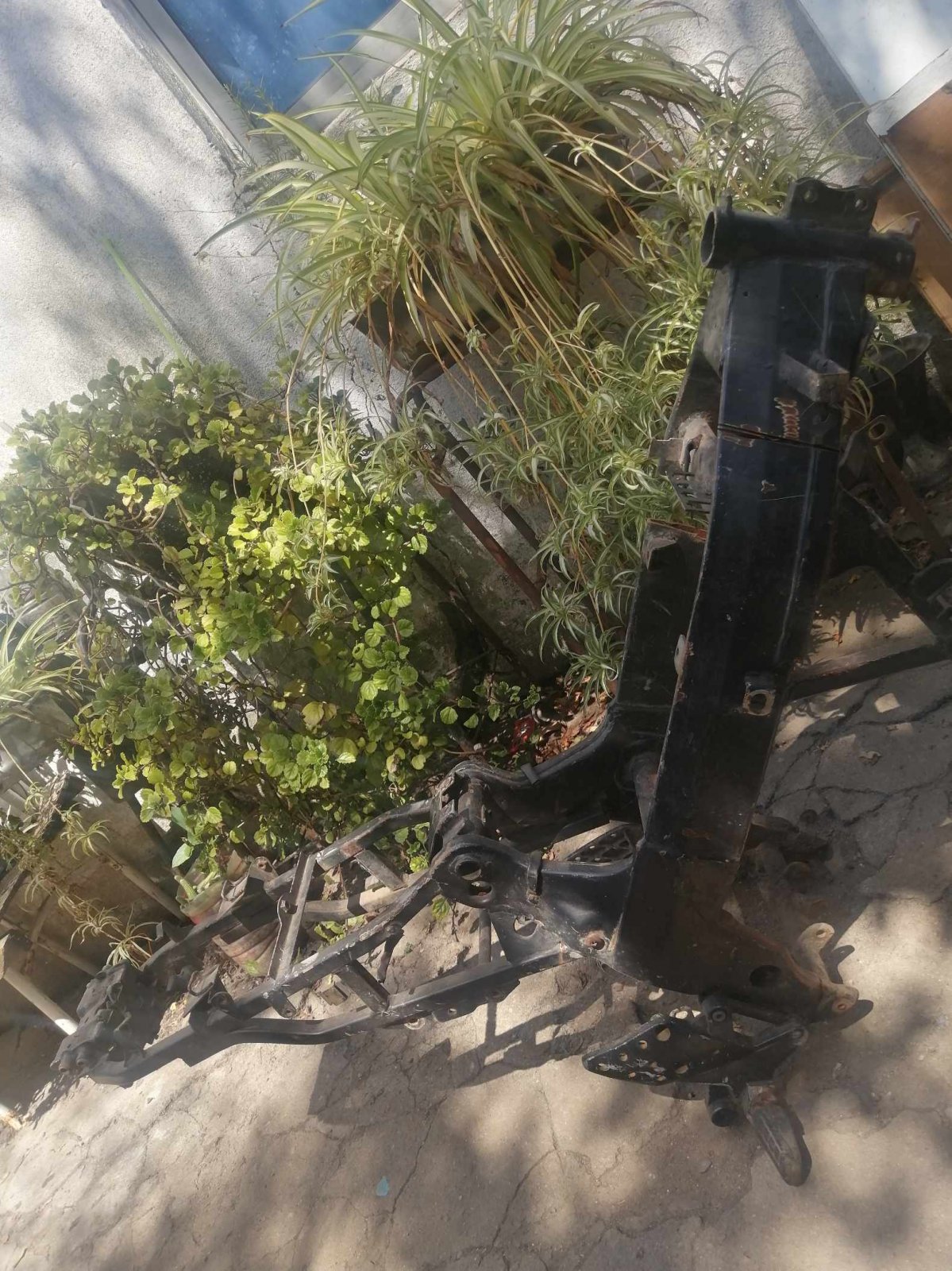

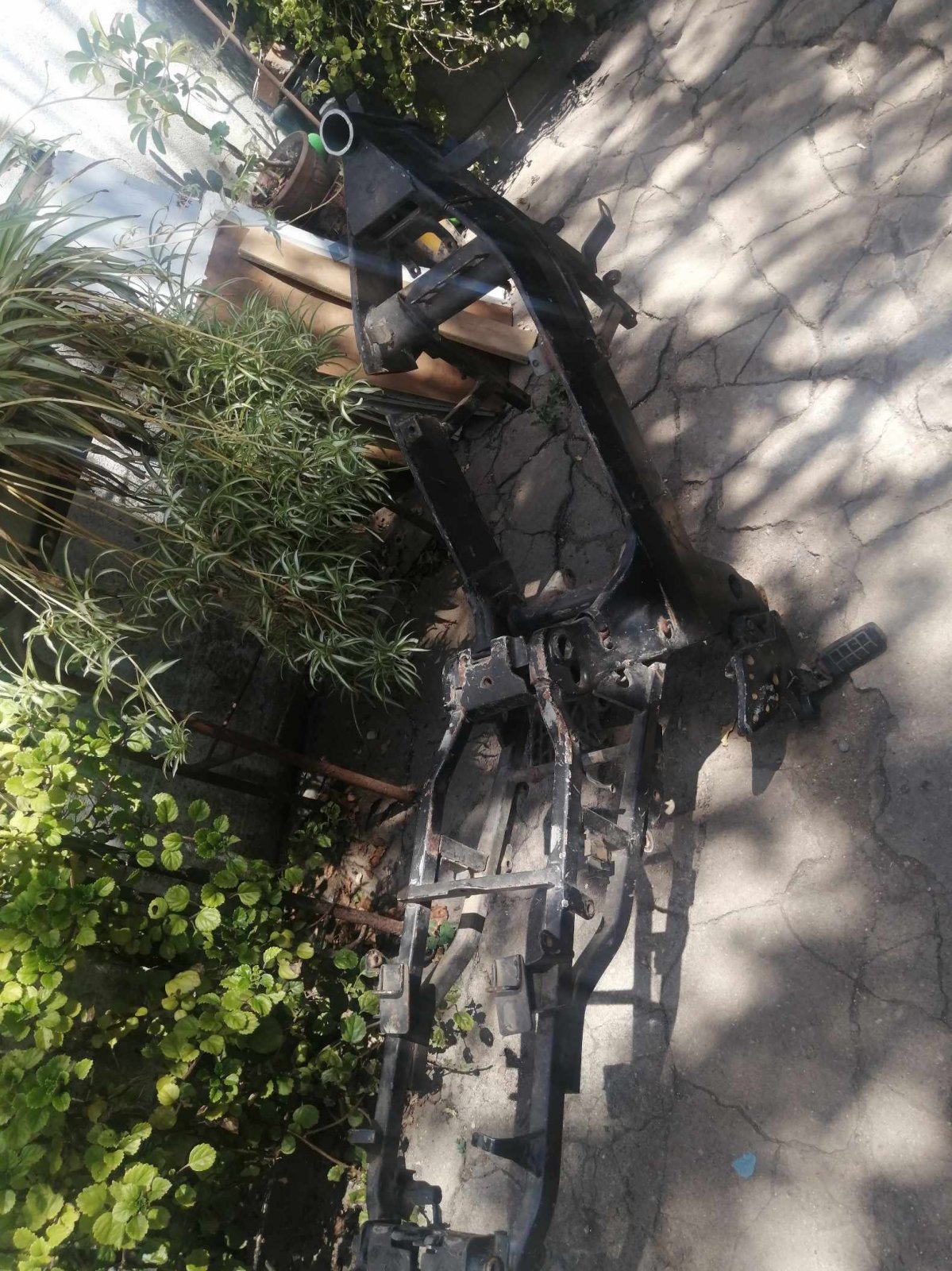

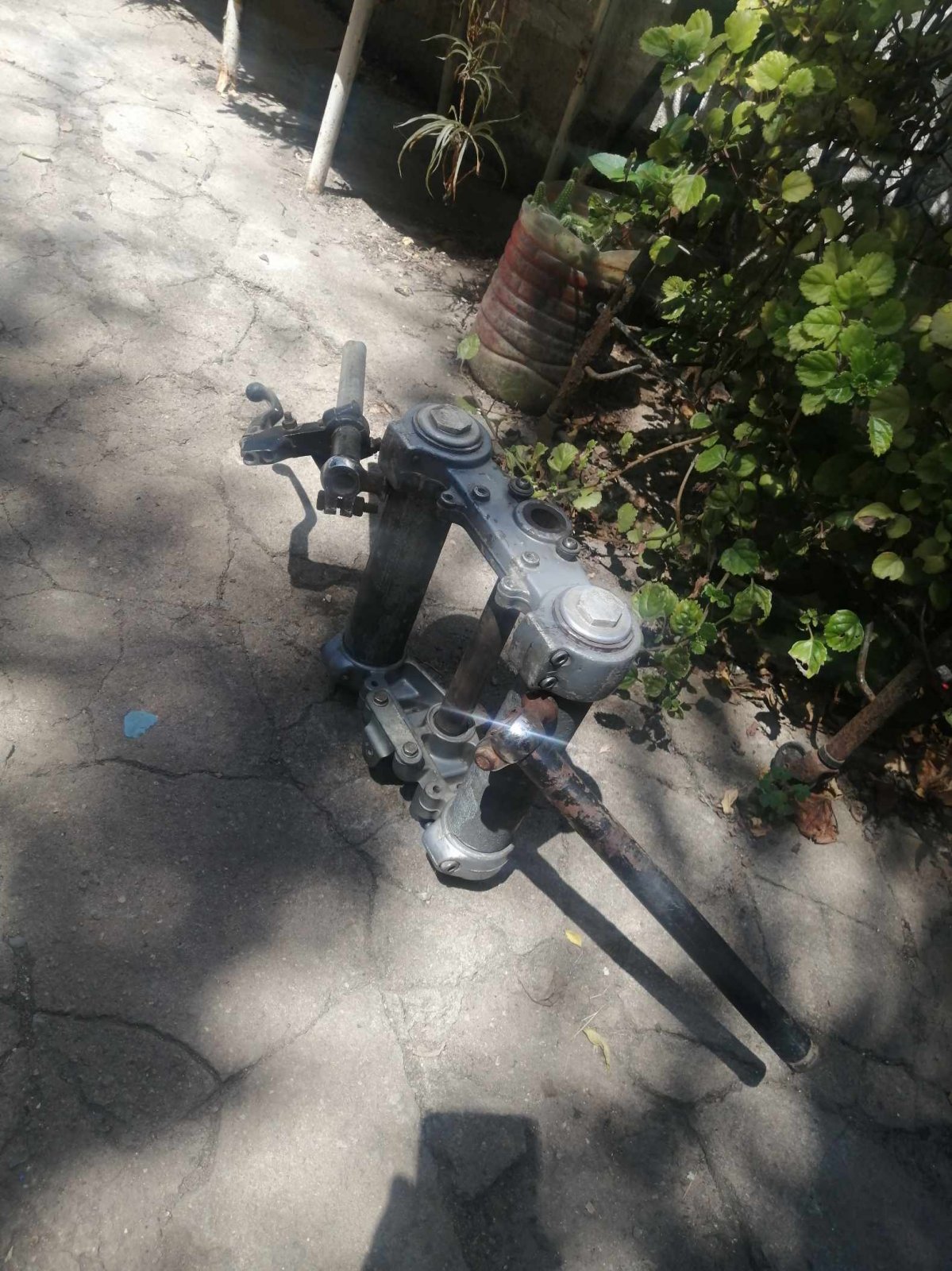

    The chassis I will use is from a Yumbo R8 motorcycle.
    The handlebar is an adaptation using a front fork from a Beta RK6 motocross.

    I leave a small video tutorial
    Required program: Arduino 1.8.16 - Download: https://downloads.arduino.cc/arduino-1.8.16-windows.exe
    Components:
    An Arduino Pro Micro Board
    4 1K potentiometers
    Video-tutorial MP4: https://archive.org/download/control-sim/ArduinoControlSim.mp4
    I previously left a wiring diagram and code and Joystick library for Arduino.
    After loading the arduino .io code you must calibrate how a joystick is calibrated - Calibrate the steering (handlebar), accelerator, brake and clutch. And now you can test the potentiometers in a game, I created it for GP-Bikes. It also works for car simulators.

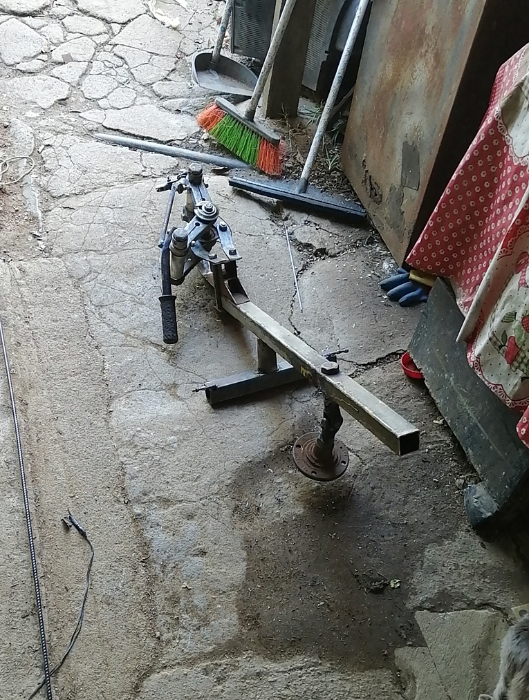

    New design
